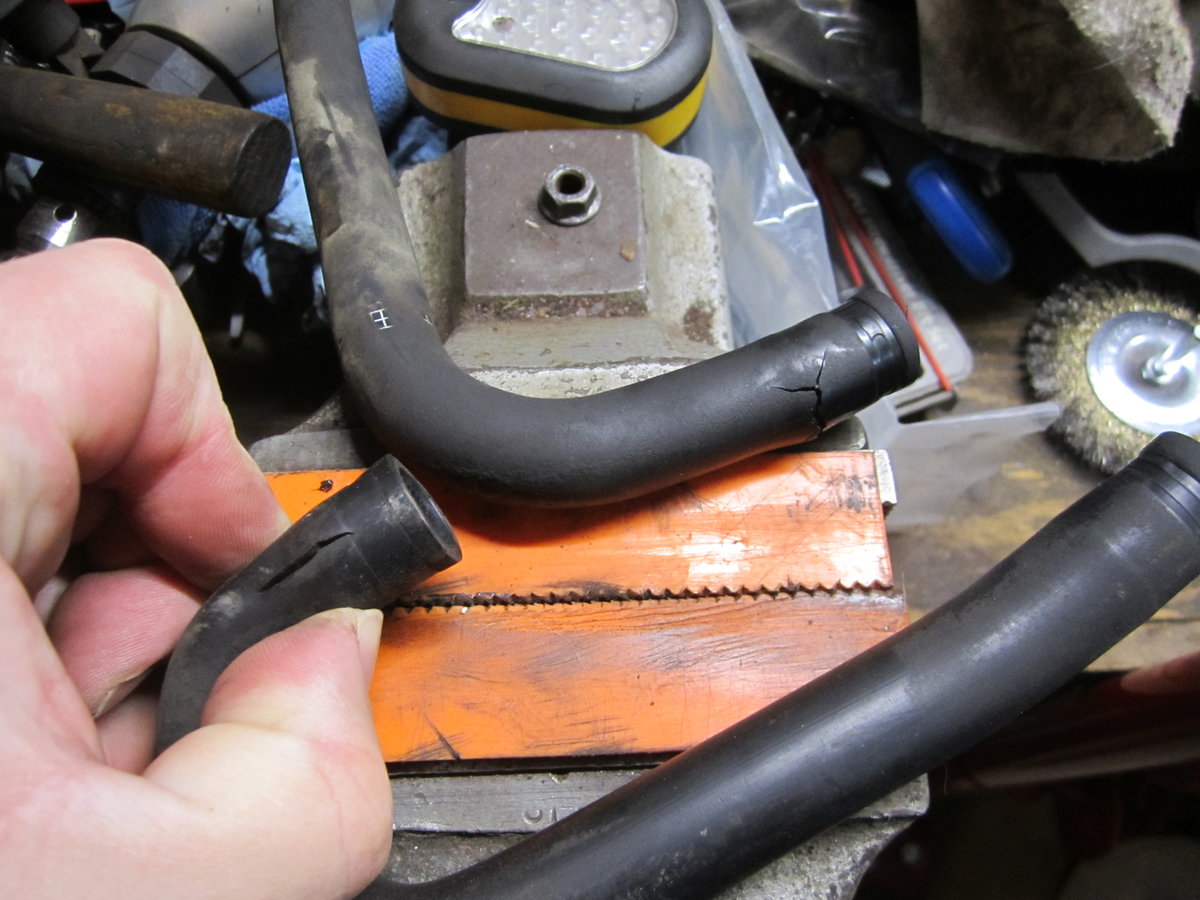

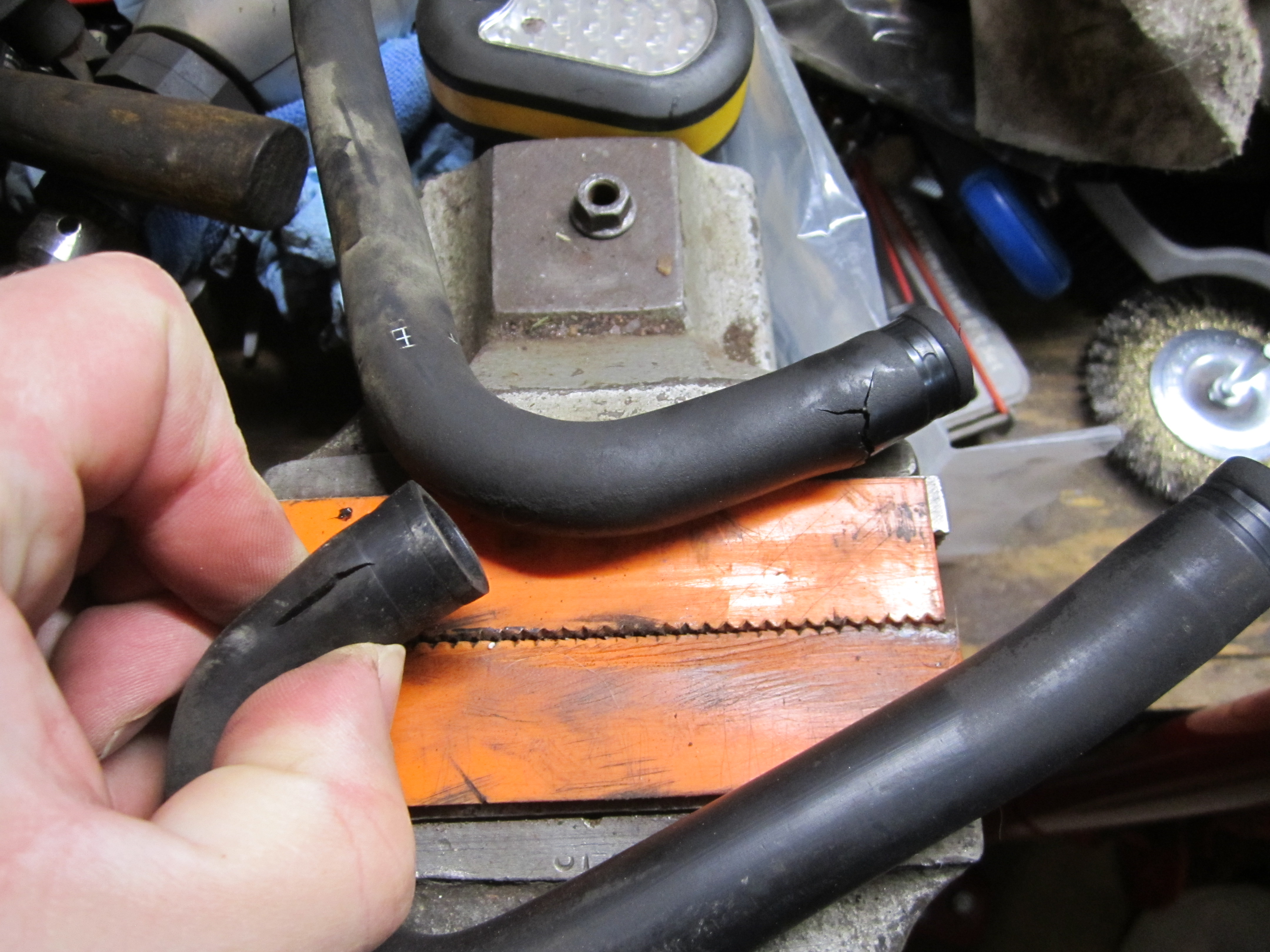

Nope, that looks like the roll over valve. I believe the 'good' hose is the 'J' hose going to the carbon canister, and the split one is the pipe that runs up to the breather filter attached on the top of the fuel filler pipe.

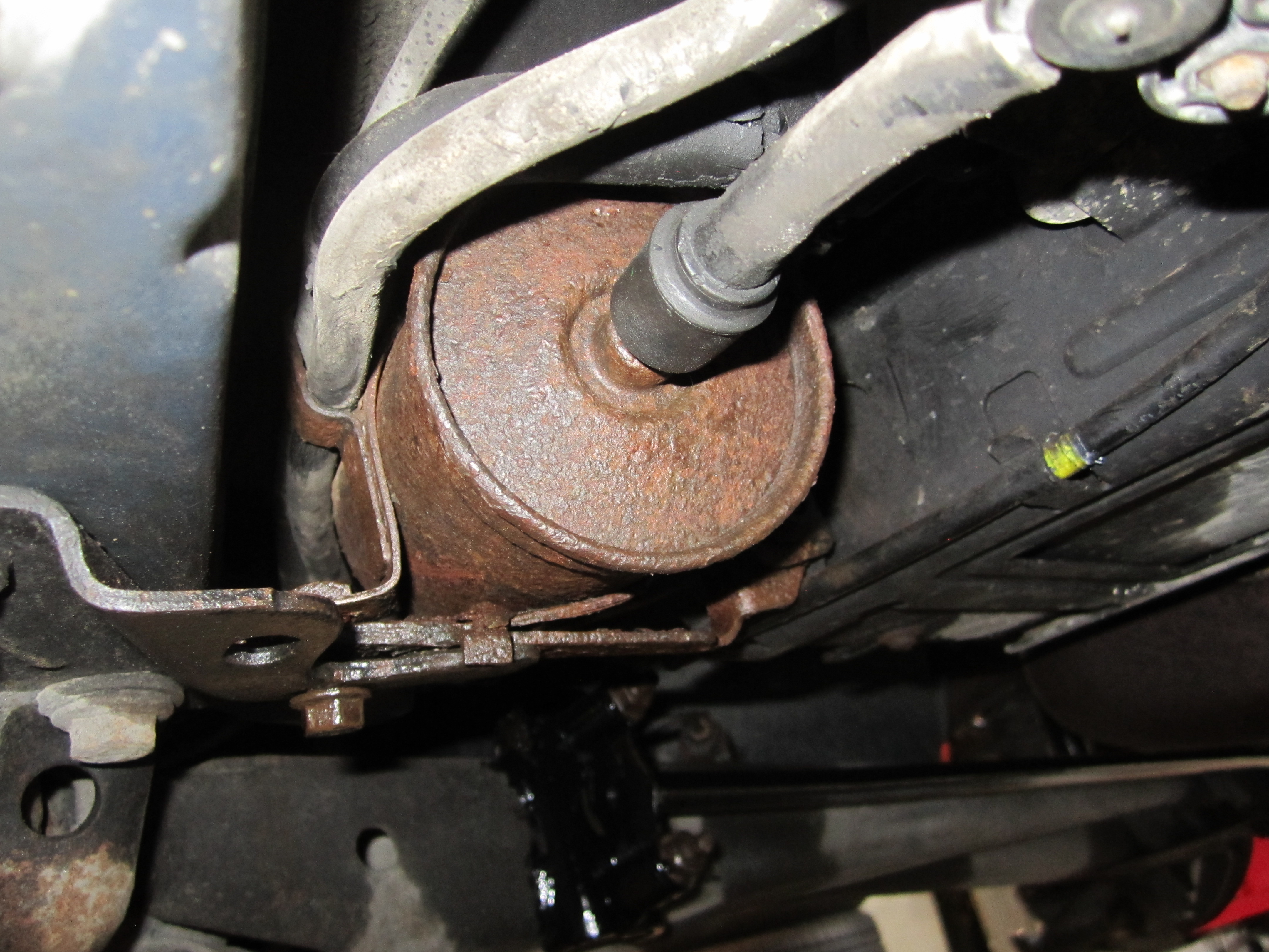

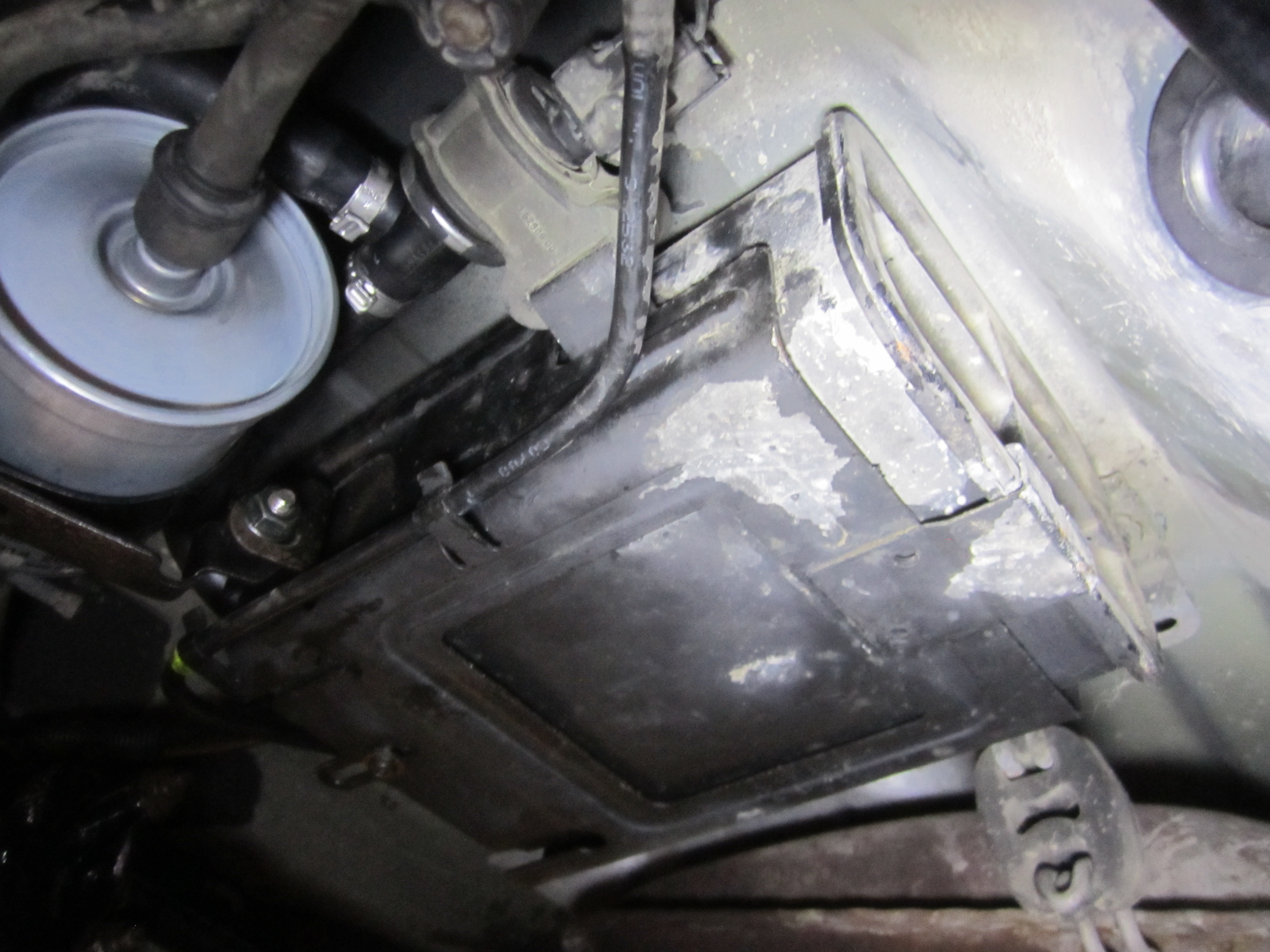

Fuel filter looks old, but no where as bad as the one on my V70 project was!
New catalytic converter

Yes, you just found one of your evap leaks. Note the plural.
That could fix it, but there can be others
Blessed are thee in Heaven, who have ME7, forty days and nights shall abet, before your EVAP monitor will reset.
( I'll link to the ME7 evap archive shortly)

Okay I’ll jack up the car today and get a better look.
When I did the fuel filter I used ramps and they weren’t just tall enough for me. Today I’ll drag out the ye old jackstands.
Your fuel filter looks pretty dang old! I bet that sucker was a pain to get off.

Alright, transmission fluid has been changed and the L and J hose have been replaced.
Those hoses were not easy...I was expecting them to be pop on and pop off. I was wrong LOL.
I used heater hose from O’Reilly and had to stretch the ends to make them fit. Once I figured out I could shove the tube on a piece of copper pipe I have then take the torch to it...then let it sit for a few minutes, it wasn’t so bad.
$6 fix including the new hose clamps.
Codes have been reset, now we wait and drive once again!
I gotta say the threads I found on this site on changing the J and L tubes made my life easier!
