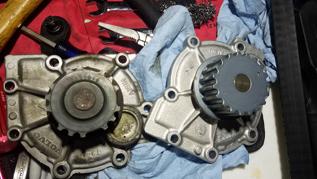

Just finished day 2 of my timing belt/ water pump job. Partially stripped the tensioner pulley bolt but still managed to break it loose without drilling the rail. I bought the aisin pump and tensioner since they are listed as "OE". The tensioner is identical in every way. The water pump has a few differences which leads me to question it's "OE" status. The Volvo pump has an intermittent interruption in gear teeth, where as the aisin one is a complete gear. I cleaned the block surface until shiny using a razor and steel wool. So far that has been the most grueling task. The aisin gasket fit over the guide pins and sat flat against the block with no problems but sticks out a bit around the edges. I hope it doesnt leak. Every thing else for my kit is blue box Volvo. Hoping to get the belt fitted and finished tomorrow.

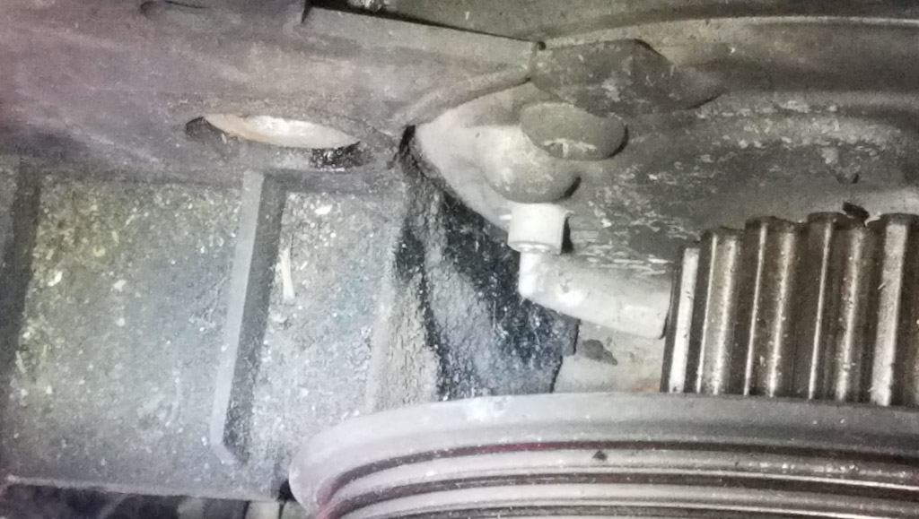

Not sure if this is evidence of leaking I put enough leverage on that rachet to move the whole engine and the bolt was still trying to strip out. Such a poor design, a hex head bolt would dramatically improve the success rate of this job.
