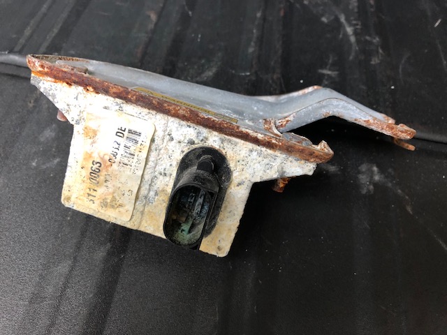

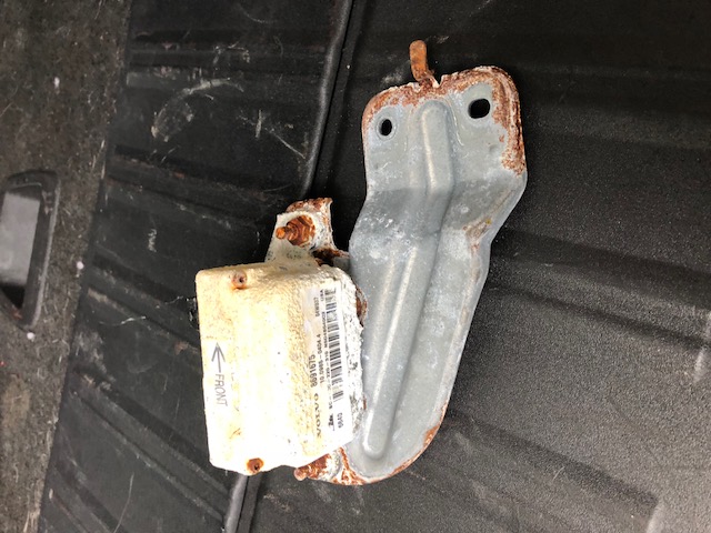

So I replaced the yaw sensor under the passenger seat this weekend. It looks to have been in bad shape with tons of corrosion and oxidation inside the connection terminal as well.
Cleaned plug and replaced with new (used ) unit (FYI, I did this without removing the seat...there is room to work if you unplug the amp and move the rear air ducting aside).
After reconnecting battery I ran my scanner and did the DSTC calibrations. Then tried to read/reset at the DTCs. My unit still cannot connect to the SAS system and I continue to get the "faulty connection" warning.
So, after replacing the clockspring, the TCM at the CEM and now the Yaw sensor I have no luck clearing the anti skid message. in addition, I am now having intermittent dash light/center console extreme dimness and the hi beams won't stay on...
any ideas!?
any ideas!?

In my first post I mentioned that the Yaw sensor should be examined. "Clockspring you did, SAS module (is yours built into the clock spring) and then steering wheel module. Next is the yaw sensor (known to get wet and go bad - disconnect yours and examine for water damage) - then the DEM which could be the actual DEM module, pump, temp/pressure sensor or solenoid, but could be entire Haledex piece."
At this point I would go back to the yaw sensor harness and make sure the fixed harness side side does not have internal connection corrsion. It will not be easy - a small pin in every contact repeatedly. Then spray with electrical connection cleaner and maybe use some dielectric grease. This is the problem I had with my steering module connector as mentioned. Concern is making the numerous connection sockets too wide that they loose contact. Use a small pin - maybe if you have an old school carb cleaner jet cleaner set you can find the right side with some barbs on it.
That yaw sensor does look bad. Did you clean out your sunroof drains and other drains?

Pull the wiring diagrams and check all the connectors and wire runs.
For the carpet, look for a replacement carpet, I see them from time to time on Craigslist for under $50. If you find one, pull the entire piece out and do a good examination of the wiring while you are there.
Most of the time your problem is the yaw sensor due to water intrusion.
