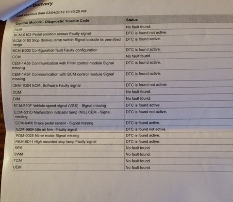

Today was the dealer trip! And it seems we have success! Quite a reasonable cost too of NZ$290. Here is the printout of the codes before programming

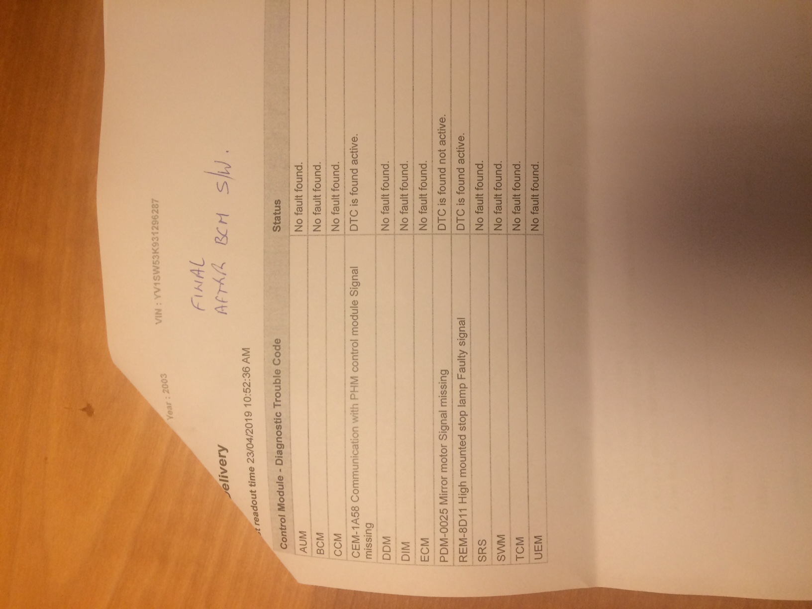

And after
The door module fault and high stop fault didn’t clear but both the associated mirror and high stop work fine so I’m happy. The PHM fault is because I removed the phone keypad.

That high mount stop lamp's a pretty common (false) fault on the early P2s
Glad it's sorted for you.
