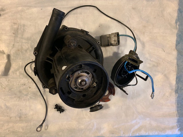

The wires and connectors assembly can be separated from the motor with relative ease and moved over.

VW part number 021 959 253C will work.wizechatmgr wrote: 04 May 2019, 18:33 Believe '99 Jetta's have this too. Not sure which you'll find more of in the junk yard.
VW 021 959 253B and 037 959 253A are similar and would probably work
VW to Volvo SAS pump conversion tutorial.
