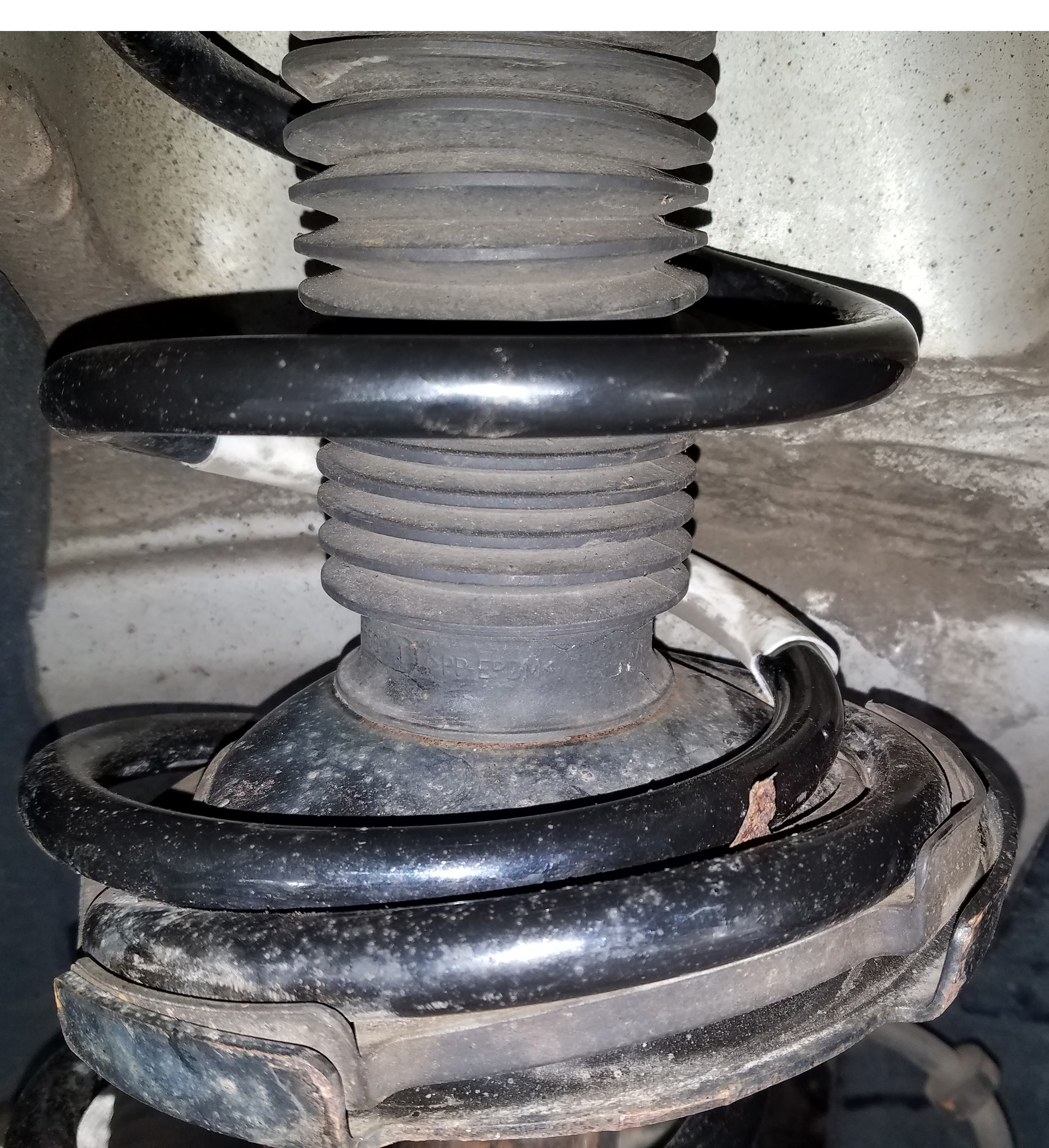

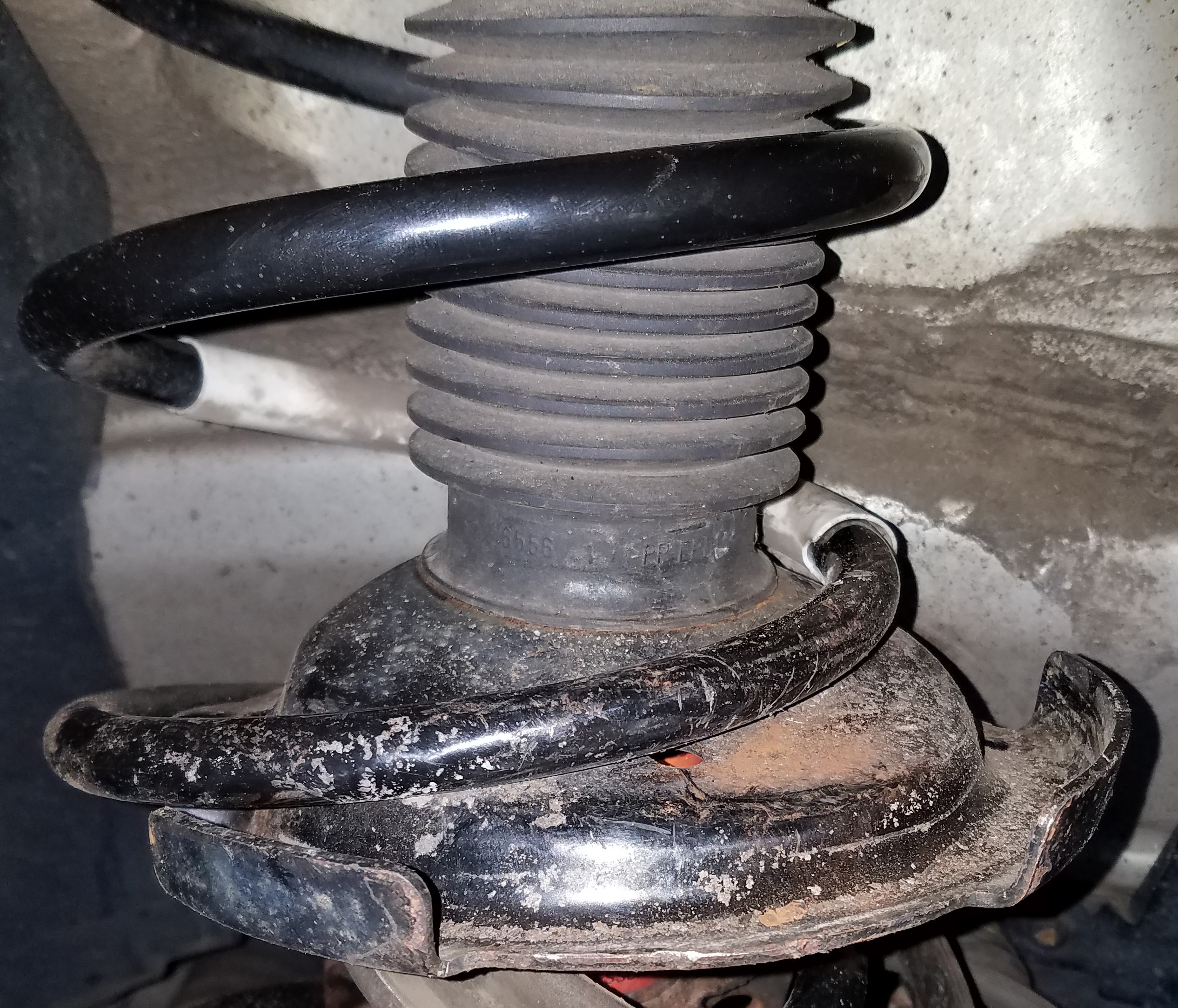

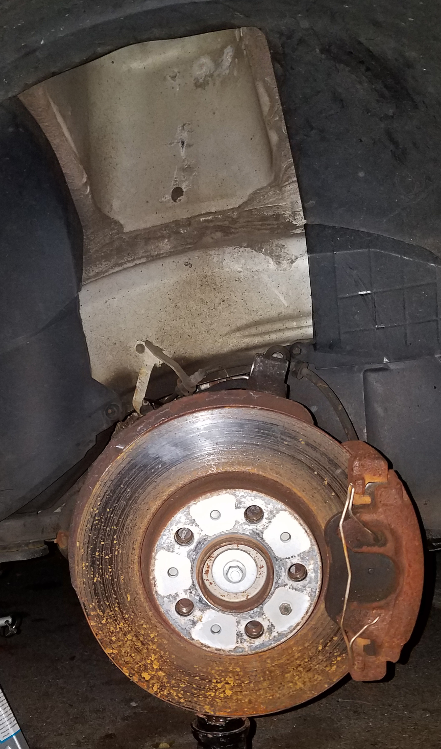

After viewing on jack stands I see that the spring broke near the perch. The upper portion slid around the perch with one loop now resting on the wheel. The next lower loop barely overlaps the knuckle. I don't think it will hold if the wheel is removed meaning the spring would descend toward the abs connector, brake line and CV boot. The sway bar link separated at its upper fitting presumably as a result of (not the cause of) the broken spring.
The spring does not reach the upper seat with the car on jack stands. However, there is still significant downward tension on the wheel as the upper region of the spring is pinned against the wheel well by the abnormal geometry. I am concerned that removing the wheel as is might result in the spring descending further under tension and damage the abs connector, brake line and/or perhaps CV boot.

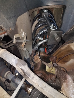

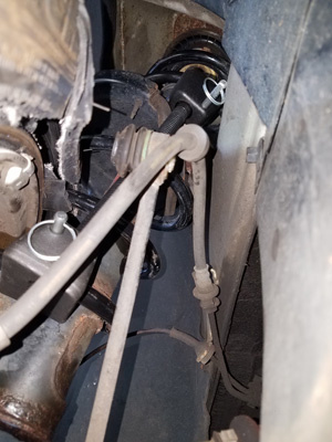

I fit and gently tightened a spring compressor as in the photos here hoping this approach might relieve the tension and allow disassembling the entire structure without further damage.
Before proceeding I would like to know if mvs readers think the spring compressor might work, think this is a really bad idea or have other suggestions. The upper safety pin on the front compressor bar is blocked by the broken spring and cannot engage.
Thanks in advance for any help.

I think it would be best if possible to clamp the top and bottom of the broken spring only.
EDIT: Clamp the lower broken "lower" spring.

Currently the spring compressor might feel solid because the top of the mount is still stable in the car chassis along with the 2 bolts in the steering knuckle. Once separated the two springs will go whichever way it is sprung.
Remove the ABS sensor off the bracket and loosen all the lug nuts but don't remove any. As all the lug nuts begin to go further out see how much tension there is as the rim comes off the hub. If it is really tight just readjust the compressors accordingly, meaning on the lower broken piece only as the top looks like it is unloaded already.
- Posts: 36137
- Been thanked: 4063 times
Get the caliper off and swing the ABS, brake hose, and axle out of the way. You could also protect the CV boot with a piece of lumber.
Then get that busted strut out

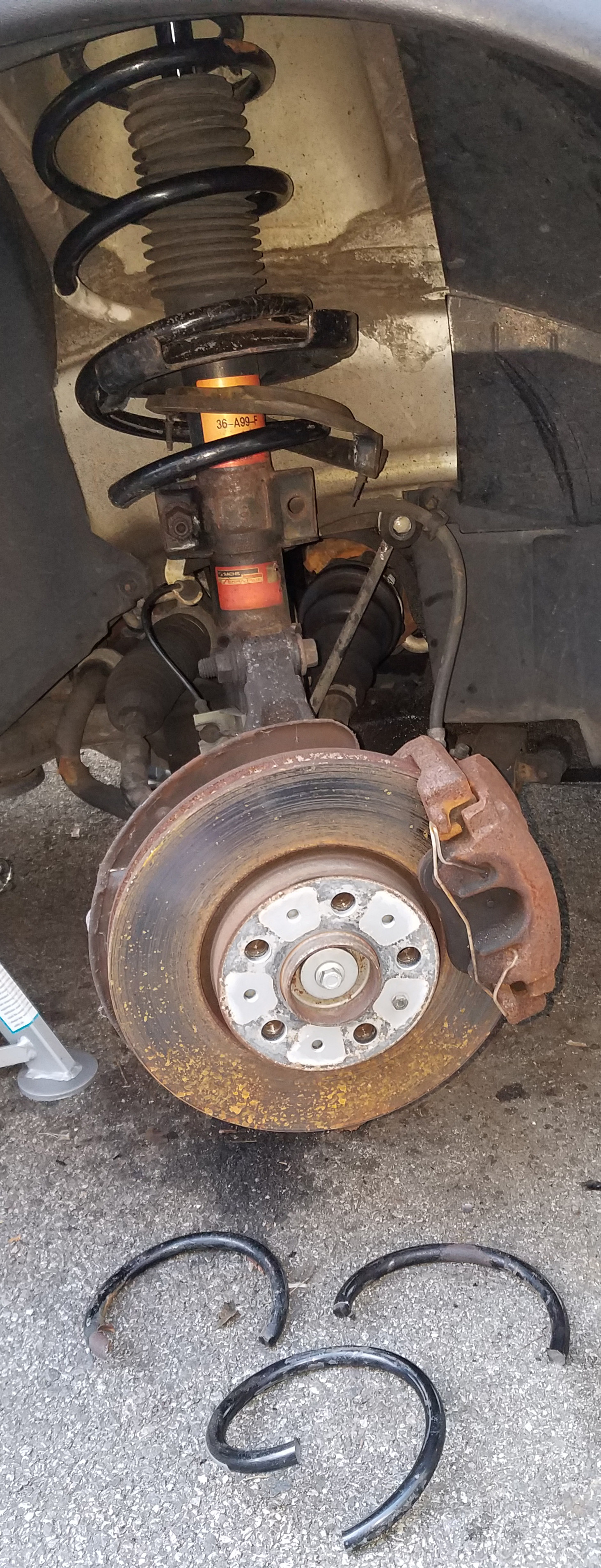

Compressing the spring freed the wheel that then come off easily. The broken distal piece of spring was restricting movement of the proximal portion as the latter passed (abnormally) over the perch. They were pinned tightly together creating lots of conflicts and lateral displacement up and down the spring. The photo illustrates the abrasions from the spring rubbing against the surround of the upper strut tower. Also, after raising the car the spring was stretched (not compressed) between the perch above and the bracket for the sway bar link below. Took a while for me to realize this. After I pried the broken distal piece of spring out of the perch everything else began to free up as I pushed and pulled in various directions. When there was little remaining tension I cut the spring into pieces using an angle grinder and removed the strut tower. Finally. I think installing new on this side and replacing the other side should be straightforward.
And perhaps also time for some brake work.
Regarding the quick strut solution: When I replaced a rear spring in this same XC70 matching the specific spring to the vehicle (suspension?) was important. If the same is true for the front, then how can a single quick strut be appropriate for all XC70 vehicles? They must be made using a spring with a single set of specifications.

That flash rust on the brakes isn’t bad, that is from sitting still on wet days. How much pad thickness is left?

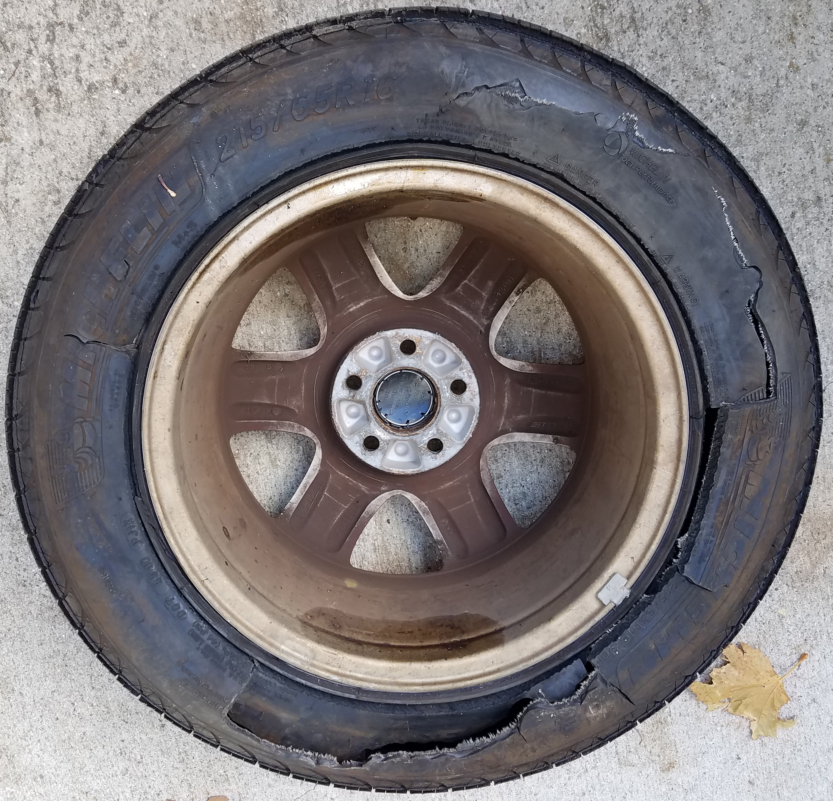

Replaced spring and bumpstock since I already had everything taken apart to remove the broken spring and the other parts "looked" OK. I realize other components may or may not need replacing soon. Now I know what to do.
Car runs fine after a new tire and reassembly. Even passed safety/emissions inspection. Except for one thing. A noise that was present before replacing the spring is now much louder.
