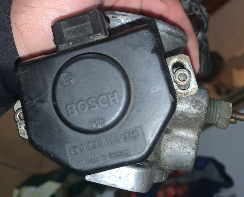

Hi RIck, the problem is that my inyection model is a LH 2.4, not the LH 3.1.
My old piece TPS it is a 0 280 120 316 it is the big one.

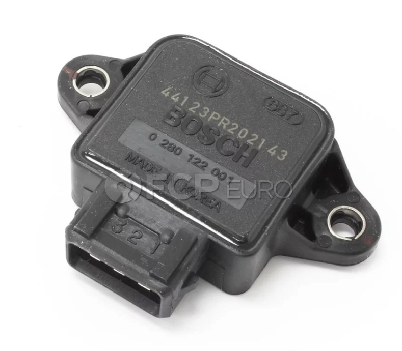

This is the new TPS, and this only fits in LH 3.1

The problem is that my reference is not correct, I explain, the number 0280 120 316 is a Opel, BMW ... and another car model, but not Volvo. I am sure that my TPS for LH 2.4 models is a 0 280 120 325 and it is very expensive the OEM ...
Can you look at me if I'm wrong? Thank you.

Im collapsed, i just call to the bosh shop and they tell me , with my VIN number that's the original for my car its Bosch 0 280 120 301...

Another thing I've noticed is that if I turn the car off and turn it on, many times the car goes better. The other day I went to buy and it was failing me, I made small cuts that prevented its operation, I stopped, I turned it off and it was going much better, almost perfect ...

From what I gather Both Bosch 0280120301 & 0280120325 will work with LH 2.4. Must likely the 305 is a upgrade to the 301.
Seeing a Bosch 0280120301 on the US eBay site for US $112.52 + $23.80 shipping to Spain. Bosch 0280120325 for $24.99 + US $29.99 shipping to Spain.
You might be able to find a better deal on eBay Spain or one of the other European eBay sites. However searching on one will show you the same items on others. From the US EBay we can also see the same item on the English language sites ... eBay UK.
Search by Bosh part numbers. Volvo is not the only one that used these Bosch throttle position sensors.
