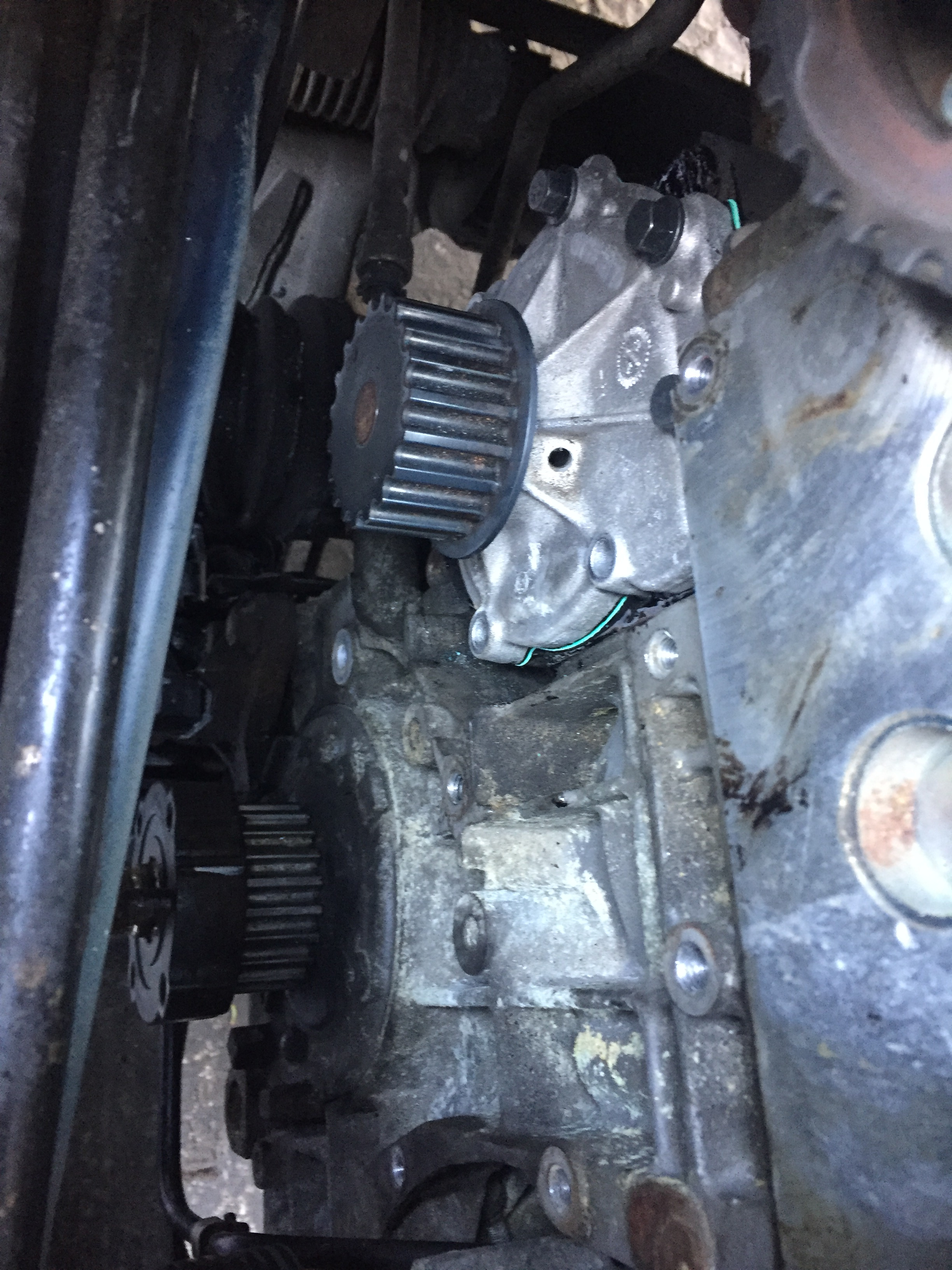

You have to put the rear timing belt cover on before you install the water pump
Time lost, 15 minutes
Humility gained, considerably more
