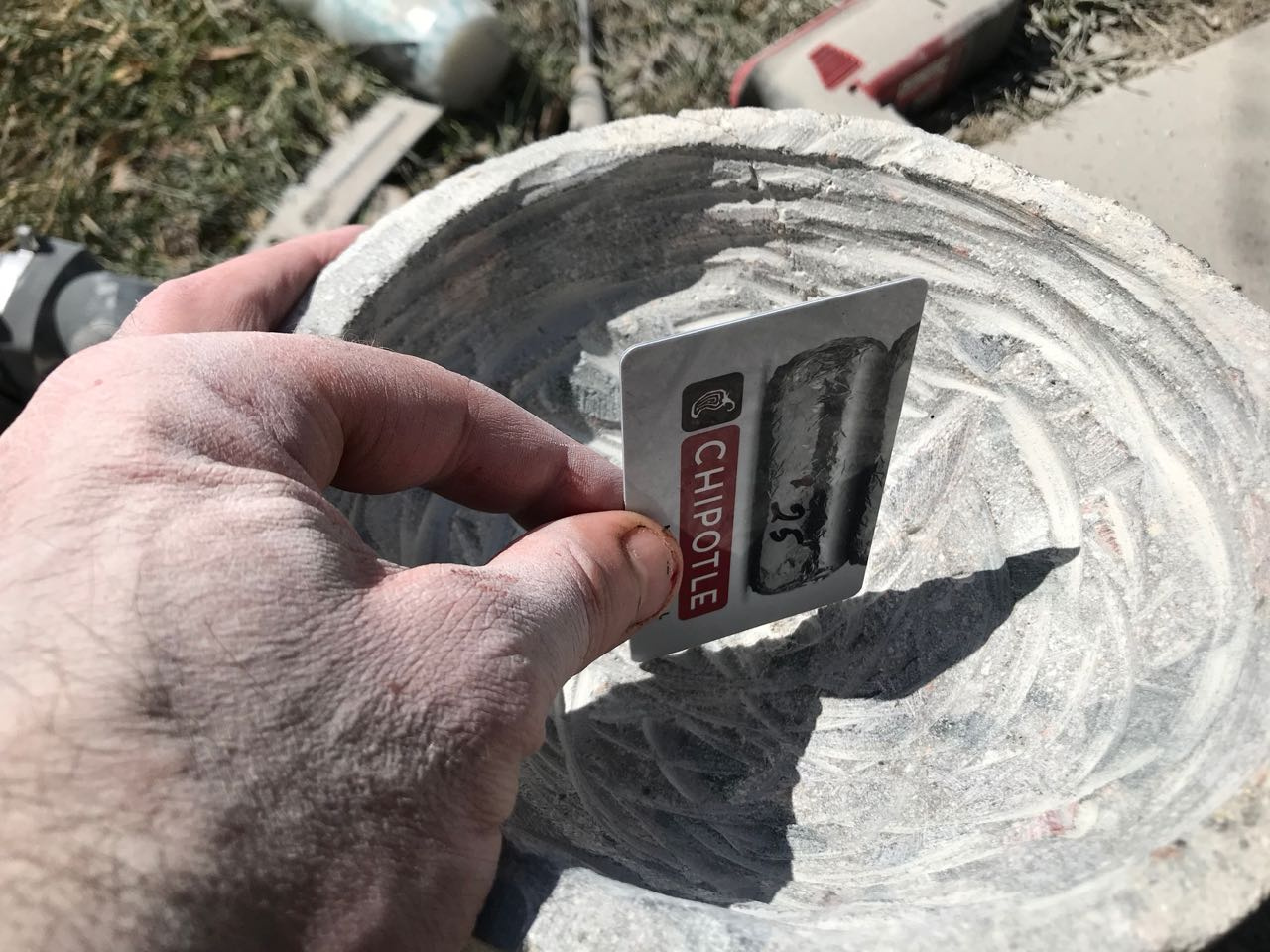

Anyone have any concrete grinding tips?

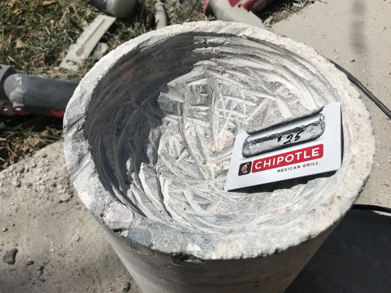

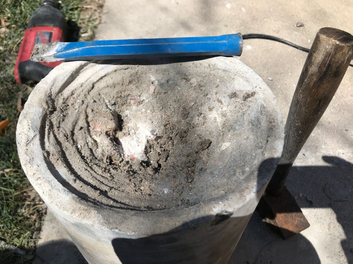

The cement its self isn't so bad; it's the aggregate / rocks that can stop you cold. On occasions I have had to drop a steel punch into the hole and wack it with a hammer in order to crack a piece of rock. Then back to hammer drilling.

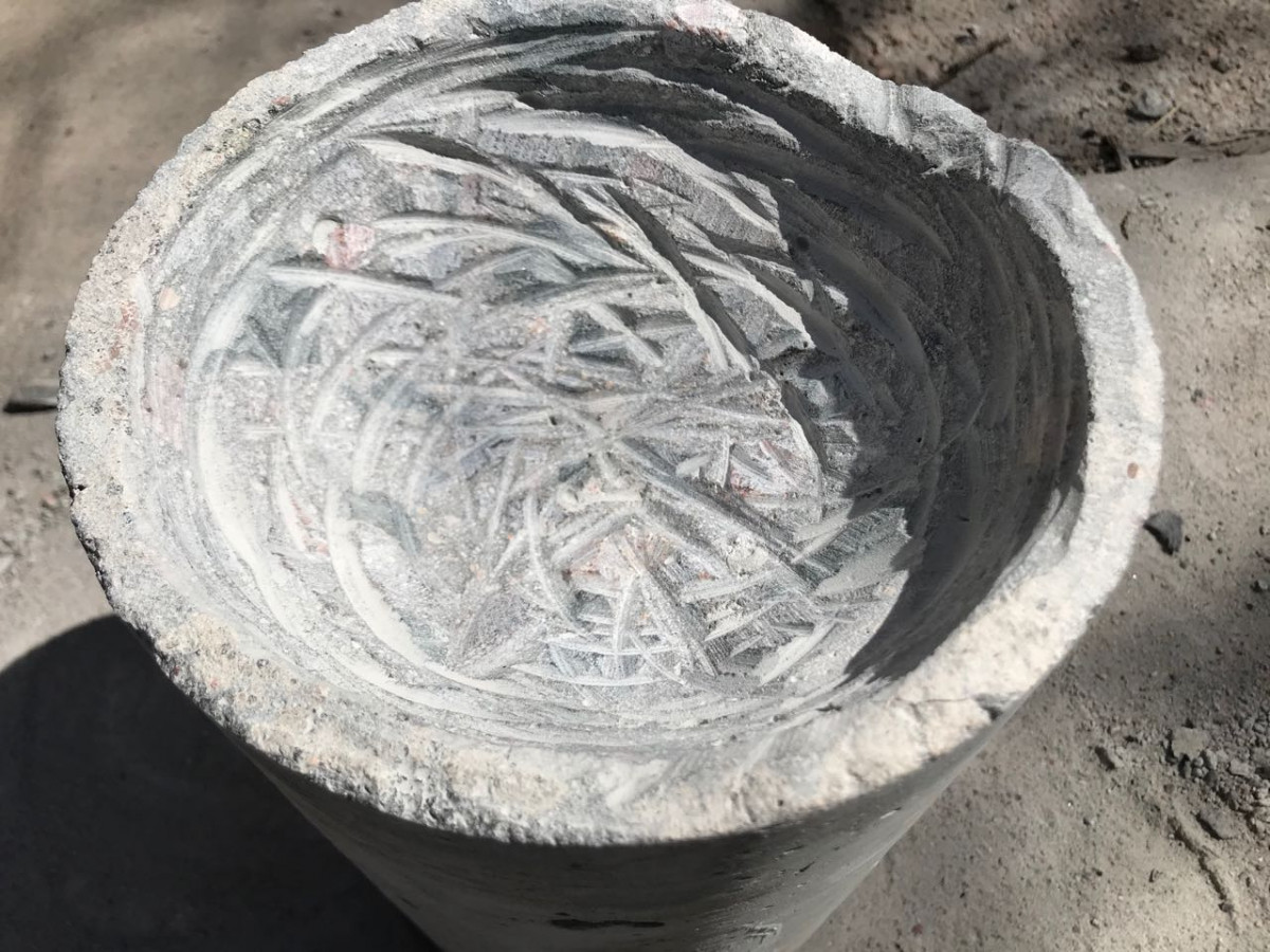

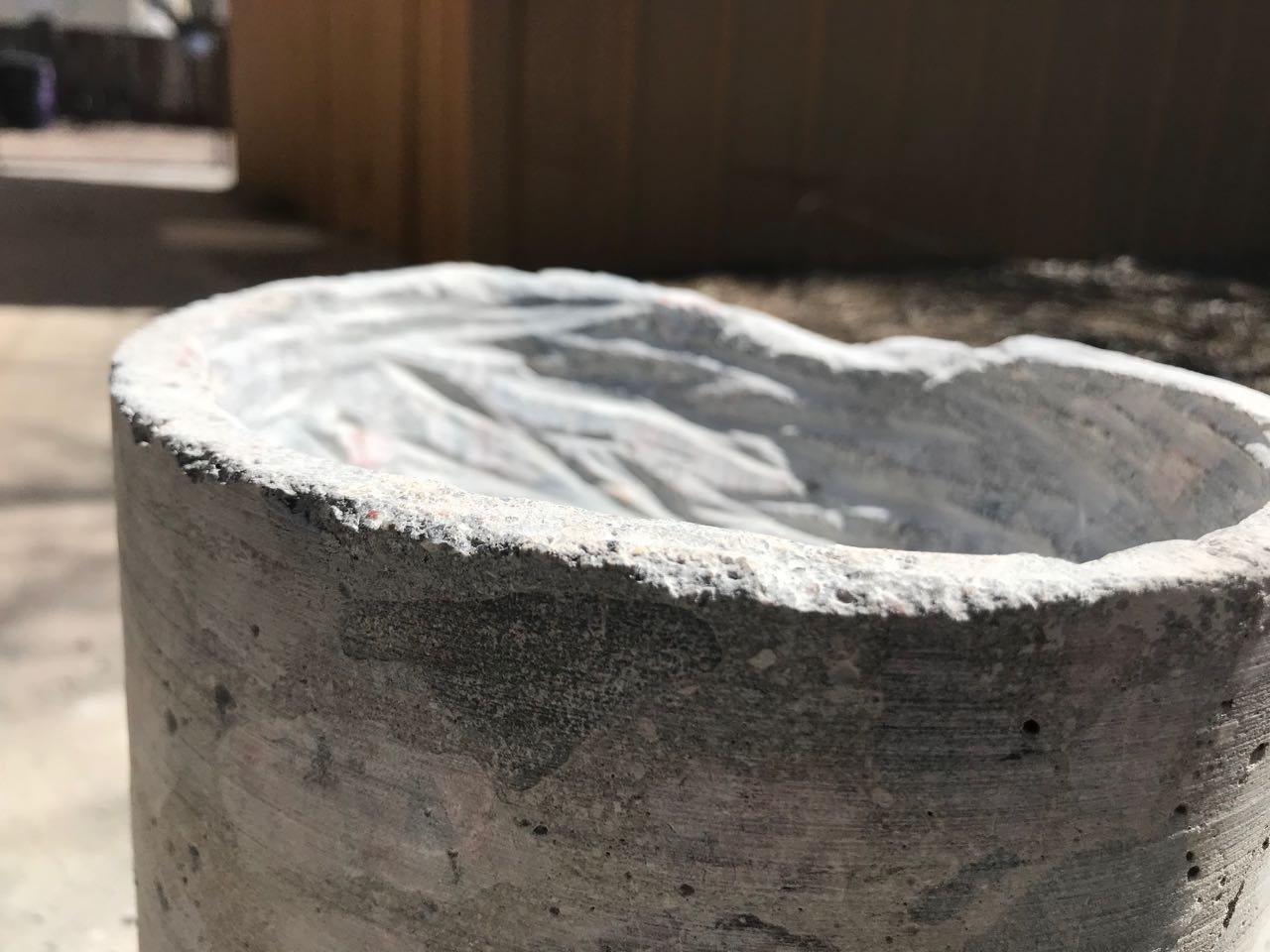

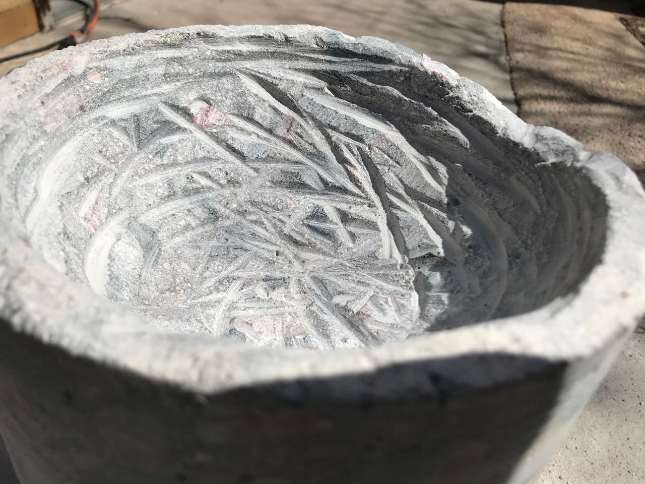

Anyway, the chisel and hammer drill were good suggestions... many thanks to Sveedy. I was able to break some rocks and make good vertical progress today.
I think I'm done. The height x diameter is beginning to rear its head on how far I can go down with the grinding wheel.
It's not suitable for anything but small-medium plants, which is fine.

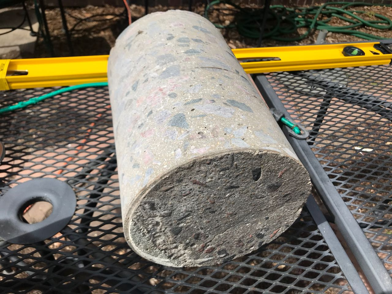

It's not a bollard. I think they were coring to make holes for new traffic lights. This was one of three I grabbed that they left on the sidewalk.
After doing all this work, I can appreciate the power and durability of whatever they use to get these holes cut. The machines must be incredibly powerful and heavy.

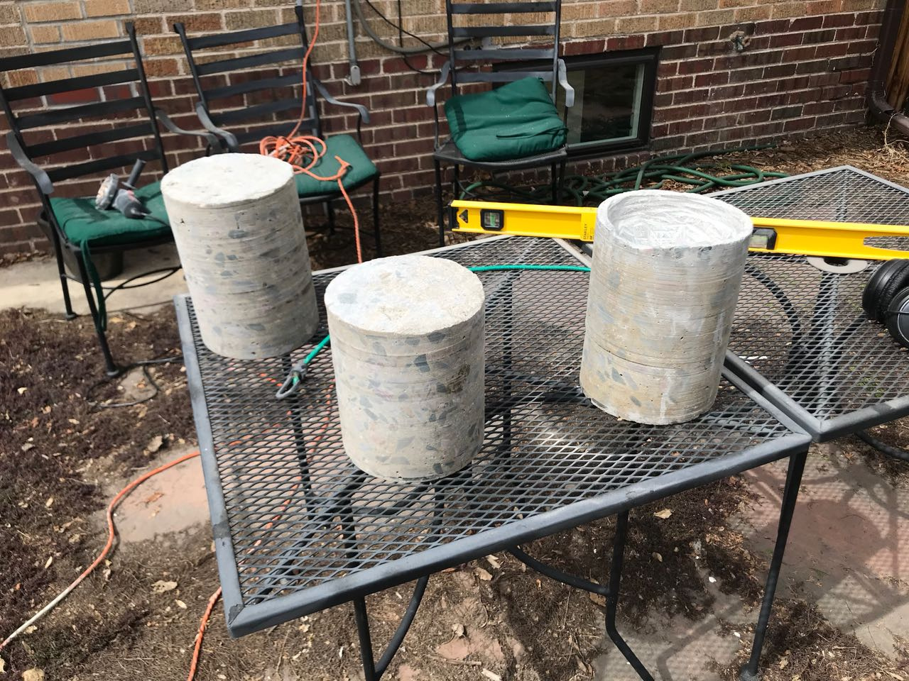

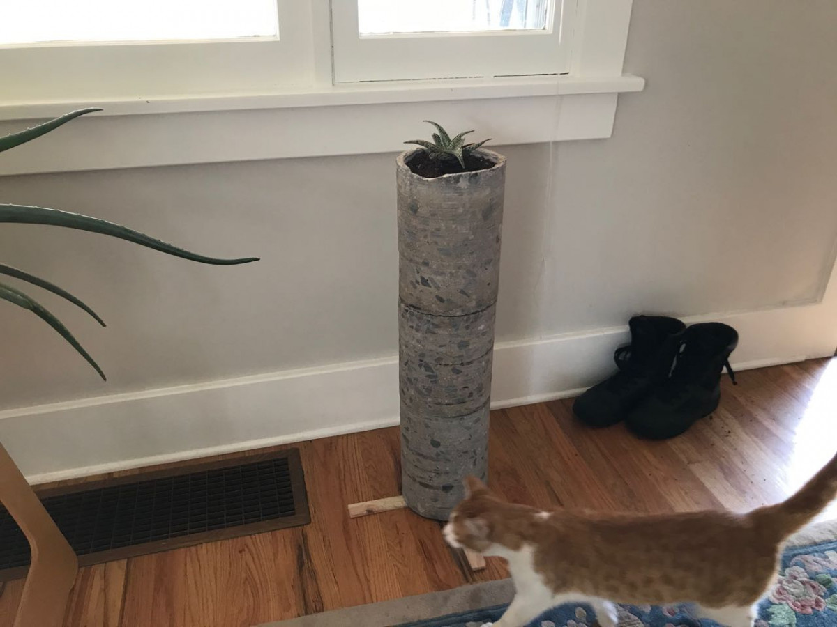

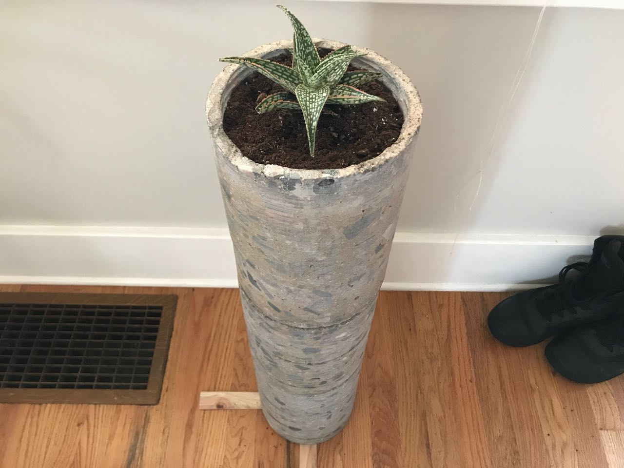

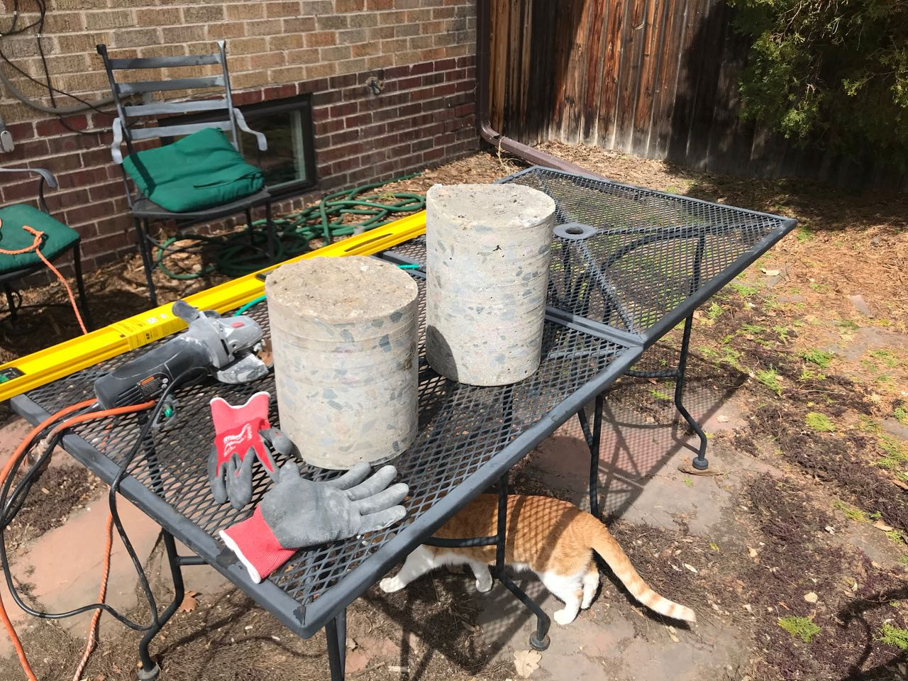

Anyway, here's today's work. I think I'm done for now. I planed the other two.
I just realized I made a 120-lbs planter for a 2-oz plant.
