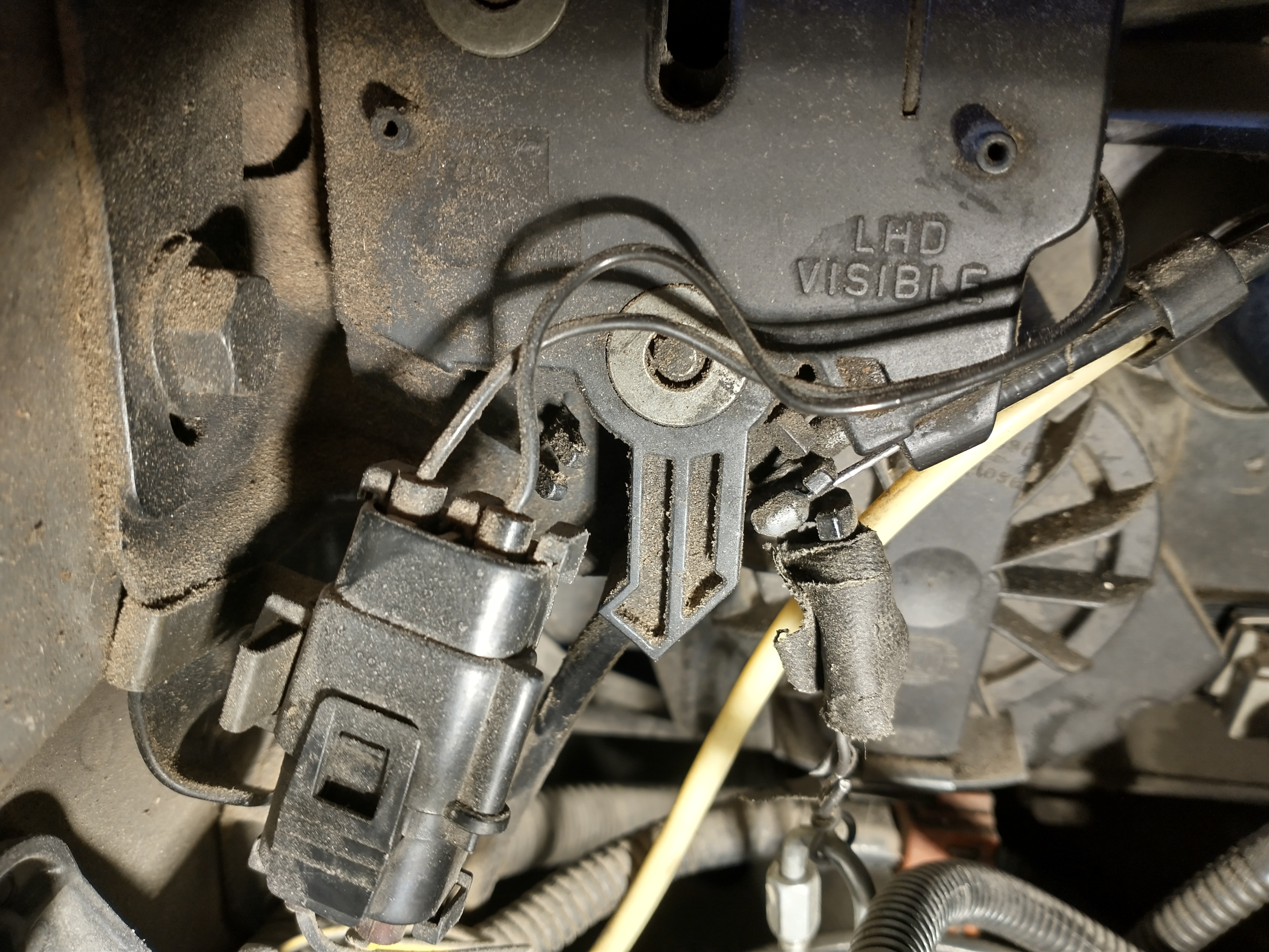

Ok let me try this again;
I do not pull on any cable or wire to trip the latch. I just push that tab that you are pointing at with the green arrow. I think your cable hooks into that notch on that very tab, though I do not see the cable in your pic. I wrapped that tab w/ tape so it was easier to push with my thumb. I will go and look at my set up in a bit and will post another pic if needed. But just try playing with the mechanism a little, and you should see how it works.

Ok thanks. Yes i did not put any wire on anything yet i just got those pics from my car repair archive i took those pics a long time ago. I modified them a little with the clearer green arrow so i could ask exactly if that was the right place to connect the wire or not.Sveedy wrote: 03 Dec 2021, 07:56 Ok let me try this again;
I'll try playing with it, but if you could lastly tell me if you push that tab to the right, left, up, or down to open the latch.

Yes those are the holes/eyelets I was referring to. The existing hood release cable does not hook into that circle/notch/eyelet. Nothing hooks into it, as clearly shown in your pictures. The eyelet is free and unused and can easily accept a cable.
The tab needs to move toward the center of the car. You can use Sveedy's method and reach up and push it toward the center. Or you can route a longer cable and pull it from down below. I have my 98 V70 set up this way and it works really well.
The cardboard piece goes between the upper edge of the headlight and the hood. Pull the cable lever in the cabin to release one side of the hood, wedge the cardboard in between the upper edge of the headlight and the hood on the stuck side, pull the lever again, the stuck side pops free.

Hey thanks a lot really. Now i am pretty sure i know exactly what to do.erikv11 wrote: 04 Dec 2021, 00:23 Yes those are the holes/eyelets I was referring to. The existing hood release cable does not hook into that circle/notch/eyelet. Nothing hooks into it, as clearly shown in your pictures. The eyelet is free and unused and can easily accept a cable.
So both latches would pull in toward the center. That might make it even easier.

On my latch there is a cable in that notch. And you push the tab toward the outside of the car. if your standing in front of the car, the tab pushes toward your right ( drivers side wheel ). At least that's how mine works.
I think the cable that is hooked in that notch activates the passengers side latch.
