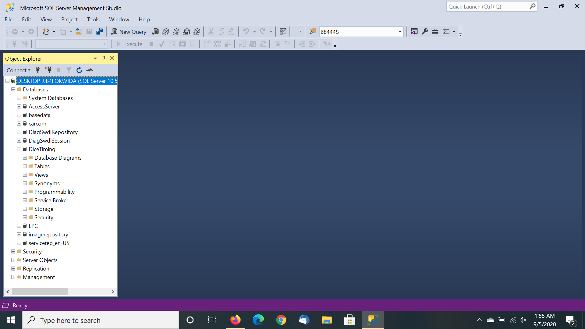

I can get access to the Vida database with Microsoft SQL Server Management Studio V18.5.1 but I have no idea what to do.

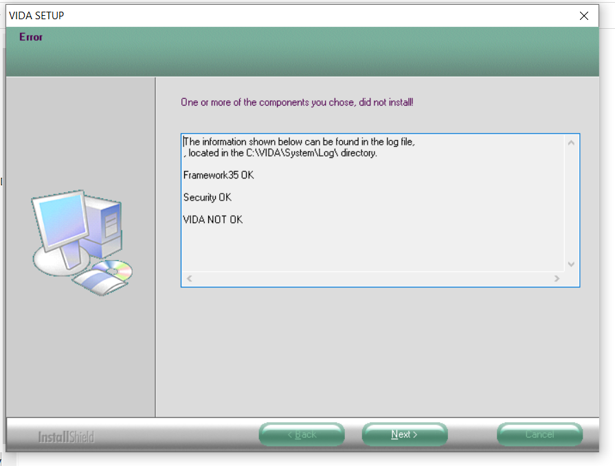

I'm following all directions as I can find them, using the Repack (I'm on Windows 10 Home) but running scripts #2 I get the following issue. I found a couple sites describing the same issue, but nothing of substance to resolve it. Any ideas? Thank you.

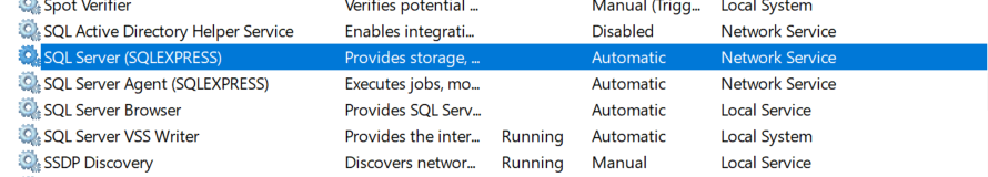

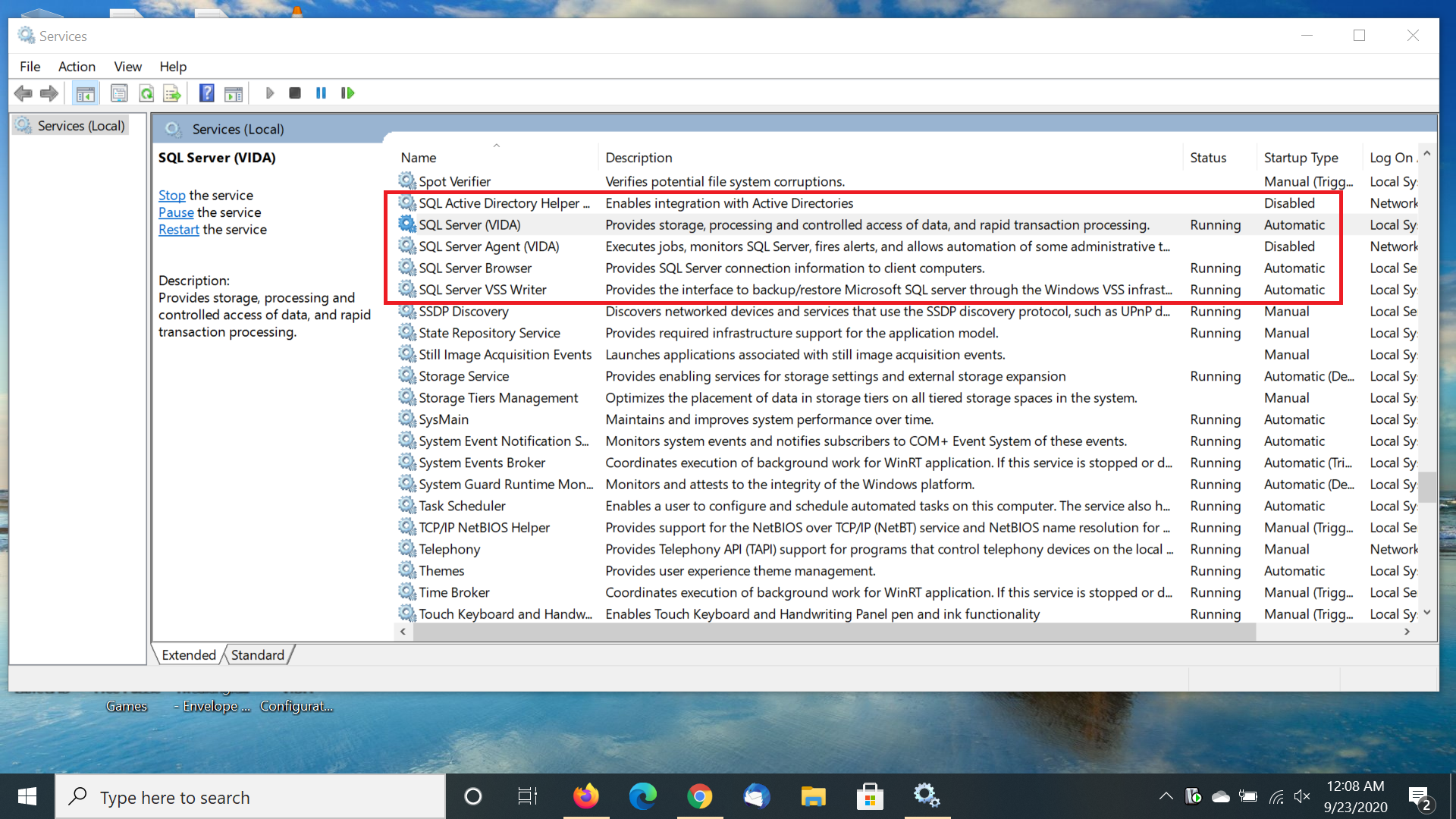

ecbsykes wrote: 21 Sep 2020, 14:32 Any ideas? Thank you.
Go to Windows services and make sure SQL Server and SQL Server Browser are set to automatic.

This is what I'm showing. The VIDA installation (script #2) still seems to finish super quickly and says "VIDA NOT OK". I'm not supposed to just continue with the scripts/patch at this point right?
