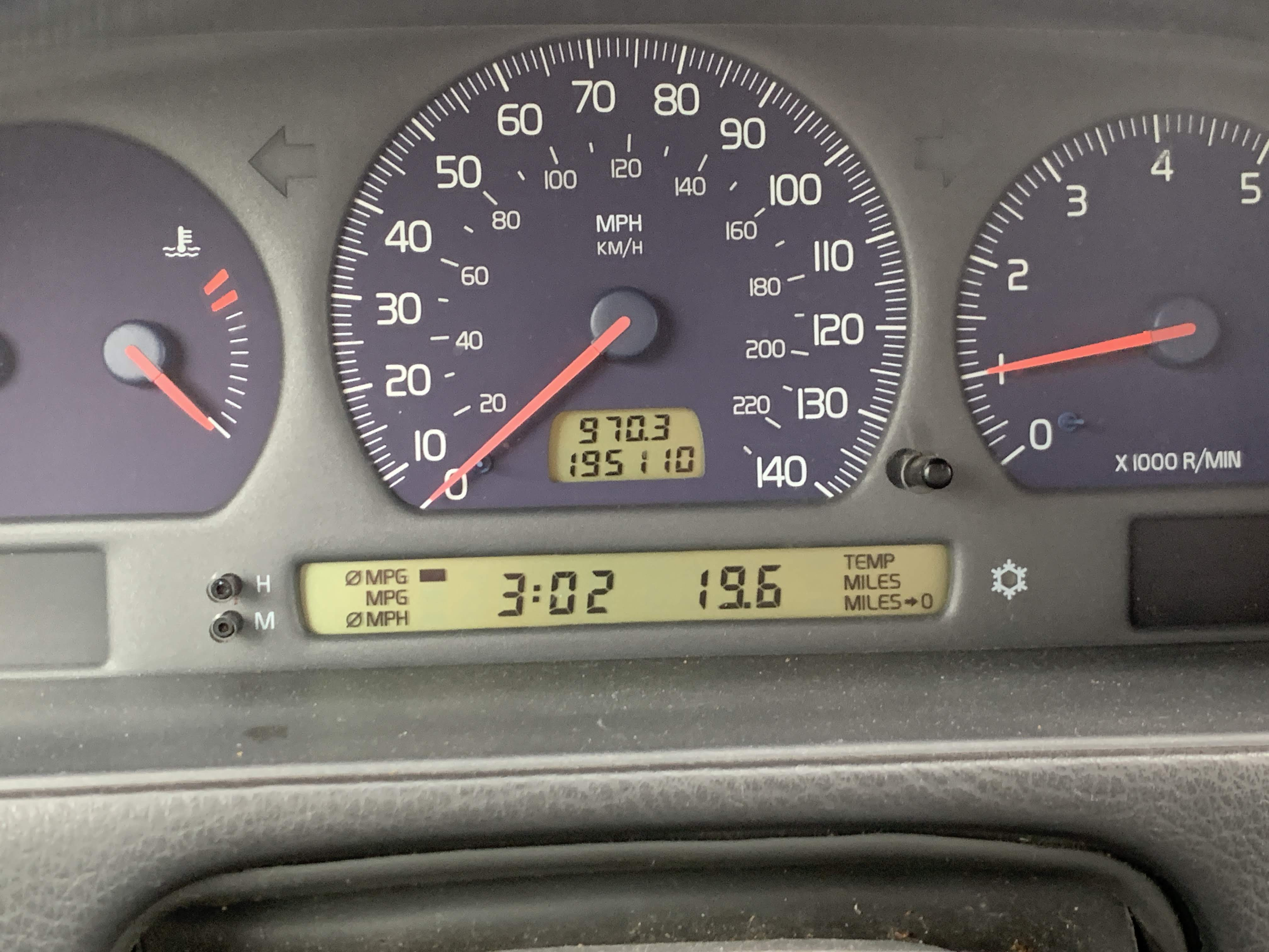

All the highway driving I've done lately has paid off... I've hit a record high MPG in my R!

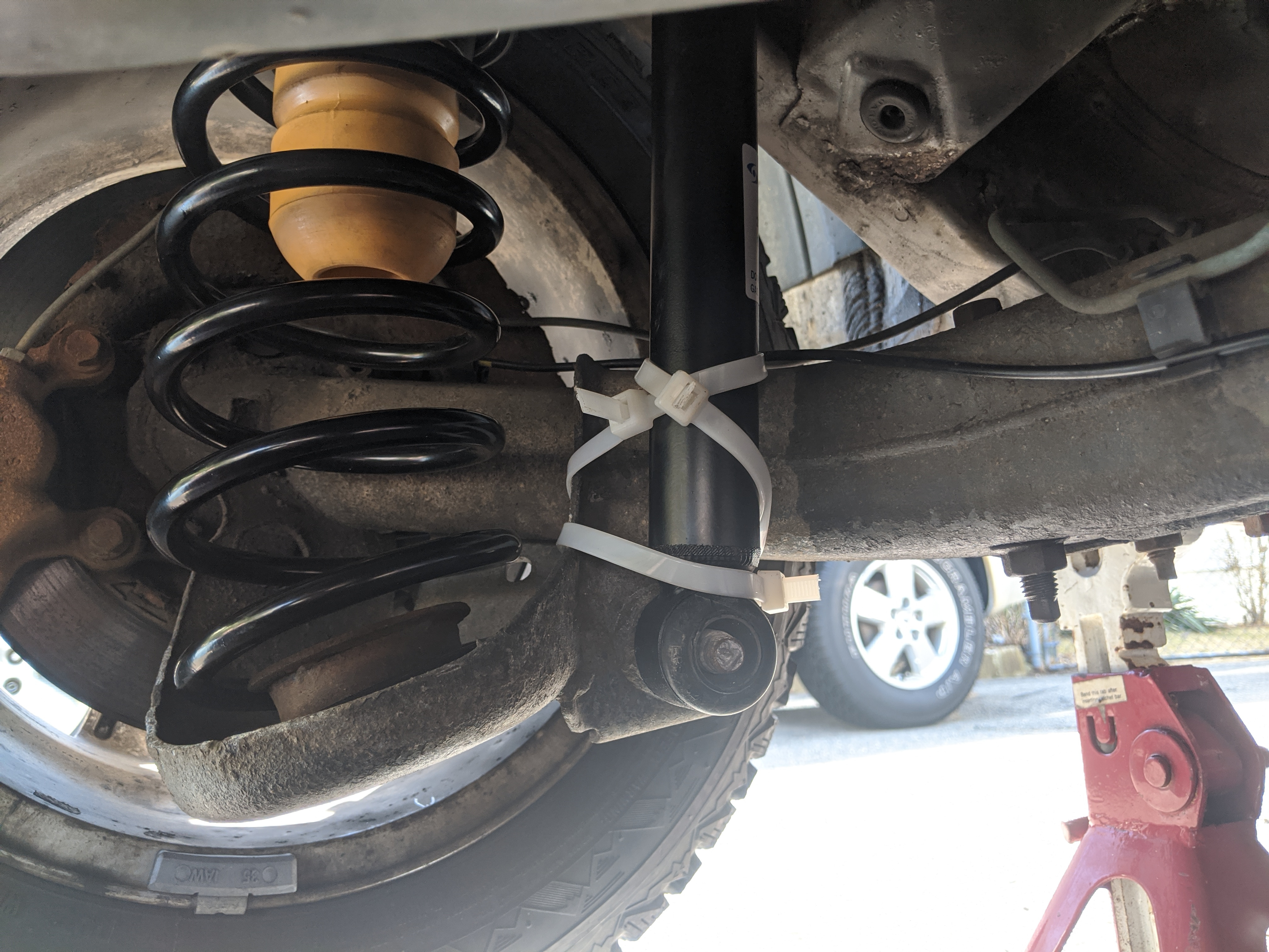

I replaced rear springs, bump stops, shocks and shock mounts. I'm glad i splurged for the springs as i found my back right spring was snapped at the top, just inside the spring seat. Unfortunately, in the process i broke the bolt that holds the drivers side strut on which was a very sad moment for me. As for right now it's held on with a bunch of the biggest zip ties I've ever seen (photo of when I was about halfway through adding zipties), and my plan is to have someone weld something on the end to hold it on. If its more than $100 I'll consider sourcing a new trailing arm I guess.

Maybe it’s just the picture, but what’s going on with the spring? It looks like it’s taking an aggressive bend.

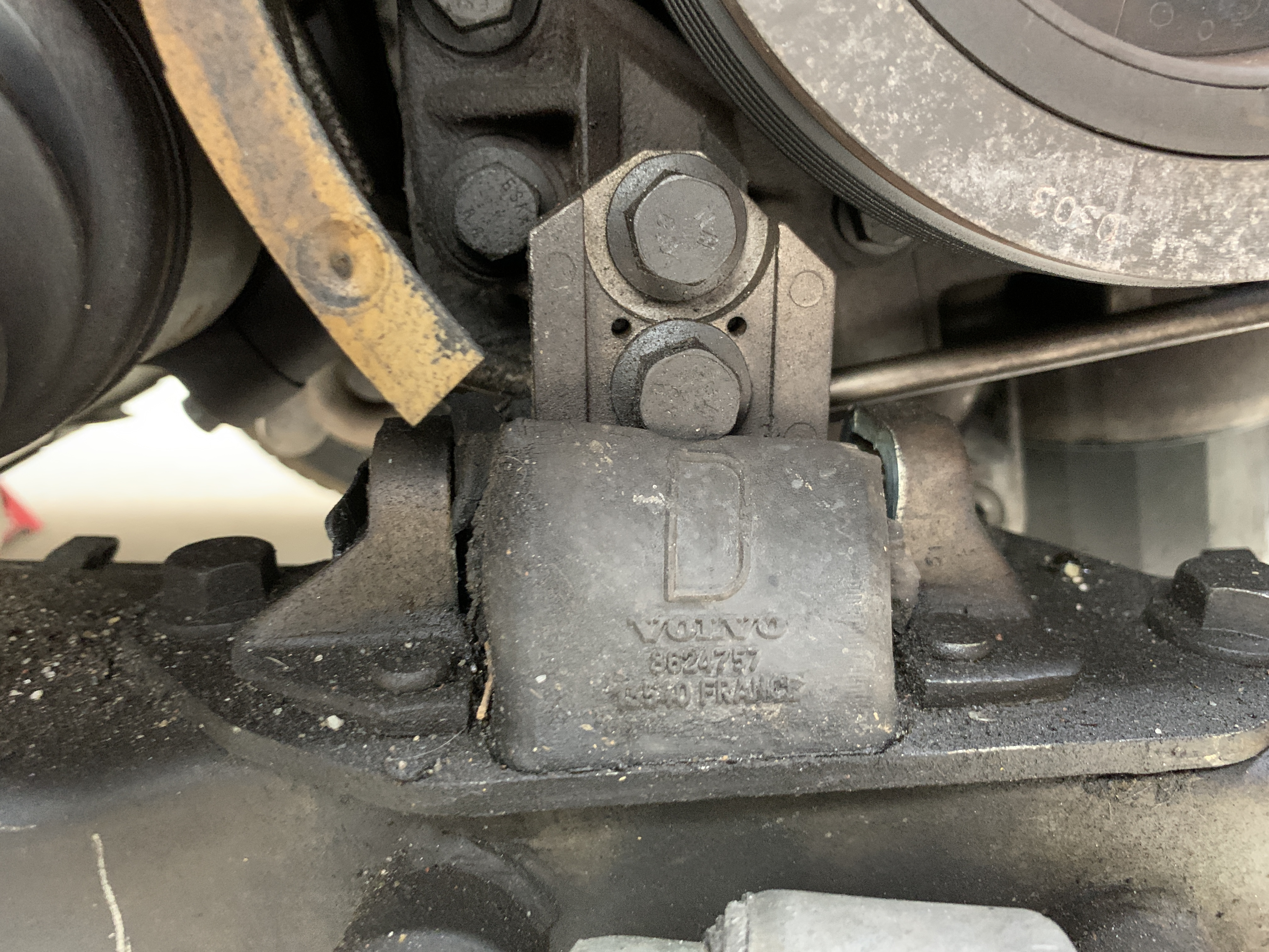

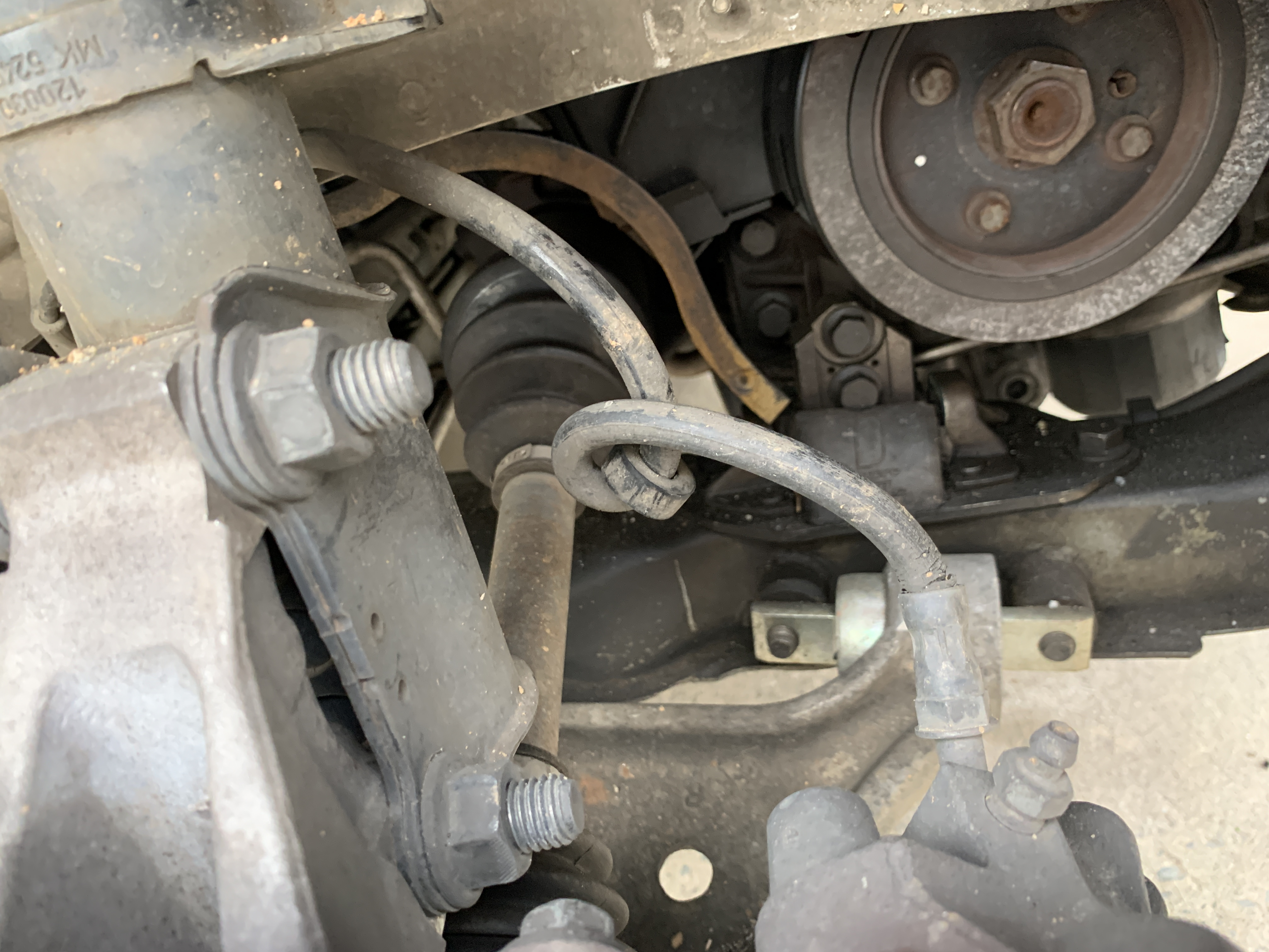

Changed the passenger side engine mount and lower torque rod in my brother’s S60 yesterday, and discovered that the brake line somehow curled itself up. No idea how this is even possible... I feel I would have noticed it before if the brake caliper had been flipped around. So I took care of that.

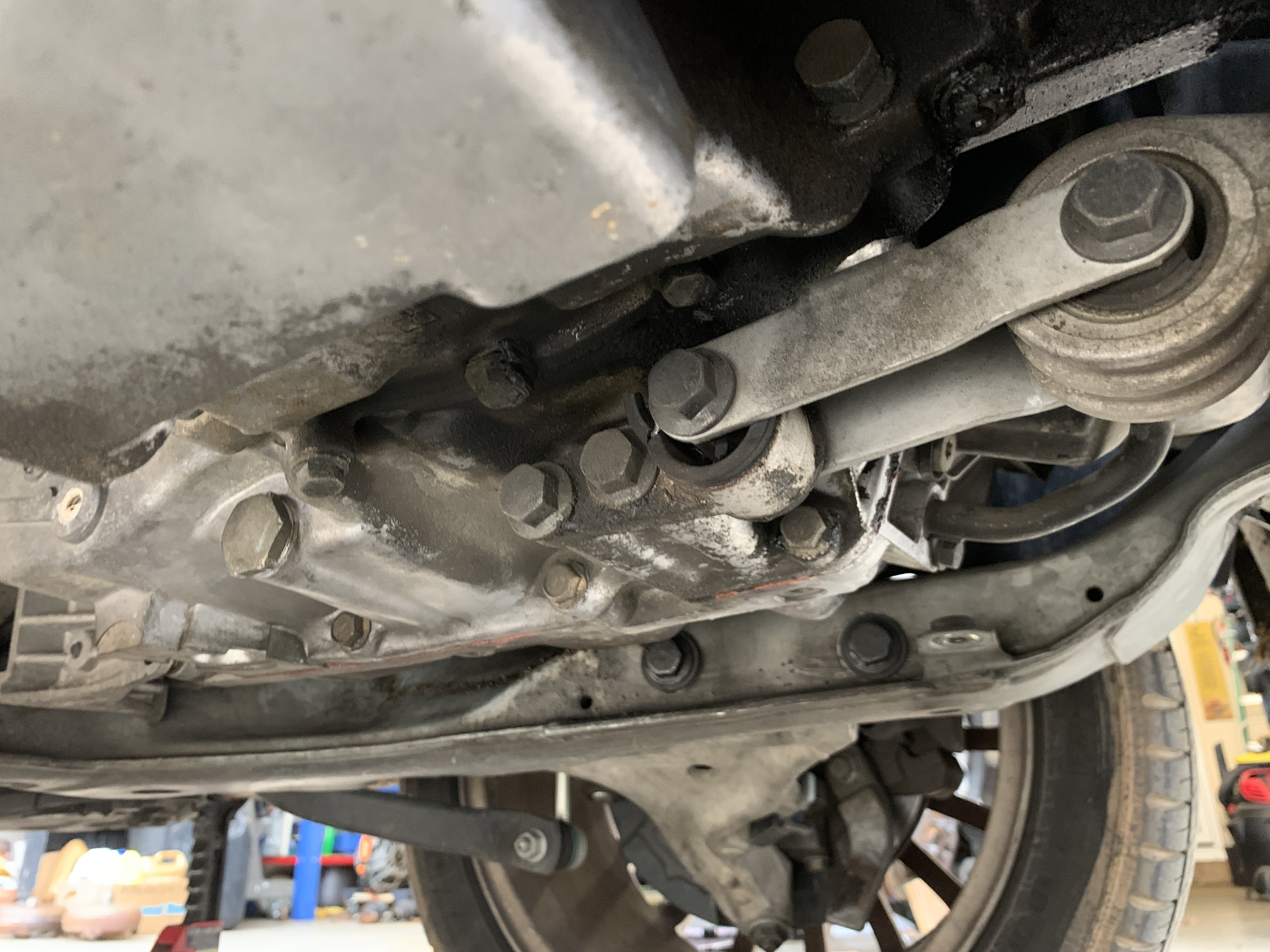

Also discovered the worst lower torque rod I’ve ever seen... the bushing on the transmission side was totally failed, it allowed the rod to flop around with zero resistance.
These two new mounts solved the nasty vibration the car had. Now it just needs struts, shocks, and brakes! Lowest mileage Volvo of the fleet and it needs the most work, meanwhile the highest mileage one is practically brand new... go figure!

Yeah, someone gorillaed the caliper around during a brake job.

My buddy was asking the same thing, i think its just because the wheel is off the ground in the photo. To me it seems like the trailing arm drops a bit on a pivot, so it's pulls the lower spring seat away at an angle. Or its totally busted and i have no idea why!bmdubya1198 wrote: ↑07 Mar 2020, 22:17 Maybe it’s just the picture, but what’s going on with the spring? It looks like it’s taking an aggressive bend.

Unloaded suspension, exactly. Even worse with the HD blue IPD springs I have on the T5

Ah, yeah, probably just the unloaded suspension.

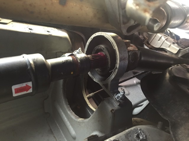

Pretty sure those splines should be fully engaged...

The splines are ok, but the center carrier bearing is installed upside down. See the nice arched piece of the frame it would fit into it it were right? That as just after two stage torquing of the rear differential ZNS TTY ONE use bolts

Carrier bearing looks like it hasn't had enough personal attention (after several hours working on it) and has flipped just to get some attention =P

Now just how did that happen?
