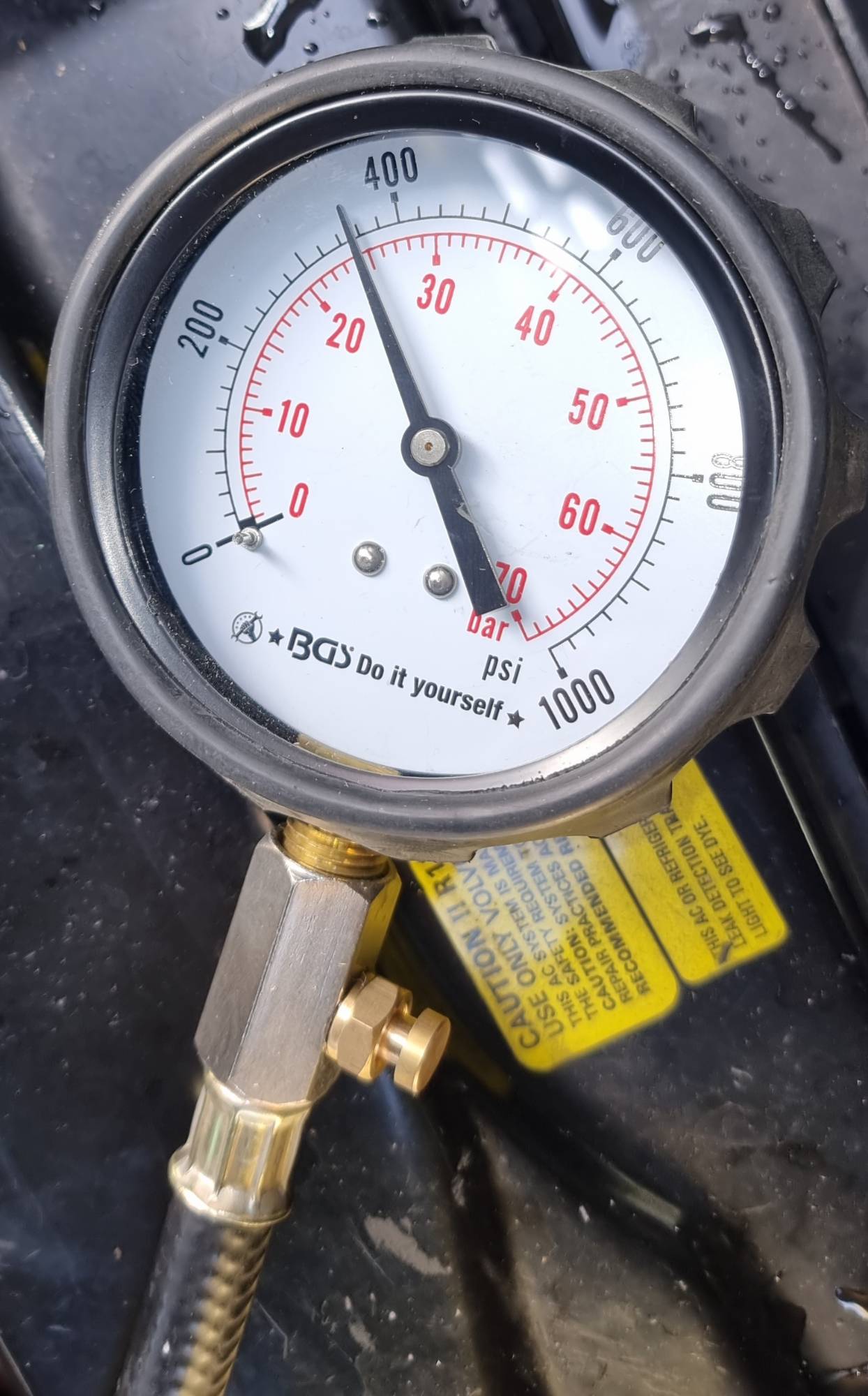

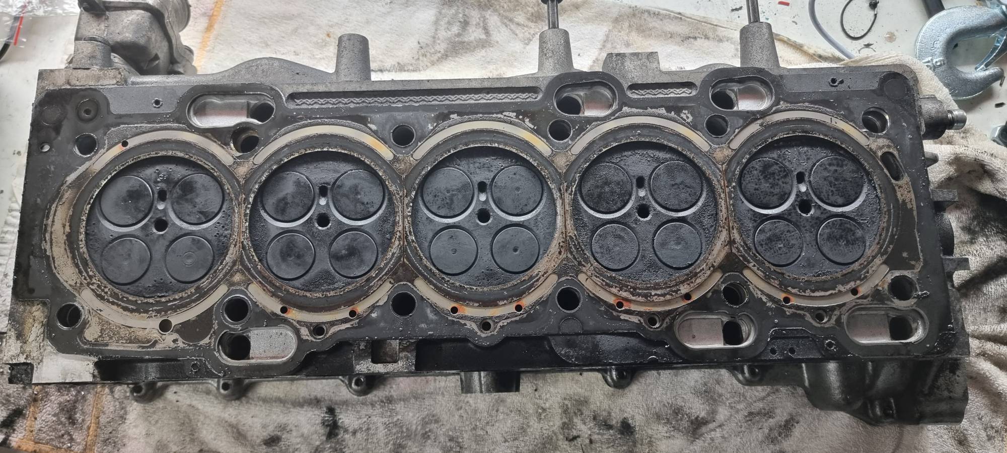

Last night I pulled the head off of my D5244T to repair the damage, that the previous owner did to the injector clip threads.
Also giving it a good clean with a walnut blasting and ofc new head gasket. Have yet to measure if the head is bent, but I'm optimistic.
Compression was good all around (24-26 bar, 350-377 psi). 2 pistons show signs of detonation (craters), but thats fine. No damage to the sleeve.

350 psi for compression? Is that higher than stock?

ZionXIX wrote: 11 Feb 2024, 11:09 350 psi for compression? Is that higher than stock?
Did wonder too.
Could not find the nominal compression for that D5244T (yet).
Engine has either 125k or 190k miles on it. Pretty healthy compression for both mileages.

That is impressive that a head gasket can handle that. The shape of the pistons and combustion chambers is really interesting - completely flat across the valve faces.

Haynes paper manual says 24 to 31 Bar Normal, 22 Bar minumum for DIESEL engines such as the D5244T. That has 120kW (163 bhp).
Looks like some of the carbon build up may have raised the compression.

Ah, I didn't realize this was a diesel model. Now it all makes sense. Diesel engines operate entirely on compression and have much higher pressure than gasoline engines.
