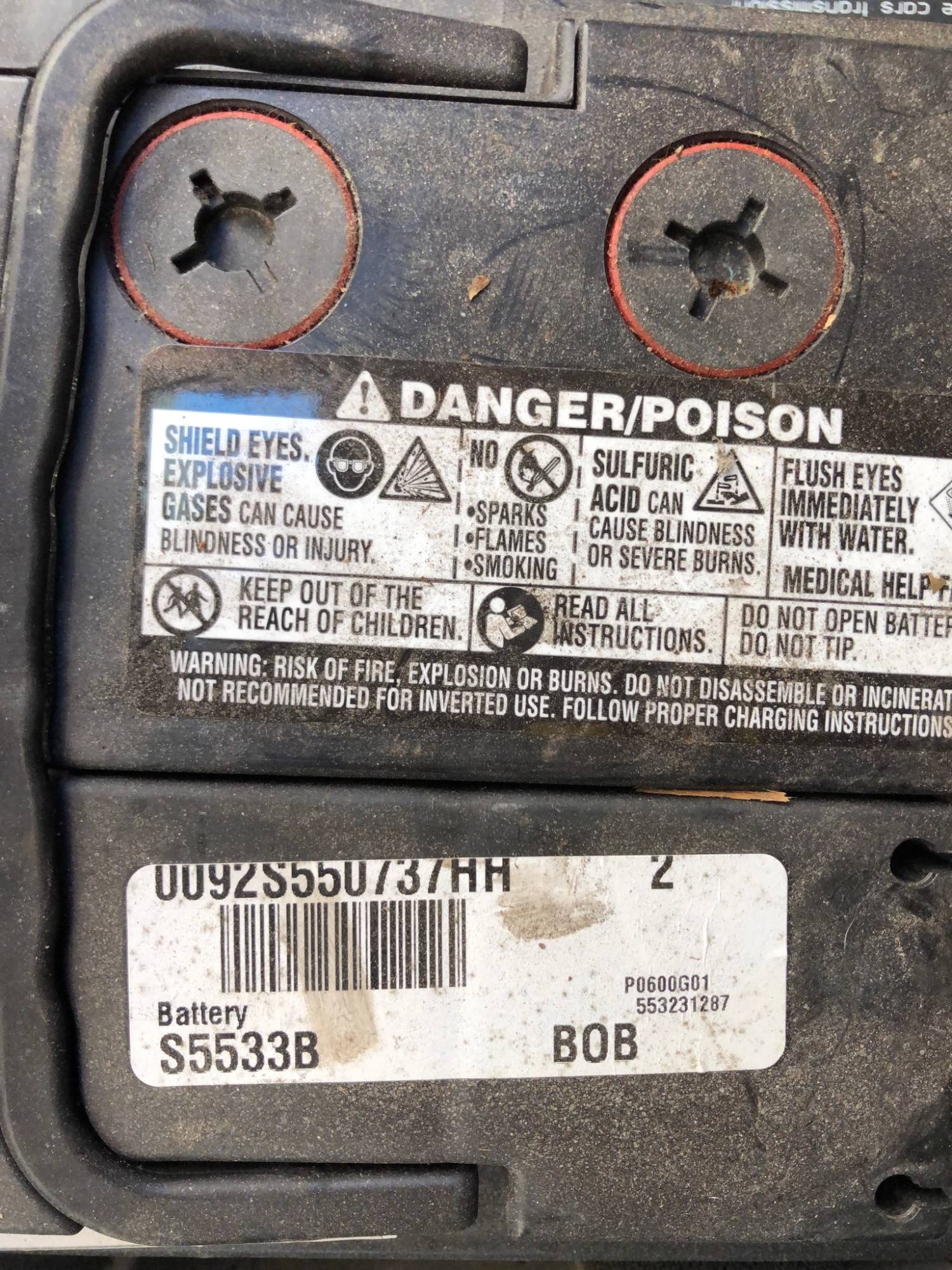

Brought back to life a dead battery and removed the injectors. The Bosch S5533B came with the 2002 V70 XC and needed to be jumped when it came off the car carrier. Car has been sitting so the charger needle was not moving a hair. Can't remember where I saw this and what type of battery it was. I went ahead and reversed the polarity with the battery charger and the charger went full tilt AMPs pegging the needle. This indicated there was still continually and a not an open from a broken post or plates.
Did this several times for a quite a few seconds and then tried charging it. Saw a little needle movement so just tapped the post a dozen times and it seemed to come back to life. Left it on for 36 hours and it's fully charged to around 12.7 Volts. Once I get the injectors in and perhaps on the road I'll see if the battery is still any good. Has an 02/21 manufactured date.

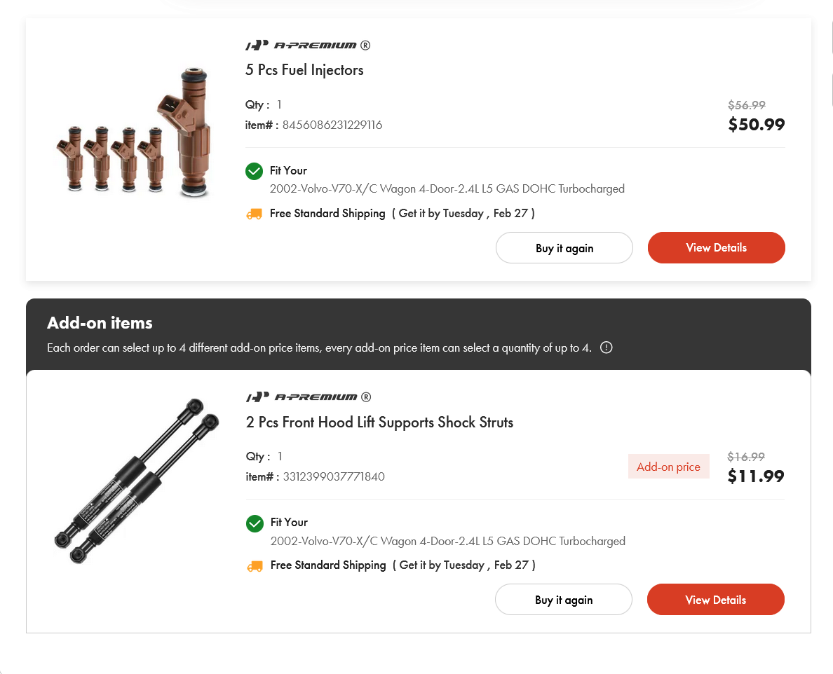

With the battery in, tested the continually of the injectors and found #4 opened while others were 12.2 ohms. There were voltage at all the plugs so glad and hopefully it's the one injector causing the rough running and engine shut off. Removed the fuel rail and order a full set of generic injectors from A-Premium. Have purchased some parts from this company previously from another website but recently purchased a starter direct for the 05 GS430 so decided to try the injectors. Has a 3 year warranty and the seller is very friendly and responsive.

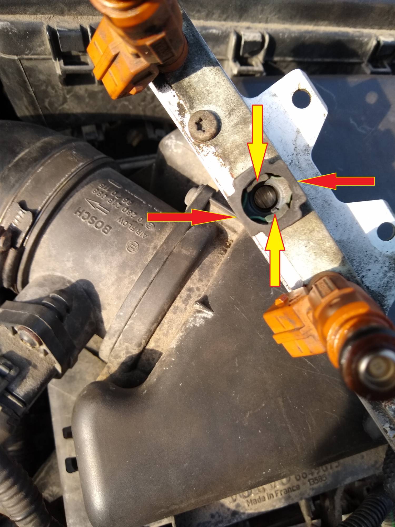

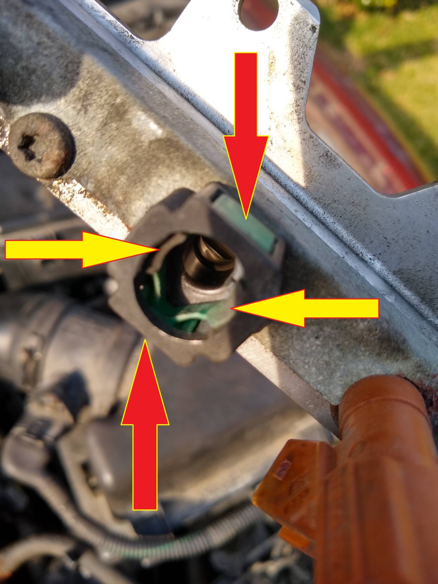

To remove the fuel supply connector, I had no clue at the time, since I couldn't flip up the green tab with a small screw driver I decided to push them in. Discovered another on the bottom so push both in and hope for the best while pulling.
When depressing the green tabs (red arrow) the two holders (yellow arrow) will pull back allowing the supply tube to be released. Found some left over wire shelving parts to cap the supply line and keep debris out of the injector holes.

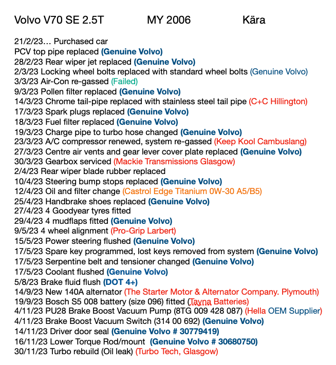

This is a list of most (I may have missed a few) of the faults I have rectified in the past 12 months
