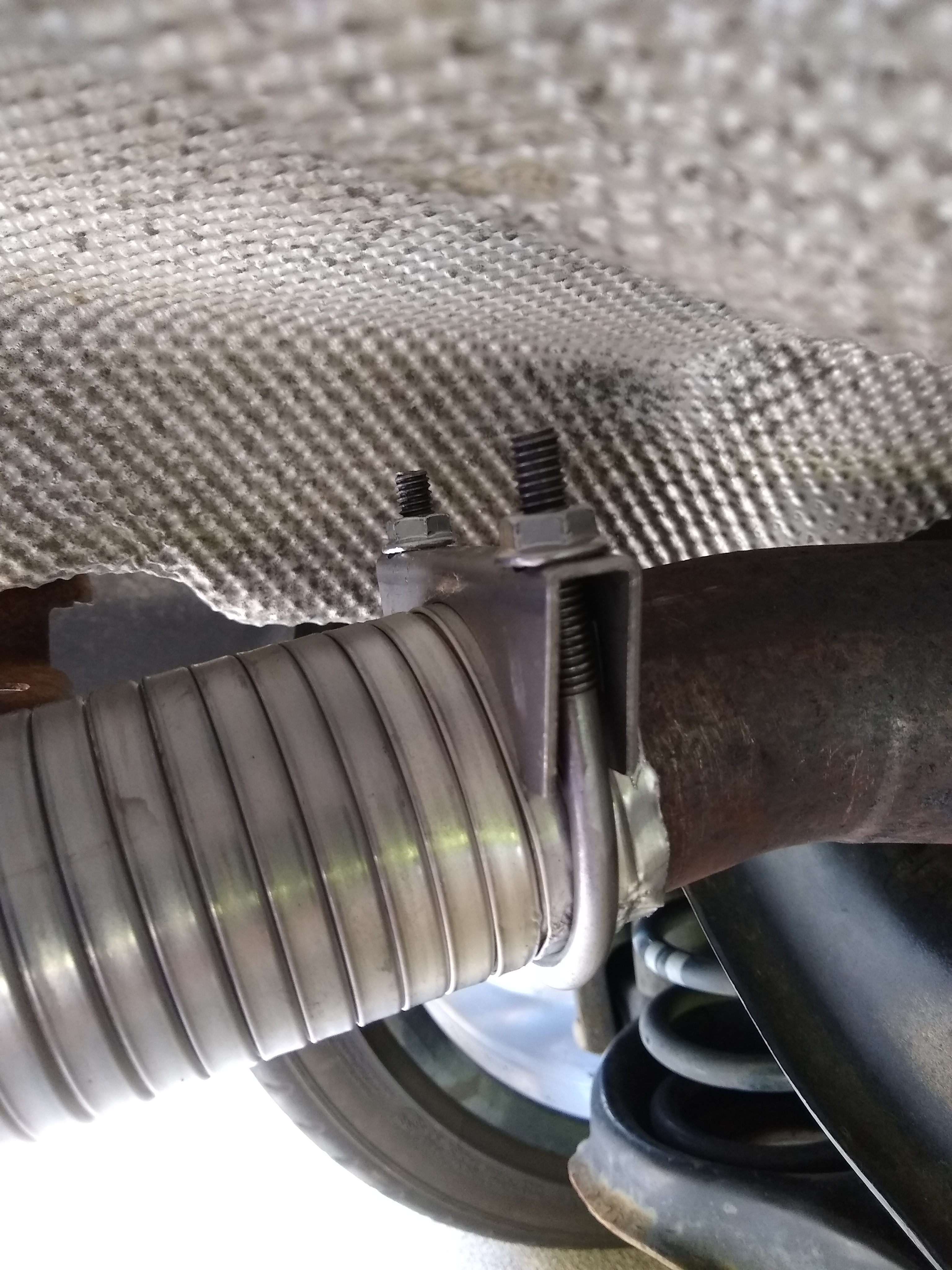

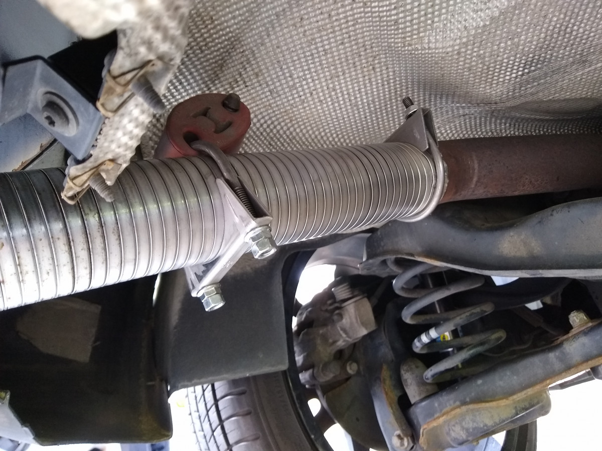

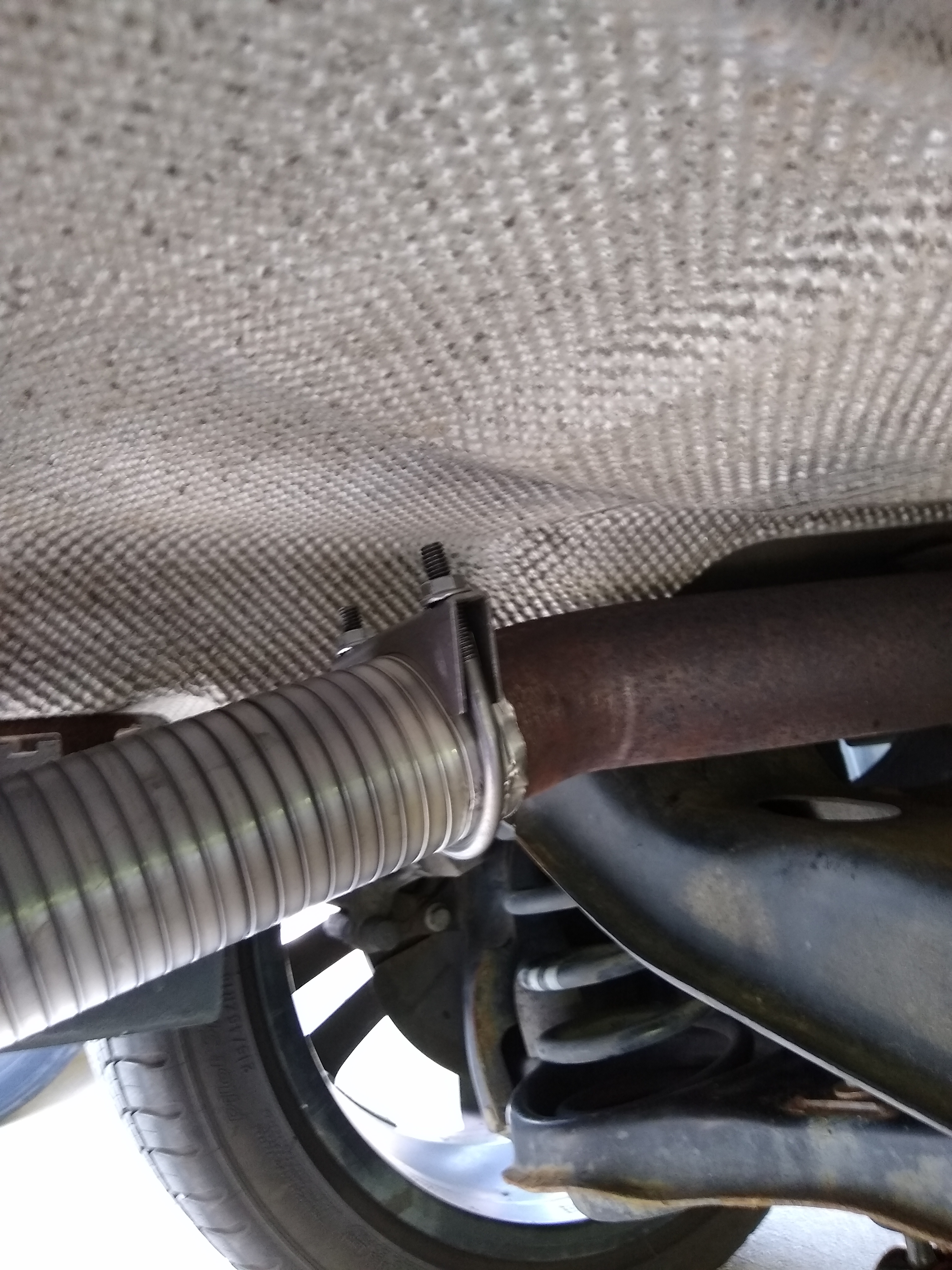

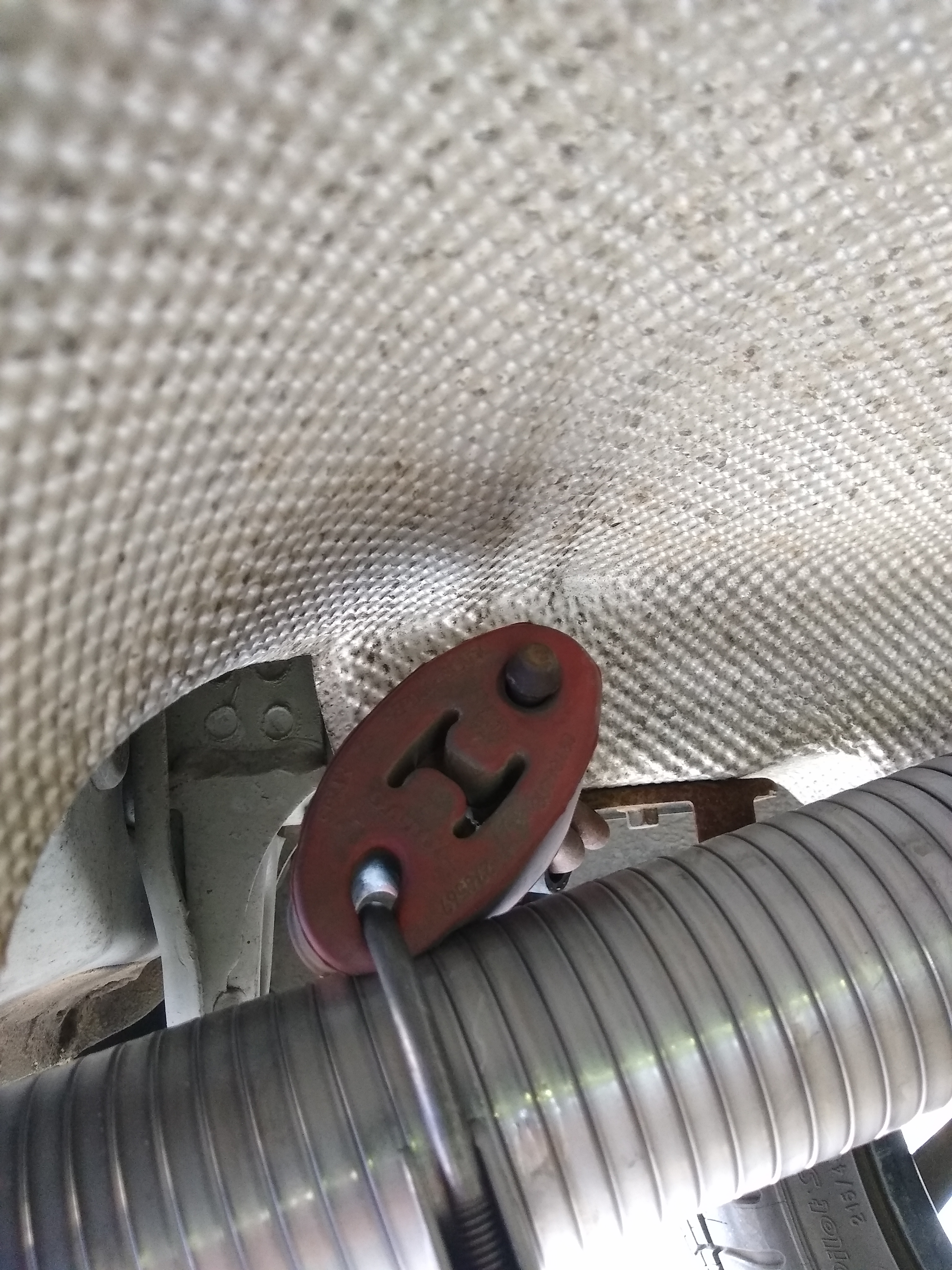

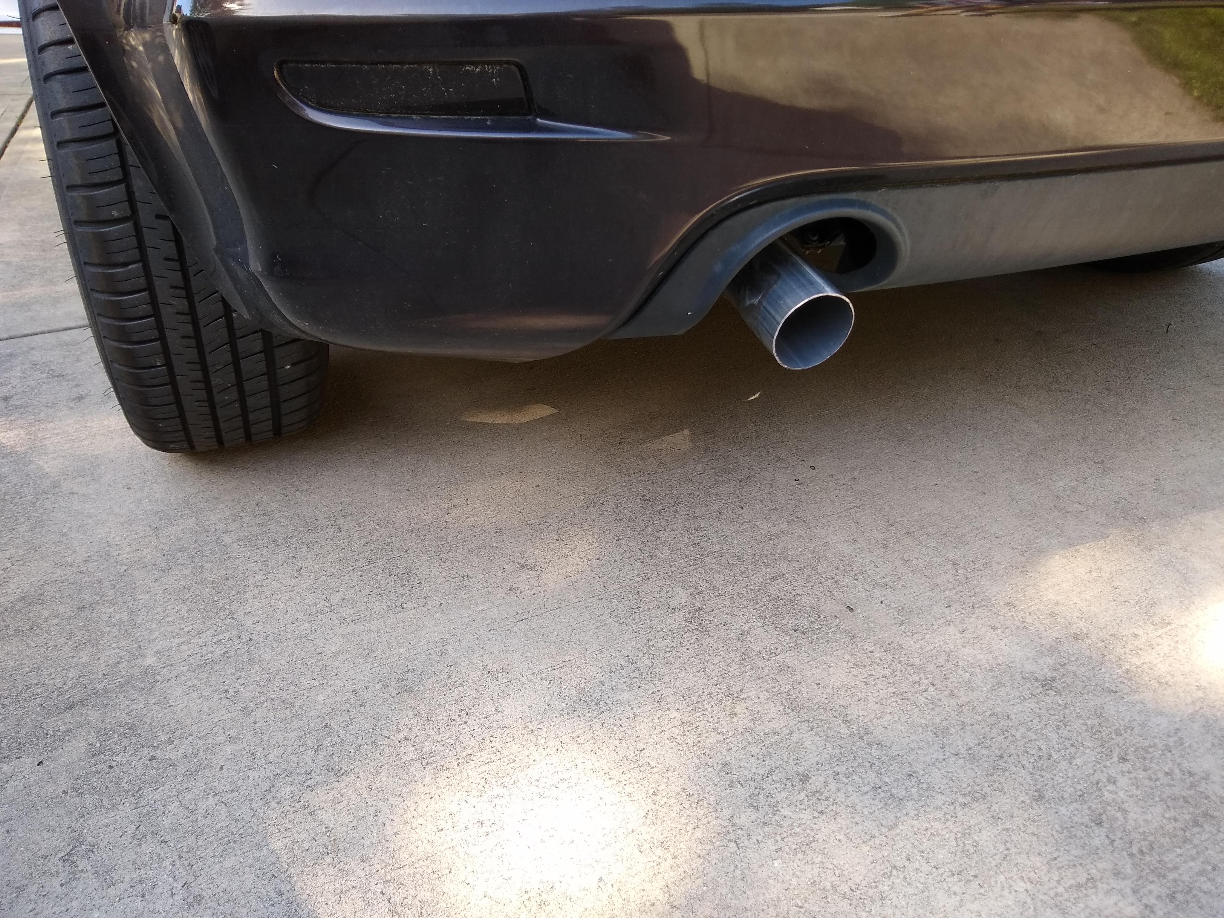

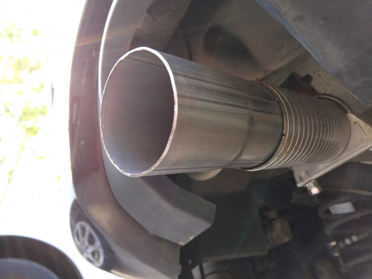

More? Is it worth it in terms of cost to effectiveness? Yesterday son and I were talking about insulating the spare tire well / trunk area of our C30 due to the muffler delete. Went from no muffler, a walker flex pipe, a solid pipe and lastly flex pipe slipped over the solid pipe to act as an open / inside out resonator. Was not planning it but the parts just happen to come together as such.
Around $18 for the experiment. Now it's bearable till we decide whether to buy a welder to fabricate our own dual exhaust. How much sound will insulating the spare tire well further bring down the remainder of the livable drone?

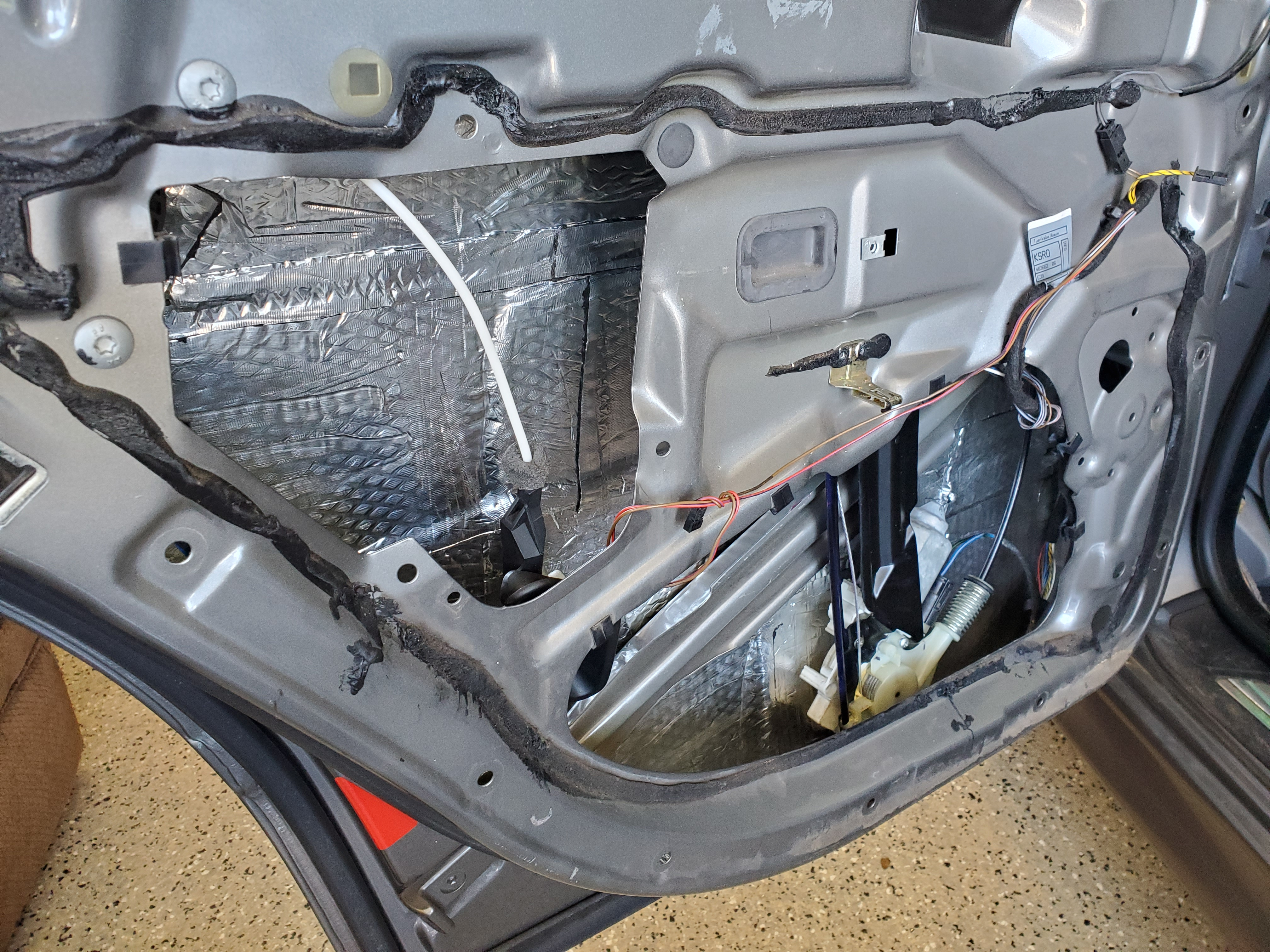

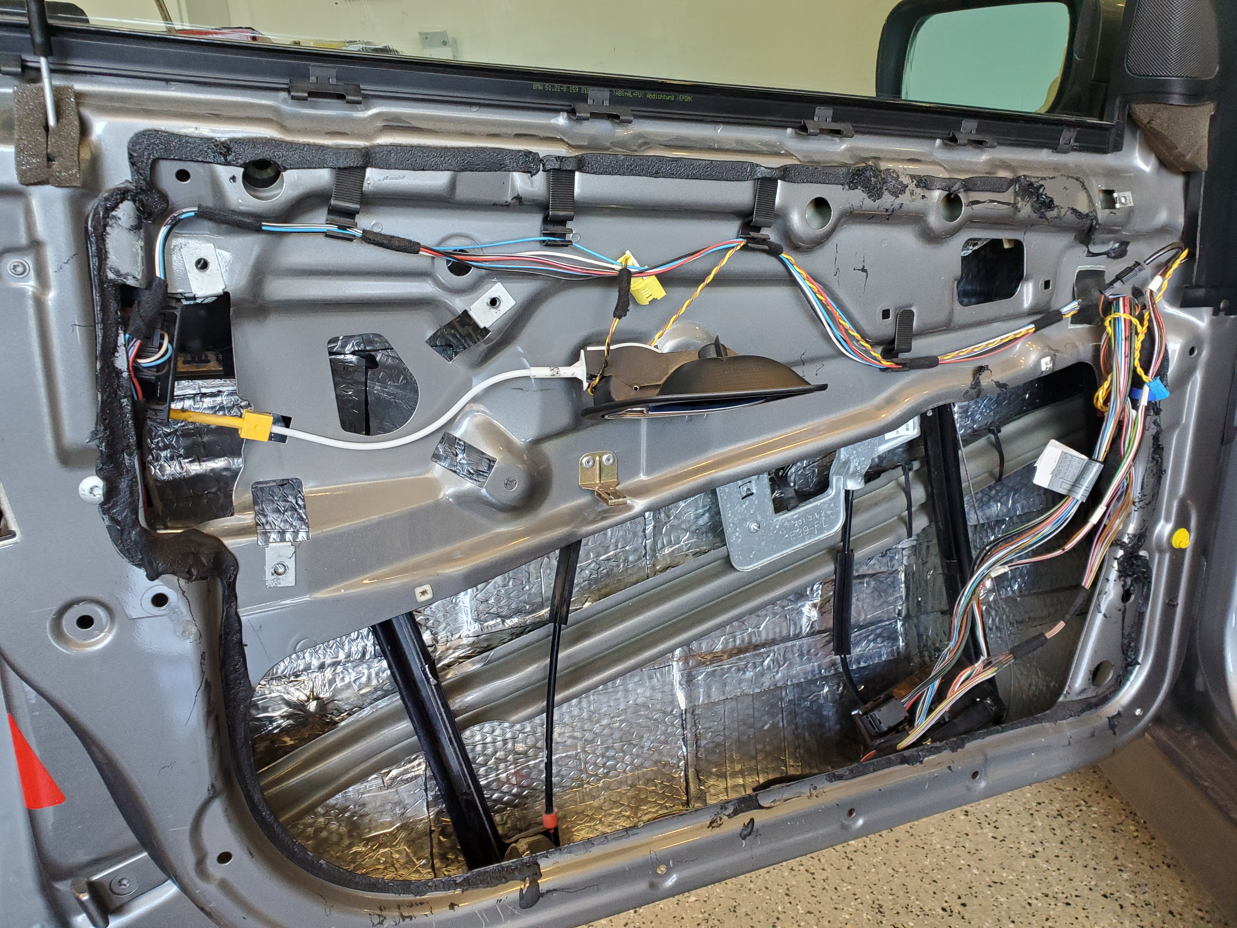

Huge case of diminishing returns when you get above 25% panel coverage. Those products typically only work for vibrational dampening (naturally), so will reduce structural-borne noise but won't do anything for wind or tyre noise.
If you're looking to reduce airborne noise (like wind and tyre mentioned above), then you'll need to add absorbers - thicker foam or fibrous products.
The drone from your exhaust is caused by resonances in the system, the dampening types of product used in the doorskin above will not do anything for that. You can reduce the audio of the drone by using acoustic absorbers, but you won't eliminate it through such treatments.

It reduces vibration and outside noise. Also gives a nice, heavy safe-like thump sound when you close the doorsMoVolvos wrote: ↑23 Apr 2020, 18:51.

The one material is dense and like someone holding / supporting you while you are being tossed to and fro / jointed so is a mechanical / physical restraint while the muffler is sound vibration requiring air pockets to reduce / filter like insulation?Cookeh wrote: ↑24 Apr 2020, 02:52 Huge case of diminishing returns when you get above 25% panel coverage. Those products typically only work for vibrational dampening (naturally), so will reduce structural-borne noise but won't do anything for wind or tyre noise.

Precisely. Dampers add mass and elasticity, reducing vibration - stopping the noise from transmitting along the panel. This won't stop noise passing through or being reflected.
Absorbers prevent transmission of airborne sound through viscous and thermal losses as the wave travels through a medium. Essentially they reduce the energy of the sound waves, so needs to be thicker and porous.
In the case of exhaust drone, the exhaust is already insulated vibrationally through rubber hangers so you'll need absorbers along trunk or floorpan to reduce the drone itself.
