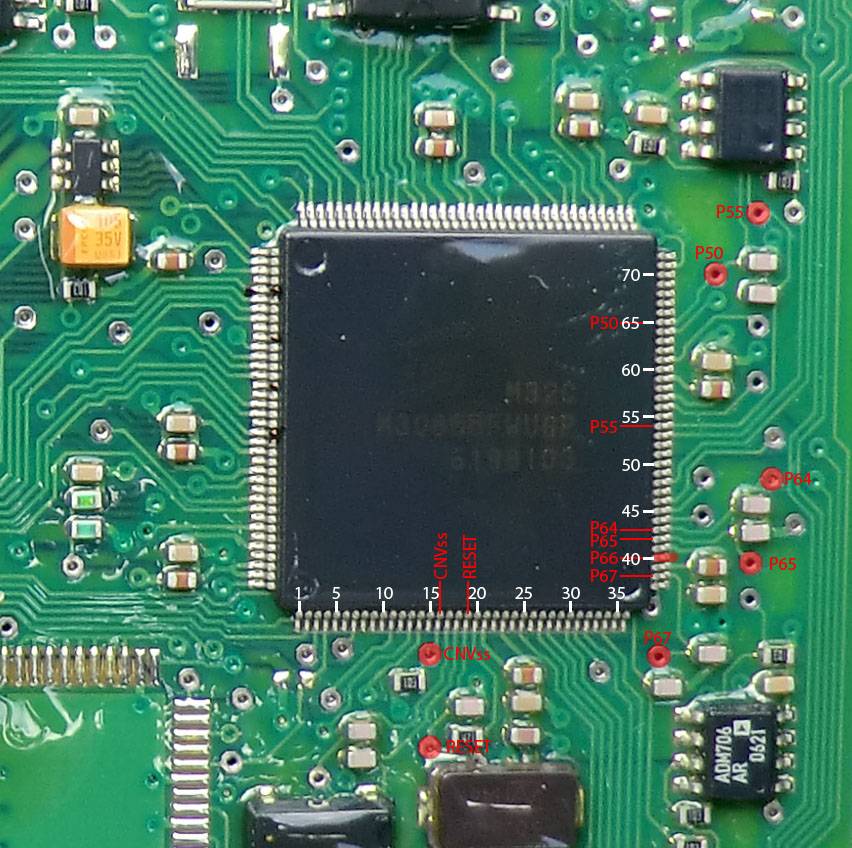

viewtopic.php?p=582463#p582463Skavac wrote: 02 Feb 2024, 22:02 Anyone knows if CEM-L can be read with Orange5? I can see it supports M30855F, but I can't find a wiring diagram to connect the CEM to the orange 5. Reason I am asking because failed write with IOTerminal. Now CEM is dead

I see that M16C Flasher needs CEM PIN for it to work. I still have the original PIN before the CEM got bricked. What if the write process changed the PIN of the CEM? Is there a way I can still use M16C Flasher?

No, it does not need the Volvo software PIN. M16/M32 chips have another, their own PIN embedded into interrupt vector at the very end of address space. It prevents reading the flash contents unless the PIN is known. Volvo sets it to all 00s or FFs, which indicates unlocked flash.Skavac wrote: 03 Feb 2024, 20:18 I see that M16C Flasher needs CEM PIN for it to work. I still have the original PIN before the CEM got bricked. What if the write process changed the PIN of the CEM? Is there a way I can still use M16C Flasher?

Renesas Flash Development Toolkit 4.09 can also be used to read and write M32C with a 5Volt serial interface.
https://www.renesas.com/us/en/software- ... amming-gui
- L_CEM.jpg (168.58 KiB) Viewed 1353 times

This is how I bricked my CEMrkam wrote: 04 Feb 2024, 07:46 Renesas Flash Development Toolkit 4.09 can also be used to read and write M32C with a 5Volt serial interface.
