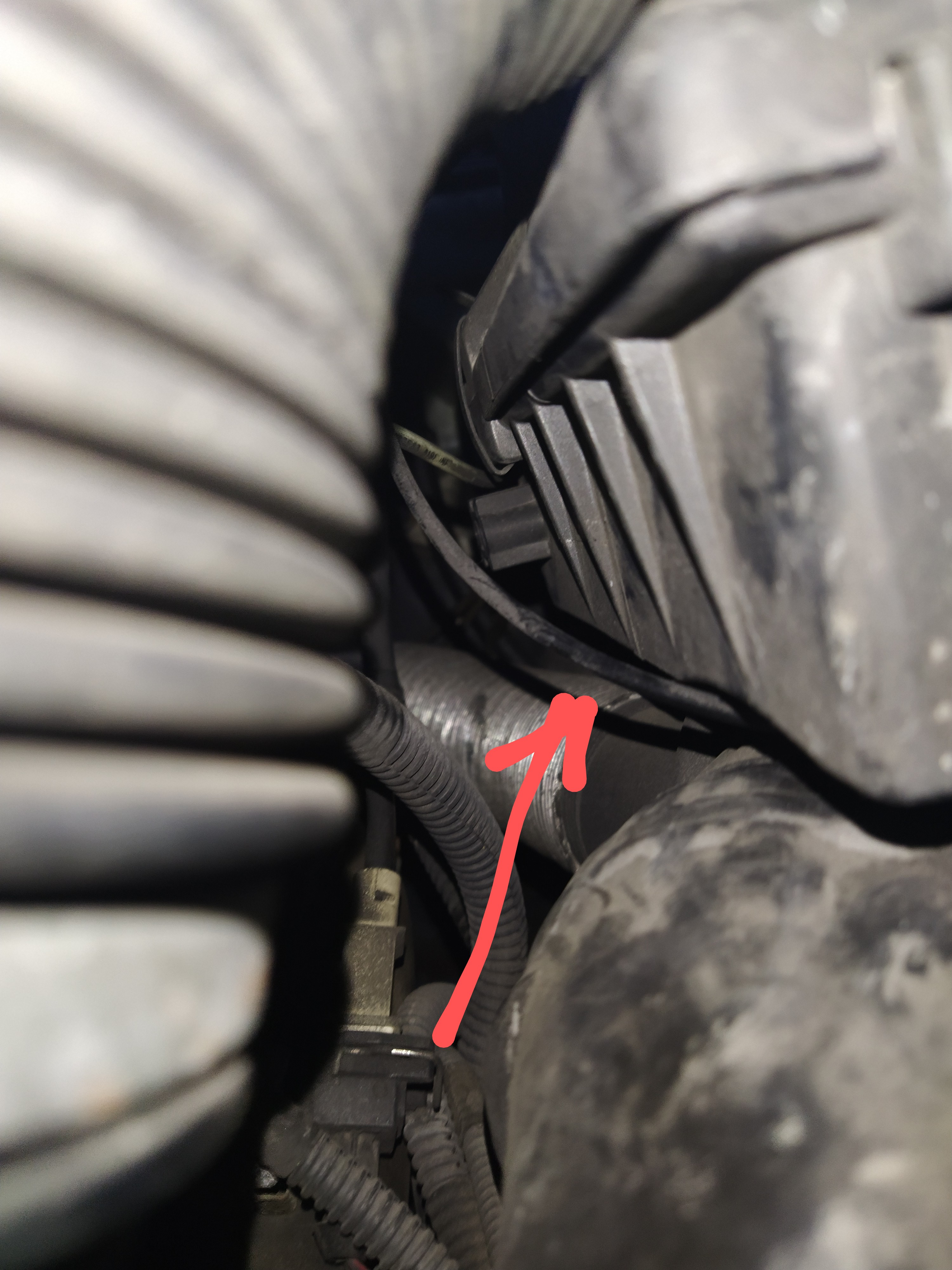

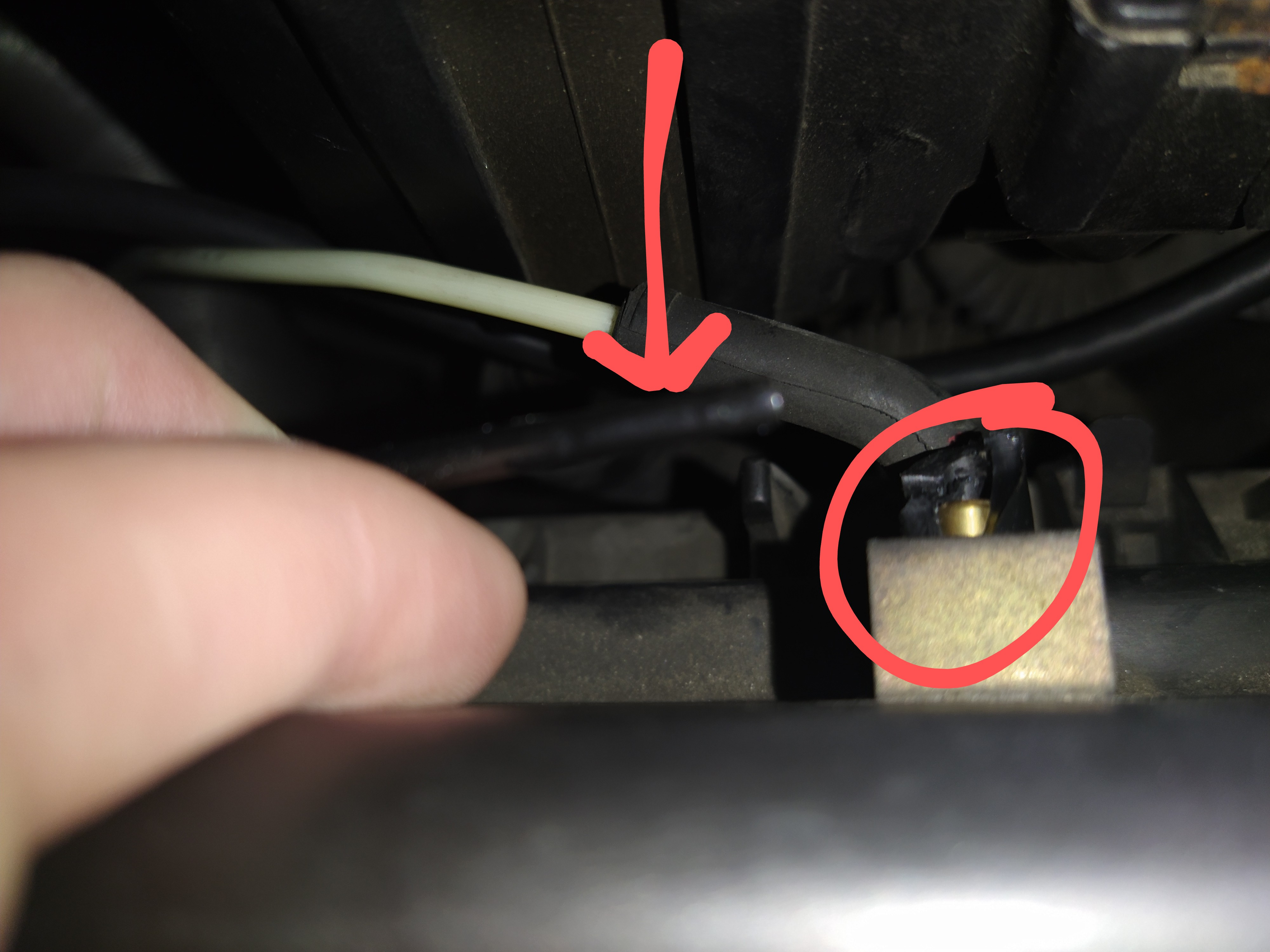

Today I changed the rotor, distributorcap and spark plug wires on my S70 (sparkplug wires from Bougicord, the rotor and distributor from Bosch). Whilst placing back the airfilterbox I snapped of a vacuumhose. It doesn't seem to have a really big purpose, it comes out at the top of the box and go's back to the bottom of the airfilterbox. Question: can I drive with this? :?: Do you reckon the Volvo dealer sells these hoses?

It’s the temperature control for the air of flap. The temperature of air in the air filter box regulates how much vacuum goes to the motor that chooses either cold air from the front or hot air from the silver hose over the exhaust.
any vacuum hose that fits snugly will work, you don’t need to hunt the rare hRd line and then that expensive fitting which will likely crumble in your hands.
The car will run fine without it , especially in civilized climates like Orange Ville
