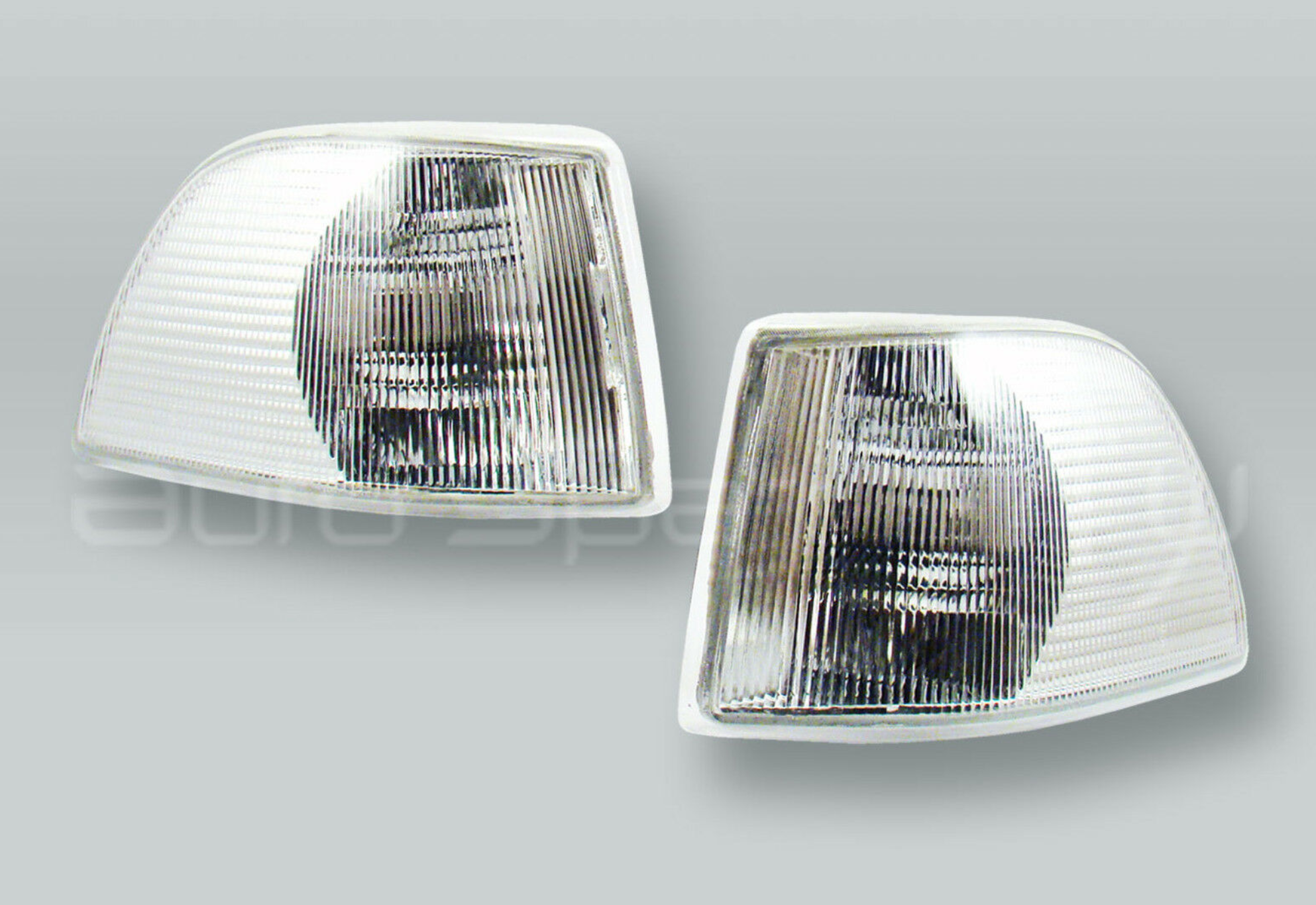

I like those corner lights! I thought about getting them for my car before I found the set of jewels.
