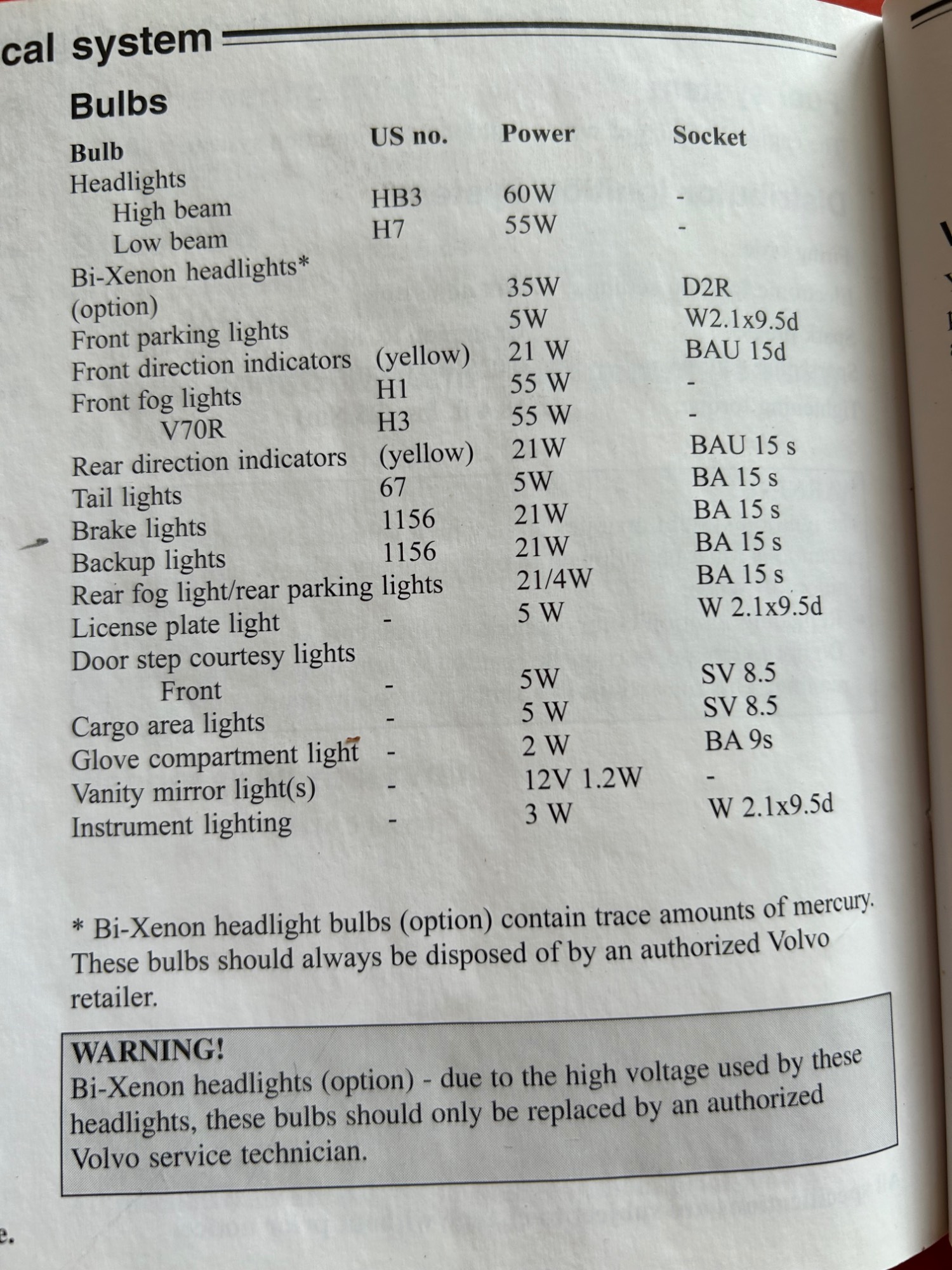

It’s light bulb day, replace them all in new pairs so there’s not any voltage warning weirdness.
Y’know when you have forums, and you can ask any stupid question and forget how to look things up, but you think to maybe check the owners manual, and it’s a Volvo with actual technical info?…..
