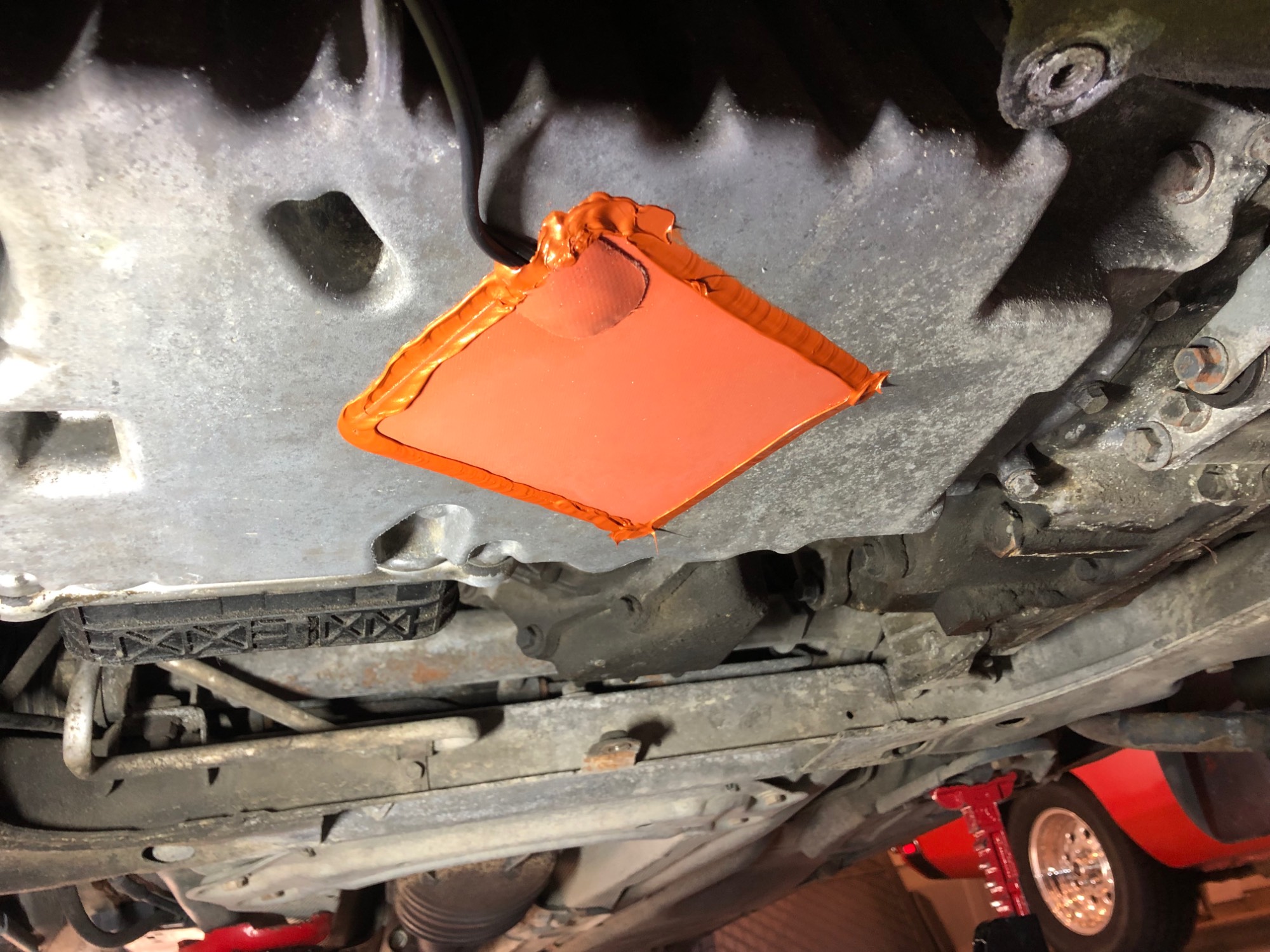

Installed a 150 watt oil pan heater and also checked that my block heater is working in preparation for winter. This car lives outside year round and although it will start in -30 with no supplemental heat, it breaks my heart to have to do it.
I bought this heater at Fleet Farm for 35 bucks. It looks like it’s very good quality and made by Nickson Industries.

.Blacklab467 wrote: 06 Oct 2024, 11:44 Installed a 150 watt oil pan heater and also checked that my block heater is working in preparation for winter. This car lives outside year round and although it will start in -30 with no supplemental heat, it breaks my heart to have to do it.
Searched Nickson Industries and couldn't find it then block heater and eventually heating pad which led to this on Amazon. It's pretty hot, slightly lower than operating temp before cut off.
[Thermal Protection] These 150W/120V oil pan heating pads have a built-in automatic thermal protector that keeps the temperature around 140~158°F/60~70°C. When the temperature reaches 194°F/90°C, this product will automatically power off. When the temperature drops to about 122°F/50°C it will start heating again, effectively preventing safety hazards caused by high temperatures.
https://www.amazon.com/dp/B098TFF39H/re ... hcmVk&th=1
How long does it take to heat the average oil pan? Seems like it would stay on all the time as the oil / pan temp would transfer the heat to the rest of the motor. It's like having a 150W bulb on all day long in the thick of winter especially outdoors.

It looks exactly the same, my in-laws use these on the farm in Minnesota and say they're the best for farm equipment and water tanks for watering cattle. The 150 watt size is appropriate for 5-7 quart oilpans. You can buy them at FleetFarm and Tractor Supply, places like that. Should keep the whole block warm as you say, especially with a block heater as well. Im glad mine still works, those are about $230.00 from Volvo.
