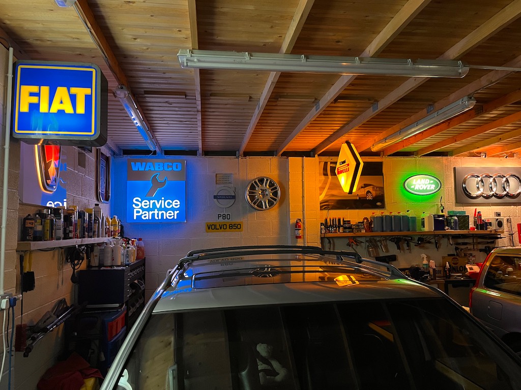

I can't keep any part of my life as clean and organized as your garage.

Beautiful garage!
But that Audi sign kind of bothers me :shock: :lol:

Owned my Audi for 10 years and I have to admit it required less repairs than the Volvo

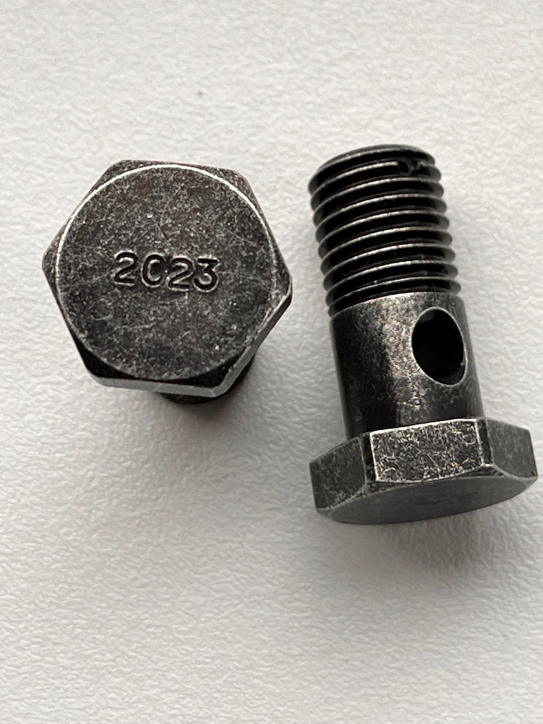

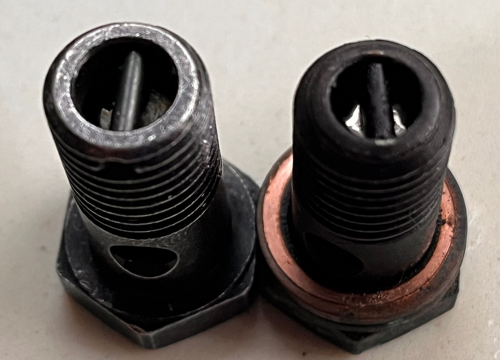

Last week when I knew I was going to the Dundee dealership for the VOS meeting I ordered the infamous PCV banjo bolt as I didn't want mine to explode and kill the engine.
The original banjo bolts are a poor design where the pin can work loose allowing both the pin and ball to get through the inlet manifold into the combustion chamber
On the new bolt the pin is drilled and pressed into the body of the bolt, on the old bolt the pin is held in place by folding over the top piece of metal.
New left, old right
Banjo Bolts 2.jpg (132.91 KiB) Viewed 288 times
Old bolt has a 2005 date, latest new bolts have a 2023 date
Banjo Bolts 1.jpg (191.25 KiB) Viewed 288 times

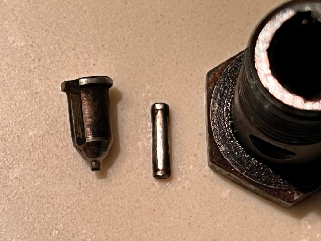

So I decided to have a look at what is inside the dreaded P2 banjo bolt and it's much worse than I expected
I was expecting a small ball bearing which in theory would/should seal the PCV when required, but when I removed the pin I discovered there is a huge 'valve' 'pintle' or whatever it is called that is capable of doing significant damage to the cylinder walls and valve seats. If your car has a banjo bolt under the inlet manifold please check and if it does not have a date above 2014 change it as soon as possible. Both the parts on the left of this picture can and will end up in your engine. Get them changed ASAP. The scary part was it never took much filing to remove the pin and the 'valve/pintle'
