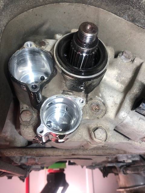

Changed my Haldex pump and filter. The previous pump had failed about a month ago. The fluid was pretty clean but I elected to install a new filter and fluid nonetheless. Annoying job removing the propshaft and flange but nothing was rusted because I had it off about three years ago and greased the areas that usually get rust adhesion upon reassembly.

This is one of the jobs where going Blue Box makes sense. A lot of work that you don't want a do-over on. Glad to hear you got the AWD working again just in time for the snow to be melting away!
