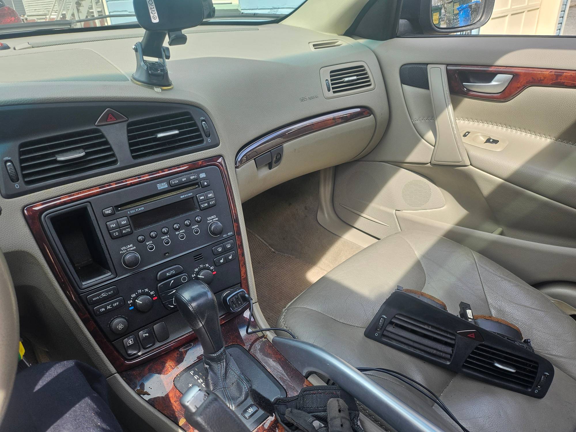

yesterday i swapped out the center-driver air vent! gosh, this has been annoying me since i bought Pyxie. what I ended up doing was swapping JUST the strip with the aluminum center-piece and swapping it to my old vent housing, since the other ones on the spare i bought were all scratched up and mysteriously sticky-- no thank you.

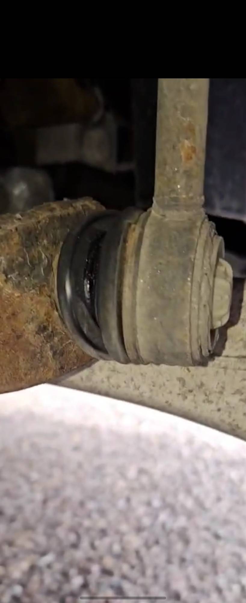

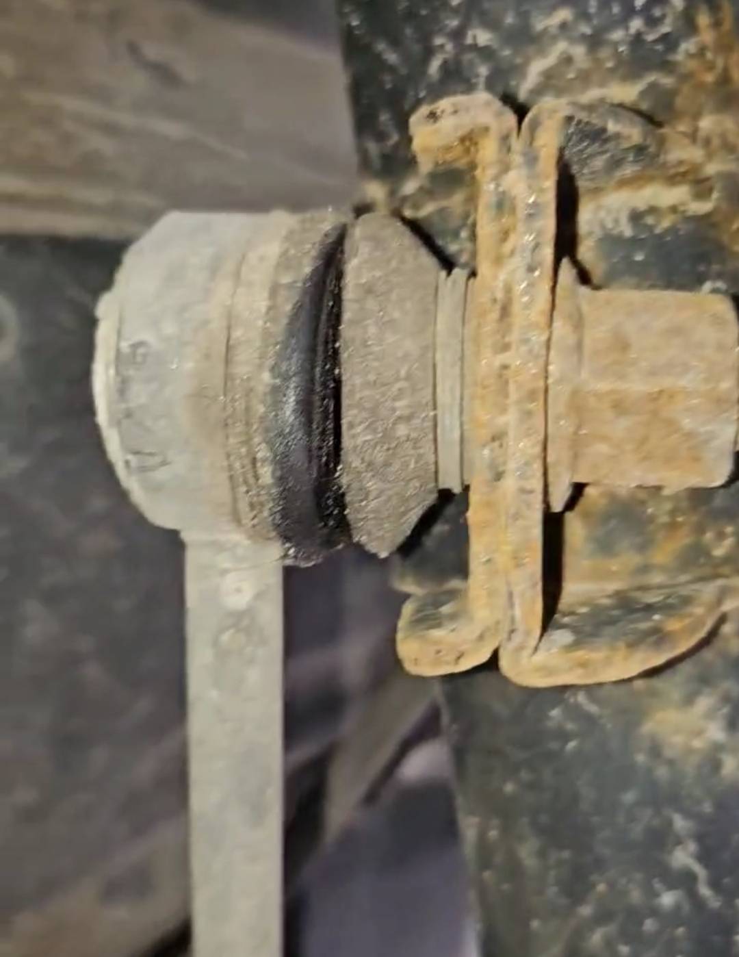

also checked out my suspension: i got my lower-left ball joint replaced and everything aligned 2 weeks ago, but ~5 days ago i was accelerating onto the highway and at about 70 mph i got a new wobble at speed. great. at the same time, the steering wheel stopped being straight while travelling straight, and pulls right again, like it was before the ball joint job. looked up the symptoms, and thought it was probably the sway bar end links gone bad. wouldn't you know it:
ordered the Lemforder replacements on FCP. my first time ordering stuff on FCP and i was pleasantly surprised to find free shipping, and i already knew about the lifetime replacement warranty, so even if these last under 5 years, i'm happy to know they are replaceable for free. hope they send me a sticker to add to the collection!

I don't think the end links will solve your problem, although they probably do need replacement, they are not involved or coincident with the wheels alignment. If things were fine before and now developed a speed wobble, particularly at highway speed I'd look for something that came loose since the alignment, I'm thinking strut to knuckle bolts or ball joint bolts themselves, or tie rod end nut. I'd do this post haste as safety may be a big concern. Please report back on what you've found.

Yah, blacklab is right on that Pyxie, a steering change is an immediate safety issue.

bent tie rods prevented the shop from being able to align my v70, I changed the links and aligned it myself, no more scuffed tires after 1000 miles. But as you say it won't stop wobble.Blacklab467 wrote: 15 Apr 2025, 16:02 I don't think the end links will solve your problem, although they probably do need replacement, they are not involved or coincident with the wheels alignment. If things were fine before and now developed a speed wobble, particularly at highway speed I'd look for something that came loose since the alignment, I'm thinking strut to knuckle bolts or ball joint bolts themselves, or tie rod end nut. I'd do this post haste as safety may be a big concern. Please report back on what you've found.
Mine still vibrates right around 80 mph, I use the vibration as my speedometer,
