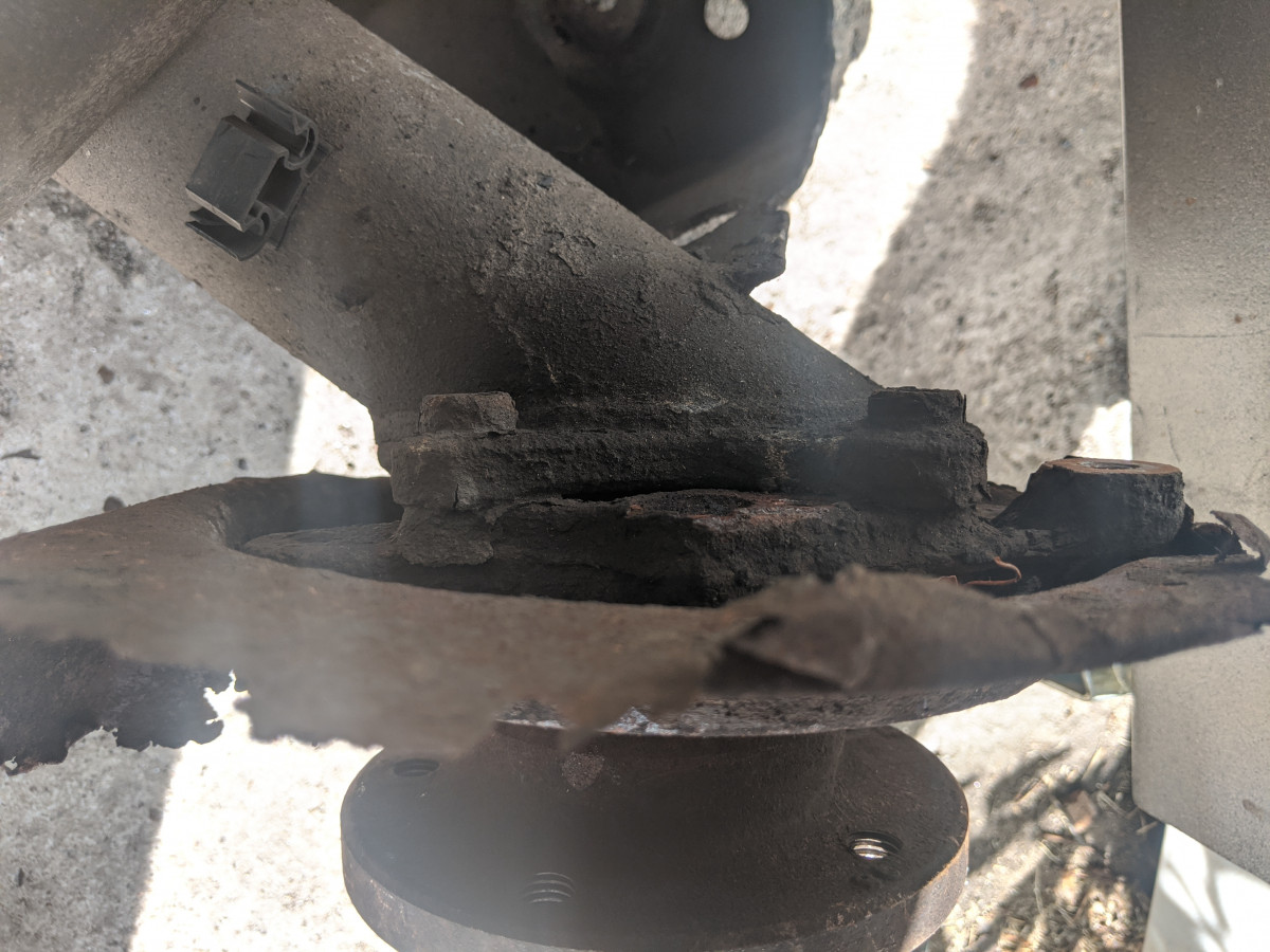

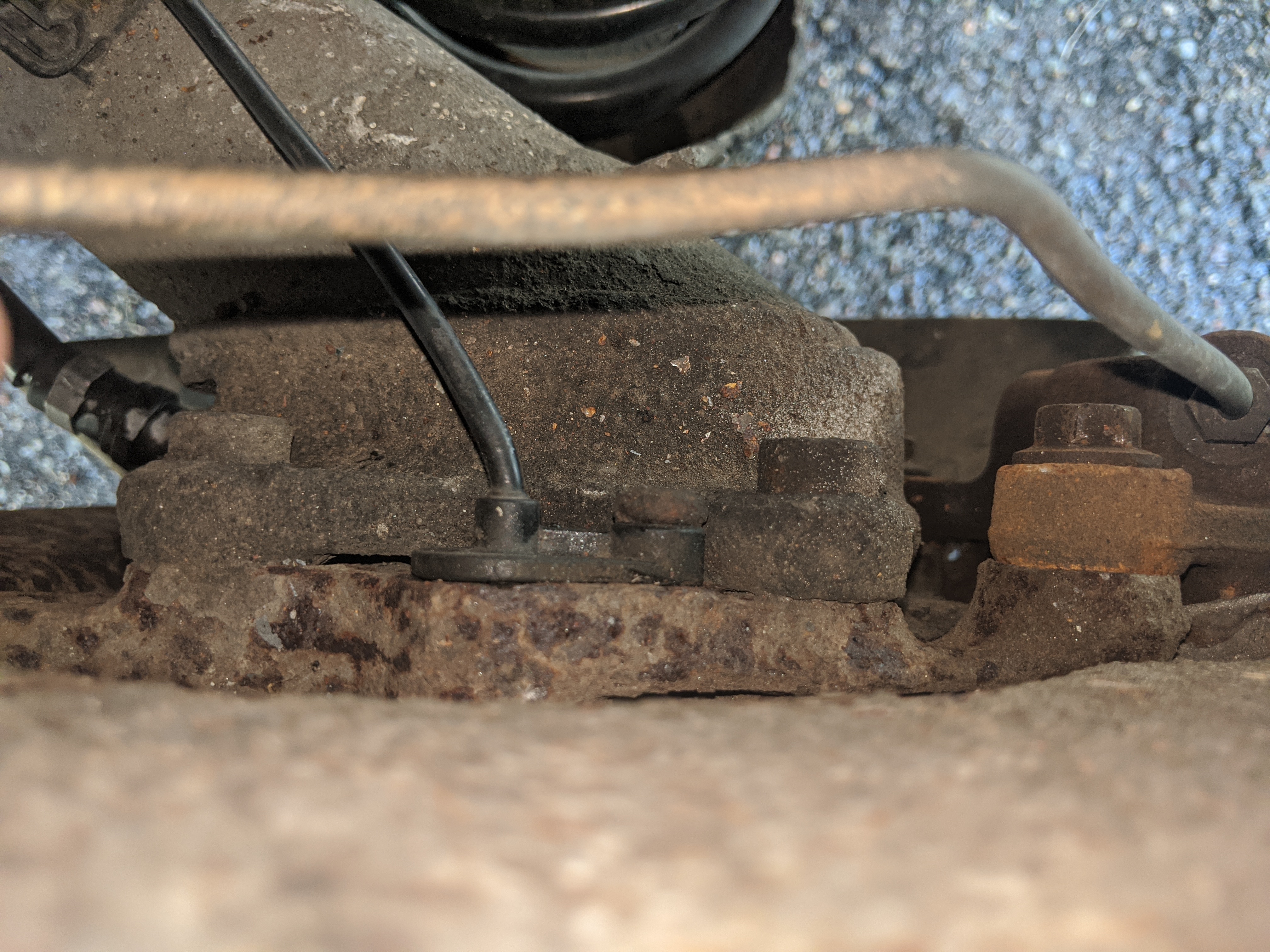

I didn't have a good measuring tool but I found the difference between the two, seems like they added the inch to each side between the spindle/brake bracket and the end of the trailing arm, basically extended the hub out. If you look at the two photos you'll see how they did it. Top photo is the c70 unit on my car, bottom photo is the original.

Yeah, looks like they just welded on some extra material at the hub. Easy enough!
