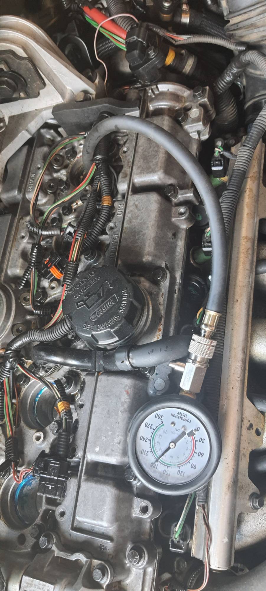

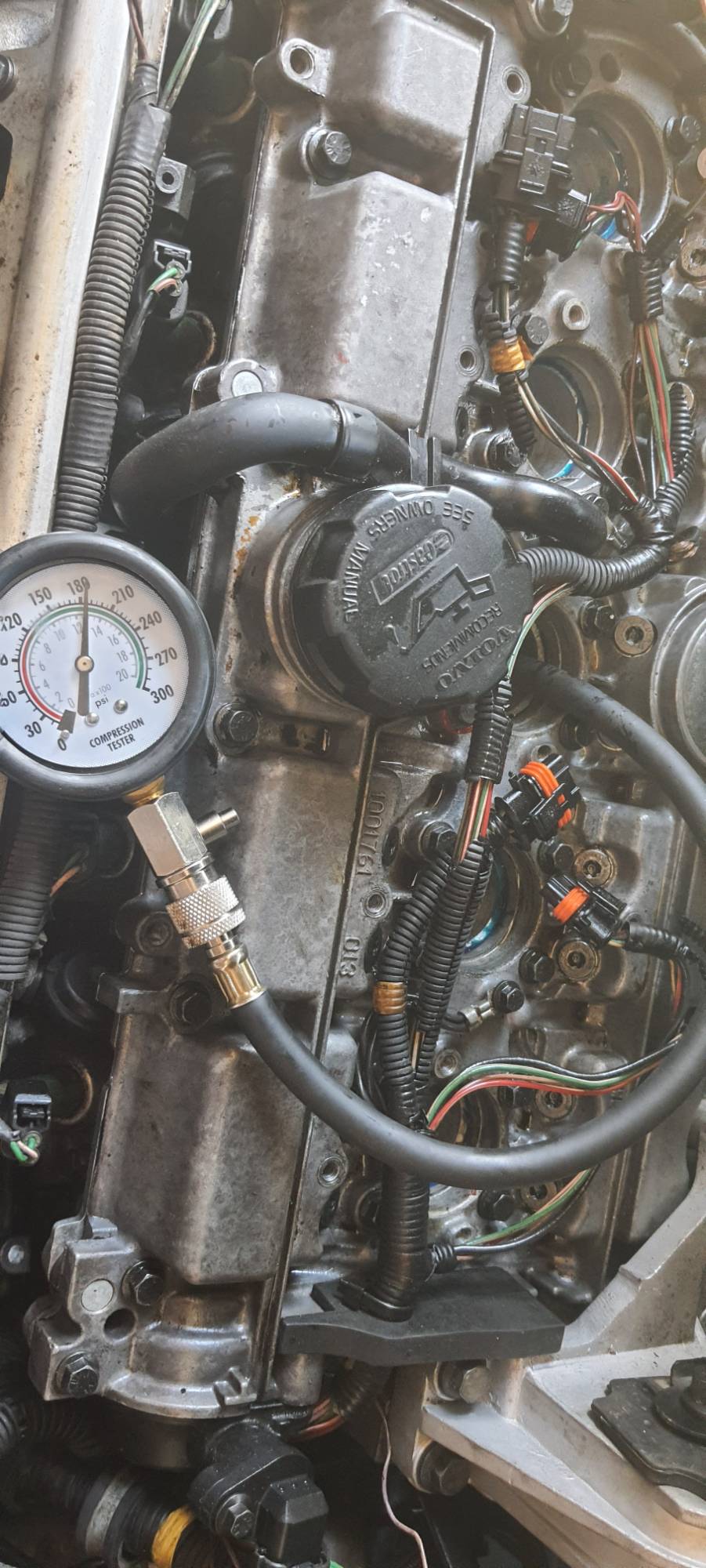

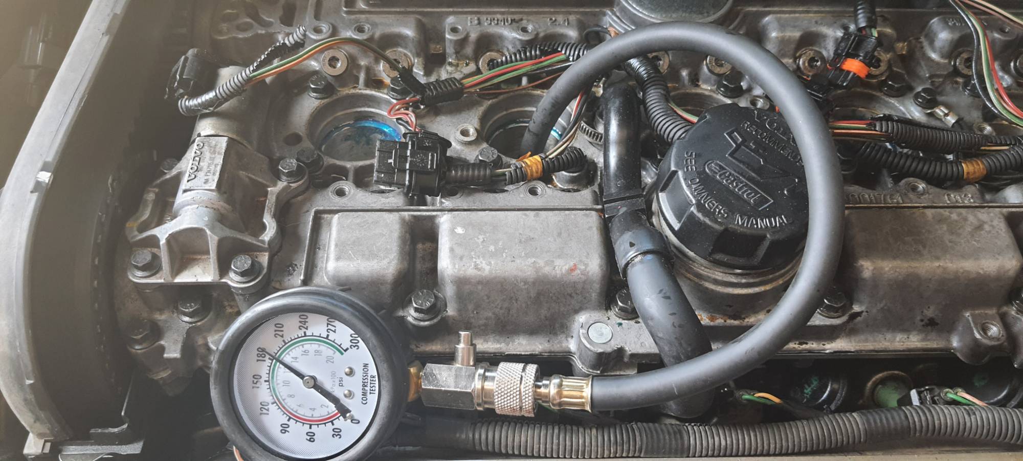

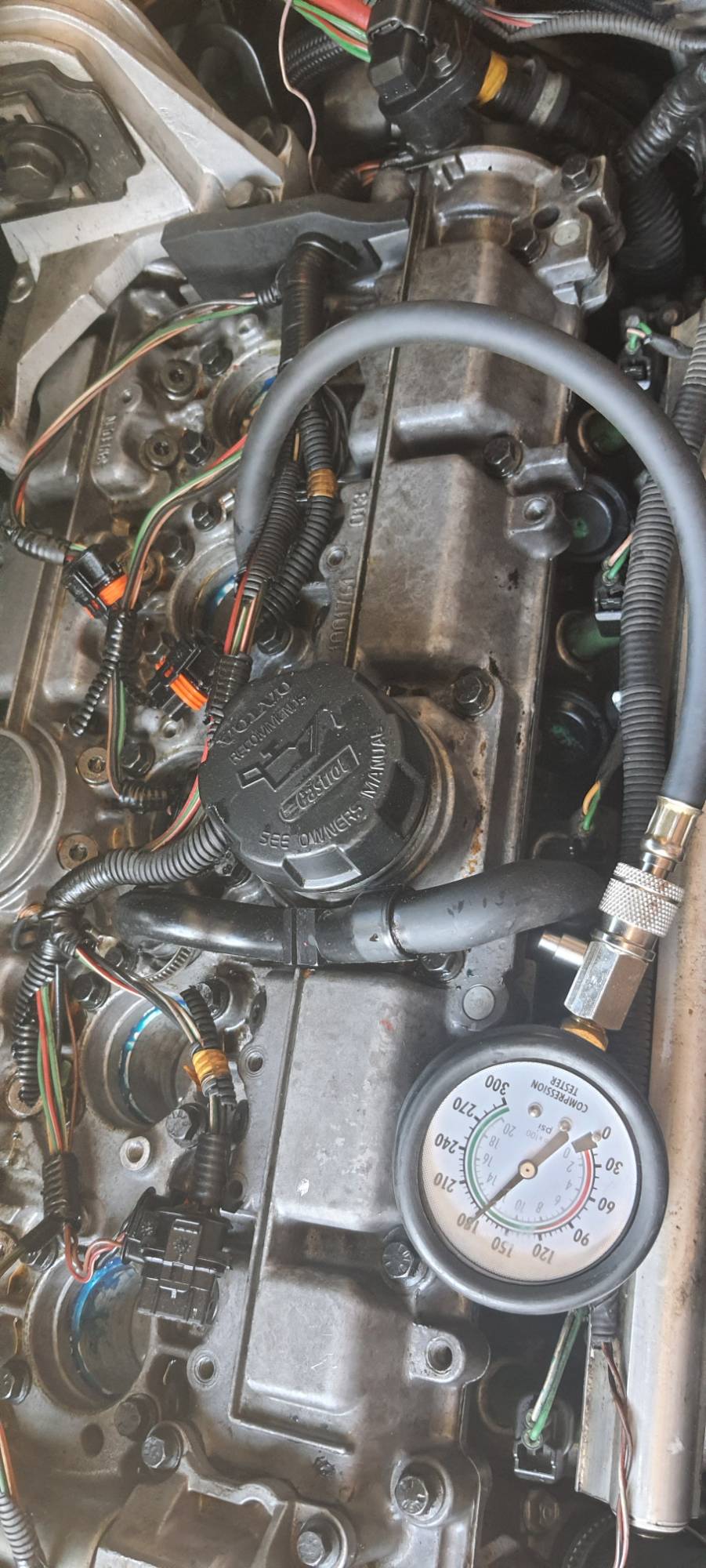

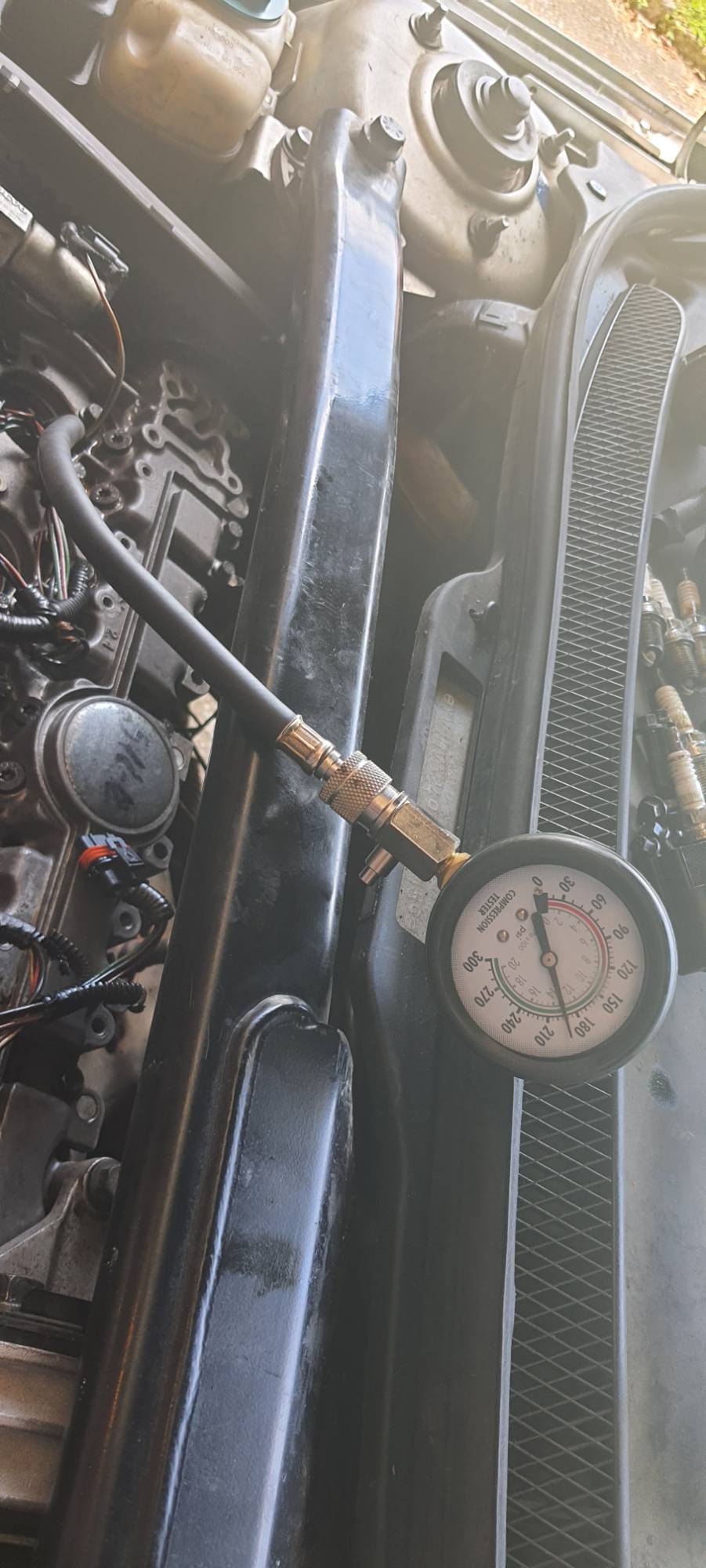

Here are the results of the compression test. Almost all cylinders are 180 psi, except cylinder 1 surprisingly being 190 psi, which is a 5 percent difference.
Cylinder 1 and 2 were the ones where I had measured warpage of 0.05mm.
I still find the compression a tad bit lower, cause before I did all of this work, the compression was as follows viewtopic.php?p=608107#p608107
Since then obviously the head was machined 0.14mm, which should have increased the compression slightly, new valve seals etc so the head should have sealed better. Or perhaps what I had measured before was with a leaky head and so oil was in the cylinders sealing them better?
In any case, I have no real way to measure just how much pressure is in the coolant system, beyond the normal I mean.

180-190 pounds is fine
