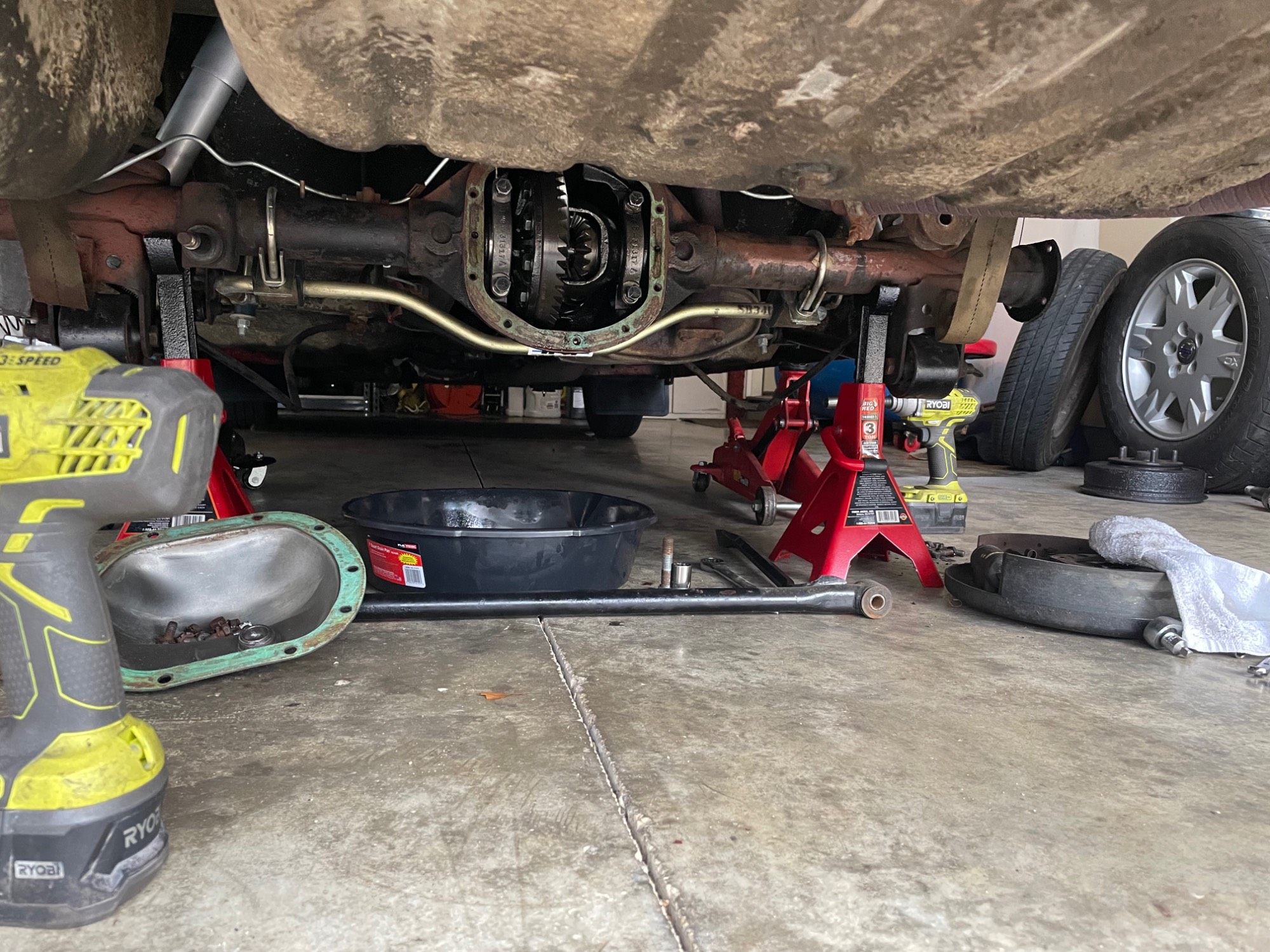

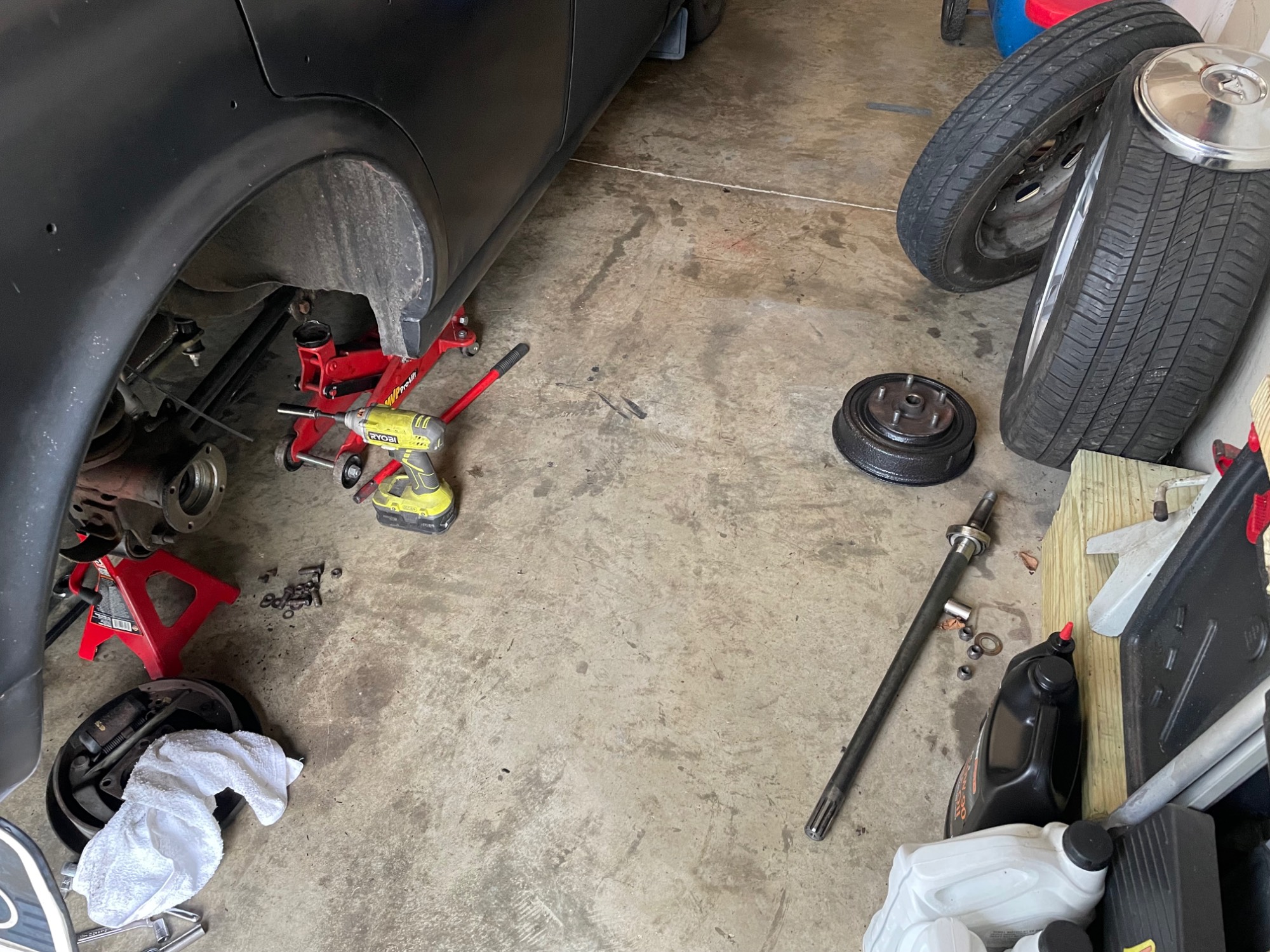

I had a clicking noise coming from the differential. I took apart the diff carrier assembly and noticed that the thrust washers for the side gears (axle gears) were warped. I replaced those thrust washers and the ones for the smaller planetary gears, along with the larger pivot pin. I spider gears are still a little loose from wear, but now move smoothly without clicking. Those parts are basically the only ones you can get anymore.

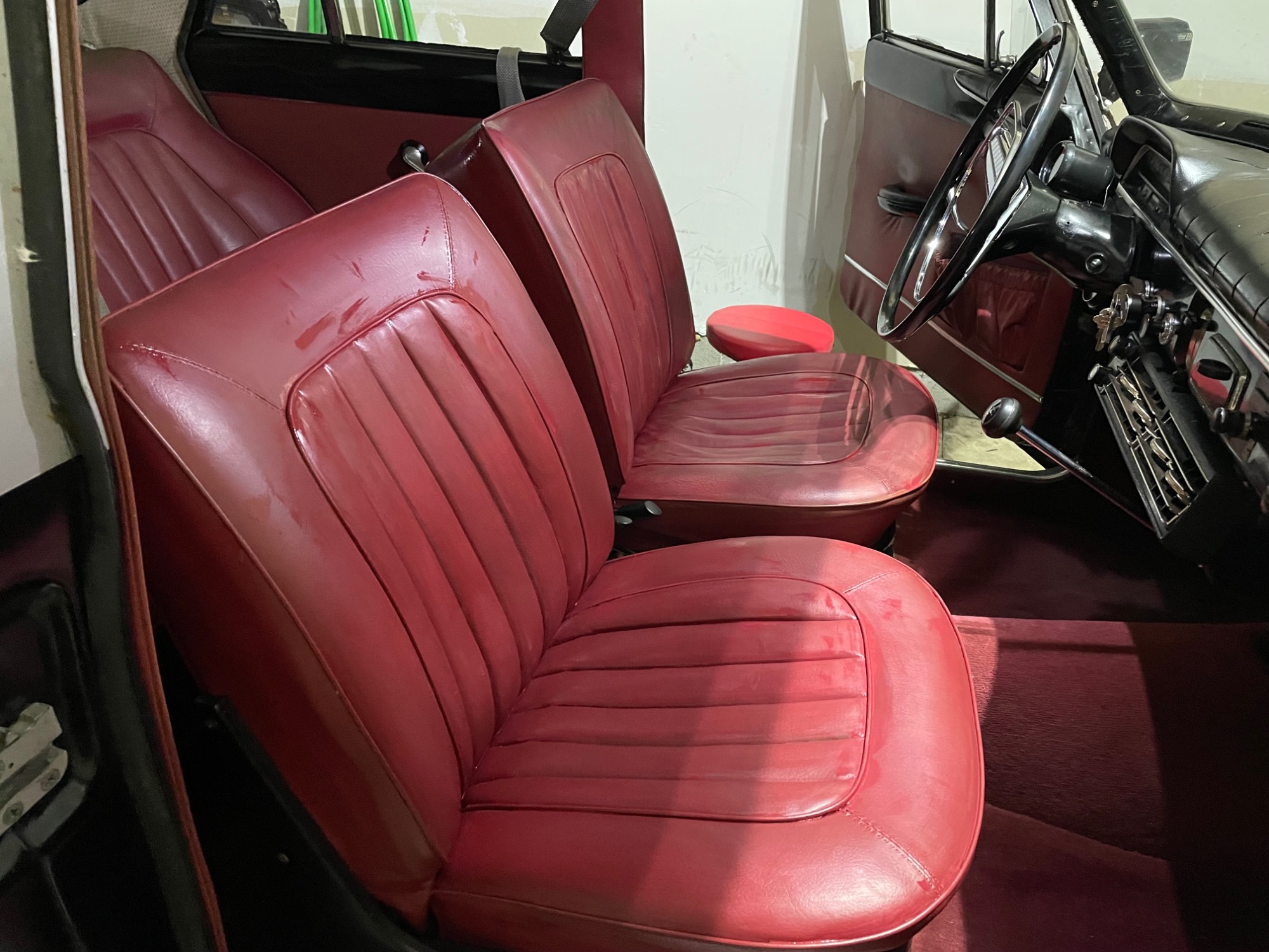

I just started working on dyeing the interior. It’s in decent shape and see no need in spending 1600 bucks to replace it when there are other things of need I could throw money at. Anyway, I could not get a Volvo red dye so I had to go with the closest I could find, which is a Jaguar Mars Red. I’ve only started on the front seats and it’s surprisingly close in color.

I bought enough dye to do the whole car. I’ve done the rear seat now. I took the door cards off to dye them and re-do the cards themselves. I found Leo’s signature and date that I’m assuming is when he made new door panels.
