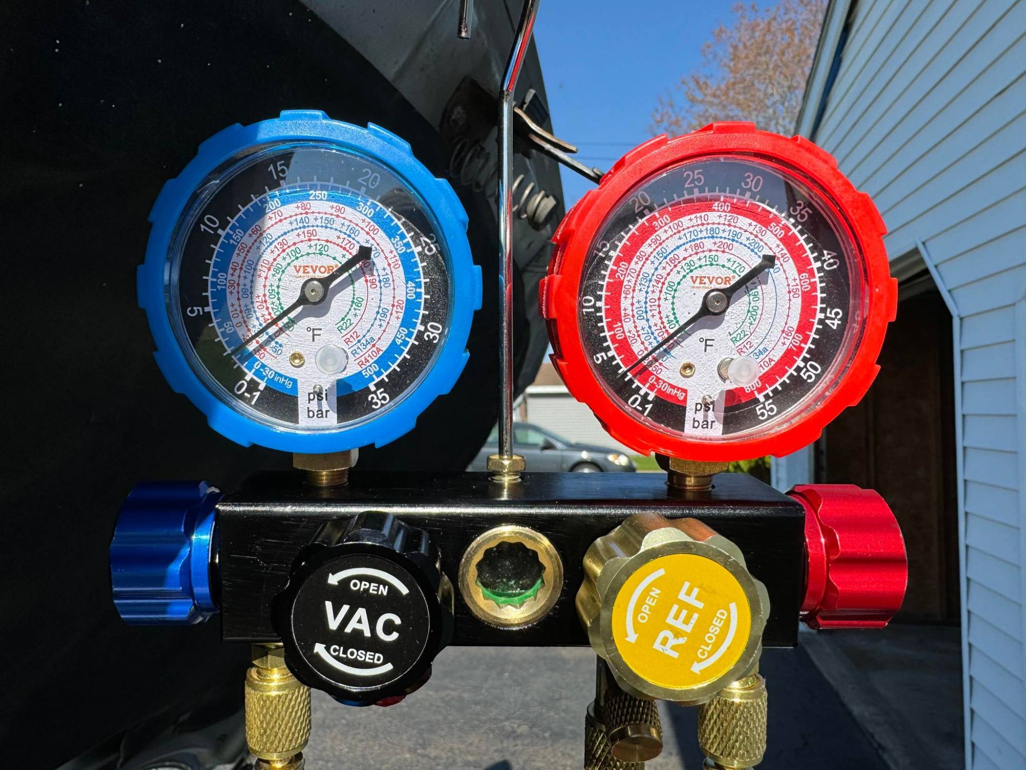

I just tried letting some pressure out before starting the car to be safe, then started it with the AC running and continued to let some out until the low side went under 40PSI. Now I'm getting basically no cooling on either side. Drivers is hot and passengers is pretty warm. High side pressure is way too low too.

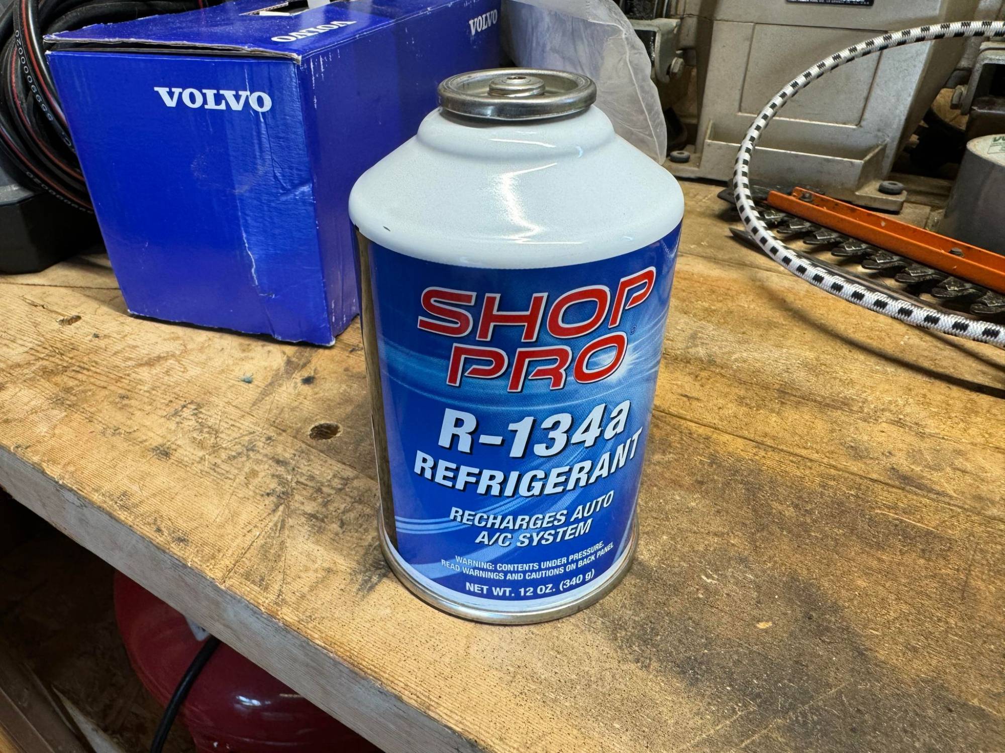

Photos of current gauge readings at 73F and 30% humidity, and the R134 that I'm using.
Will recheck once I have my scan tool shortly.
07 S60 AC Help - Hot air/cycling compressor

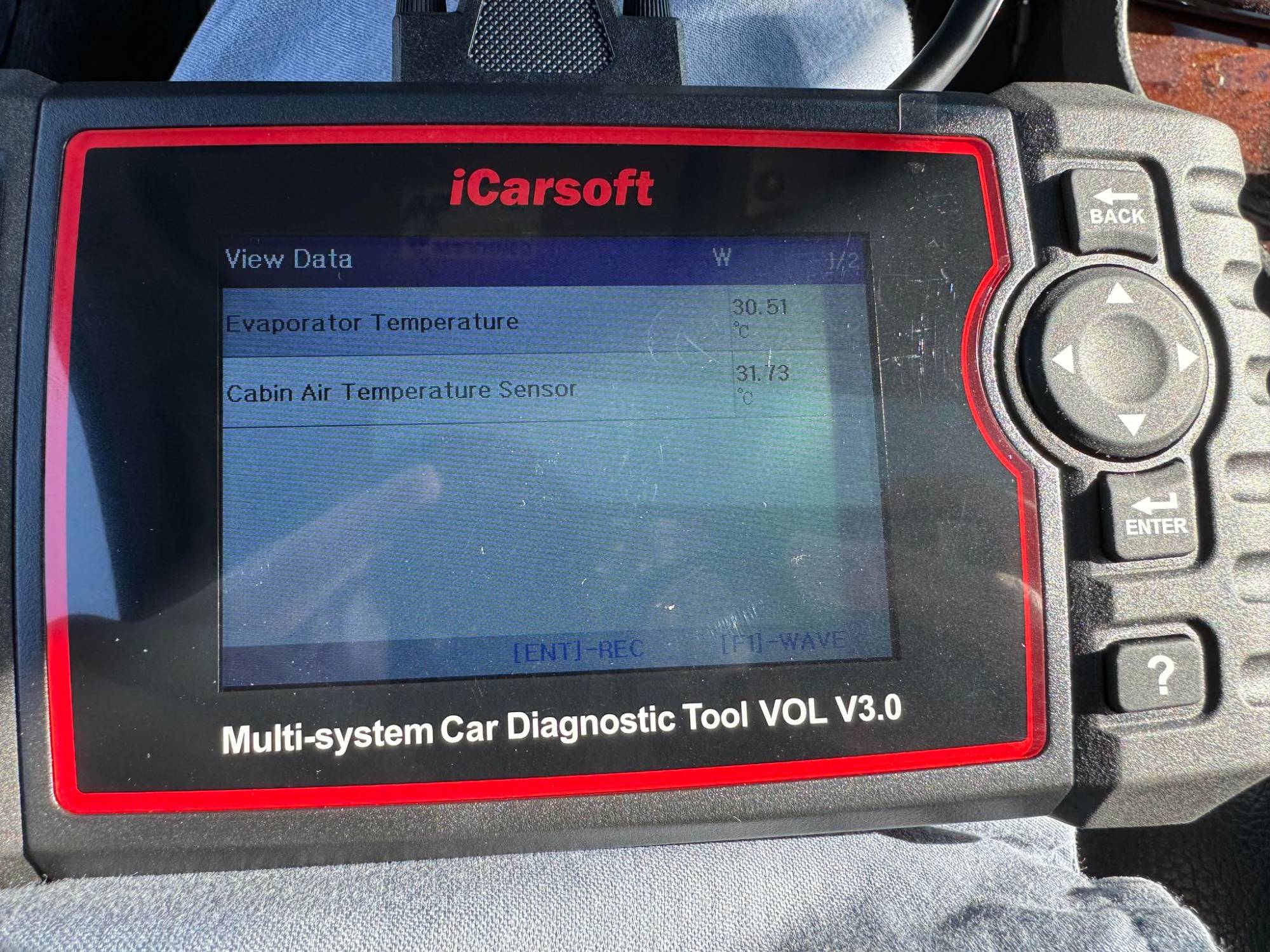

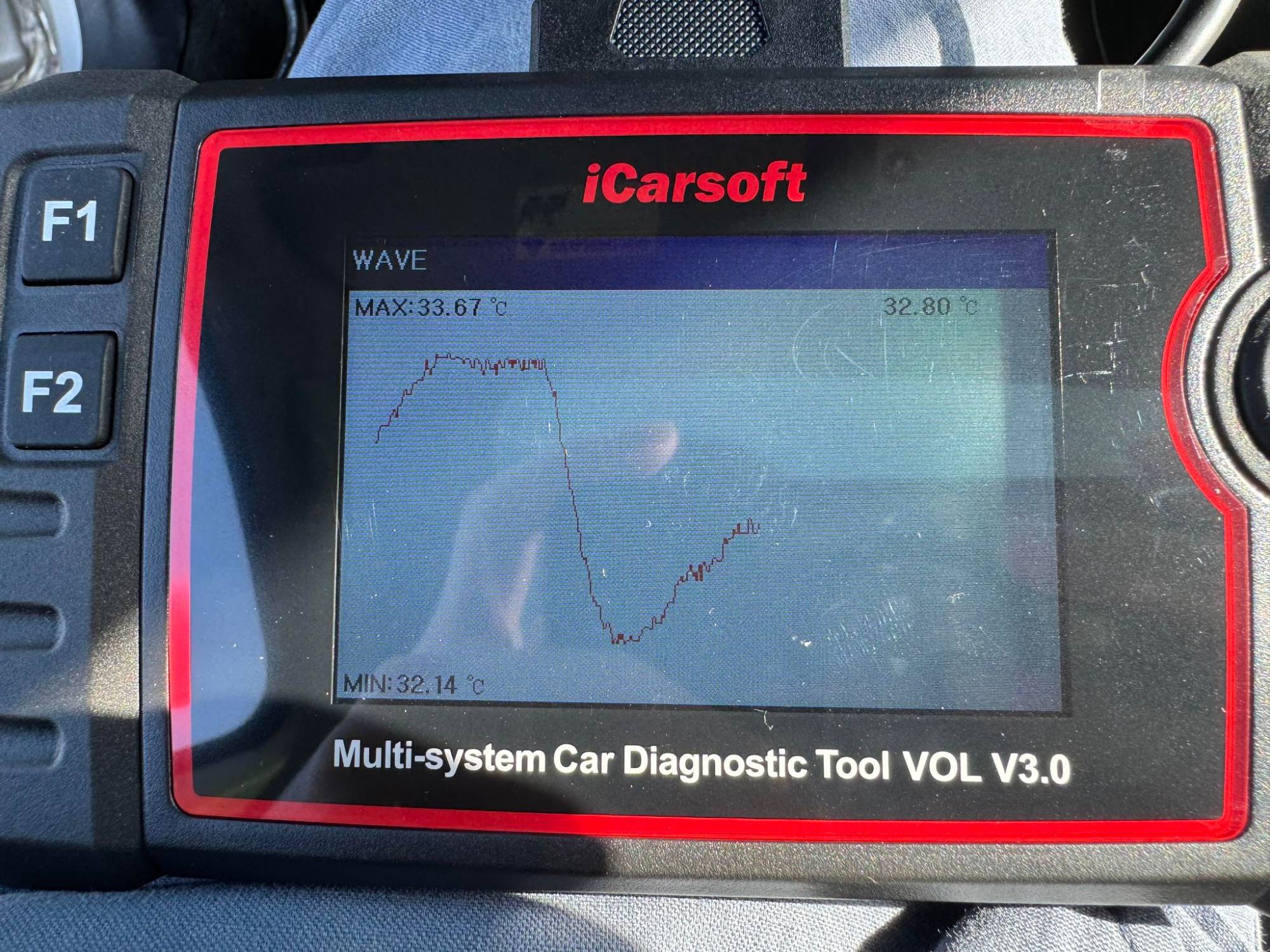

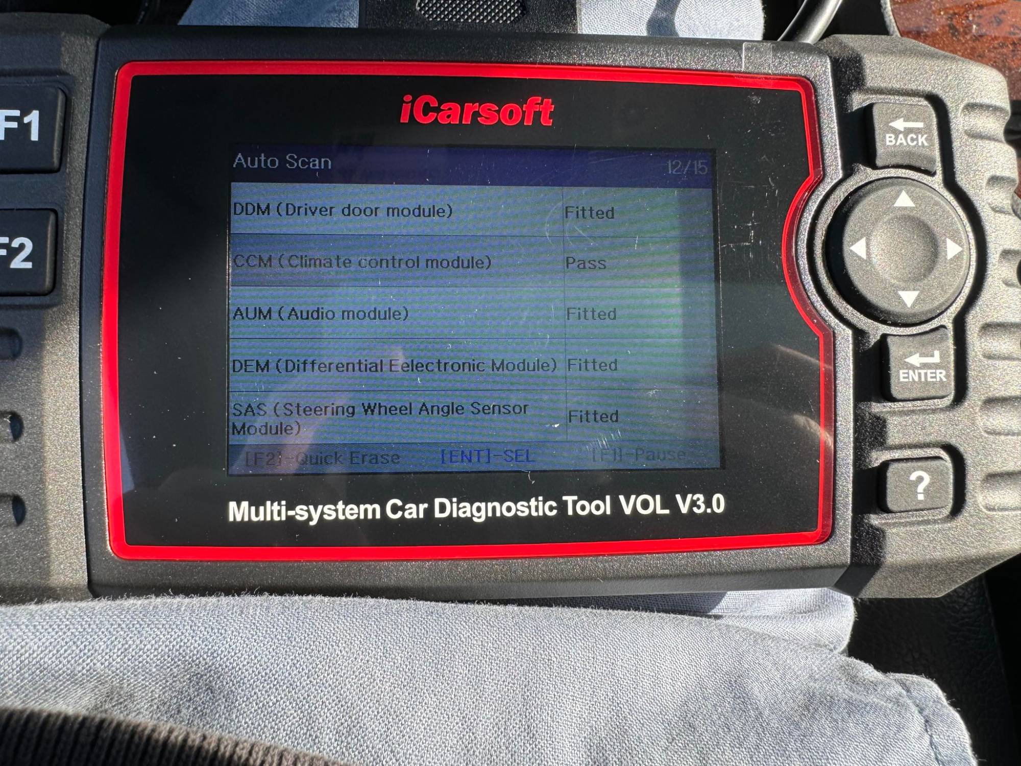

Got access to my scan tool finally, but unfortunately it doesn't read the pressure switches. I assume this would be under the CCM? Because I can read that entire module and others, but I didn't see anything about AC pressures or switches.
I can see evap and cabin air temps, both of which look to be reporting normal. When I first start the AC system, evap temp drops a little bit to 27C, but will climb up to 32C or even higher than cabin temp after a bit, which is exactly what it feels like coming out of the vent. Cold on passengers and then hot after a little bit with the above pictured pressures.. I won't add anything more to the system until we get somewhere with this info.
In the wave graph photo, from the start AC was turned on. Turned it off for the flat spot and then turned it back on. You see it drop a little bit in temp but then go right back up.

I found the pressure data under live data in ECM on my scanner (Foxwell Scanner). Should be buried somewhere in there as even VOLFCR did it for my 1998 V70. Not sure where icarsoft keeps it.
Seems like how my system ran when undercharged. Is your compressor cycling when this data was captured (I am assuming it was).

Checked the scan tool and it does show AC pressure, along with some other items. Video below showing activity with the same charge as previously stated.

So what we have, if i read correctly is the following:
Low side pressure should be around 40psi which is correct for R134A at this temperature
High side pre-compressor activation is around 700-900kpa which appears to be normal for the given temperature.
High side post-compressor activation is <200kpa which appears to be extremely low, and is a problem.
So we have low pressure normal, high pressure low situation.
The car is making the call for the compressor to activate according to your code scanner, so that is good.
We know the CCM is not blocked by a code and is attempting to activate.
By feel you say that the sides are somewhat cold at the start and then heat up.
Your EVAP is not iced up as the temperature sensor (if correct) is leaps and bounds above freezing (in your previous post).
Your car also doesnt get cold enough to cause rapid ice up based on what we have read.
I am hesitant to say its a blockage as you get partial performance and have replaced multiple lines. It is possible so id recommend another test as linked at the bottom. I dont know if a feel test will work in our cars.
You are also able to get some cold which means it is partially functional, but not optimal. Therefore it cannot be a full system blockage. Your car holds charge so no leaks.
If i had to guess based on this then it seems to coincide with a poorly compressor.

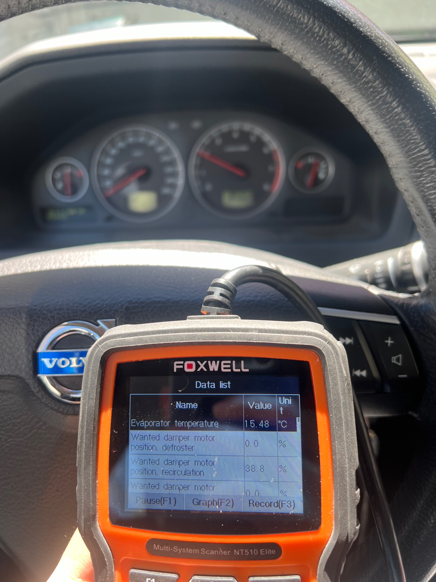

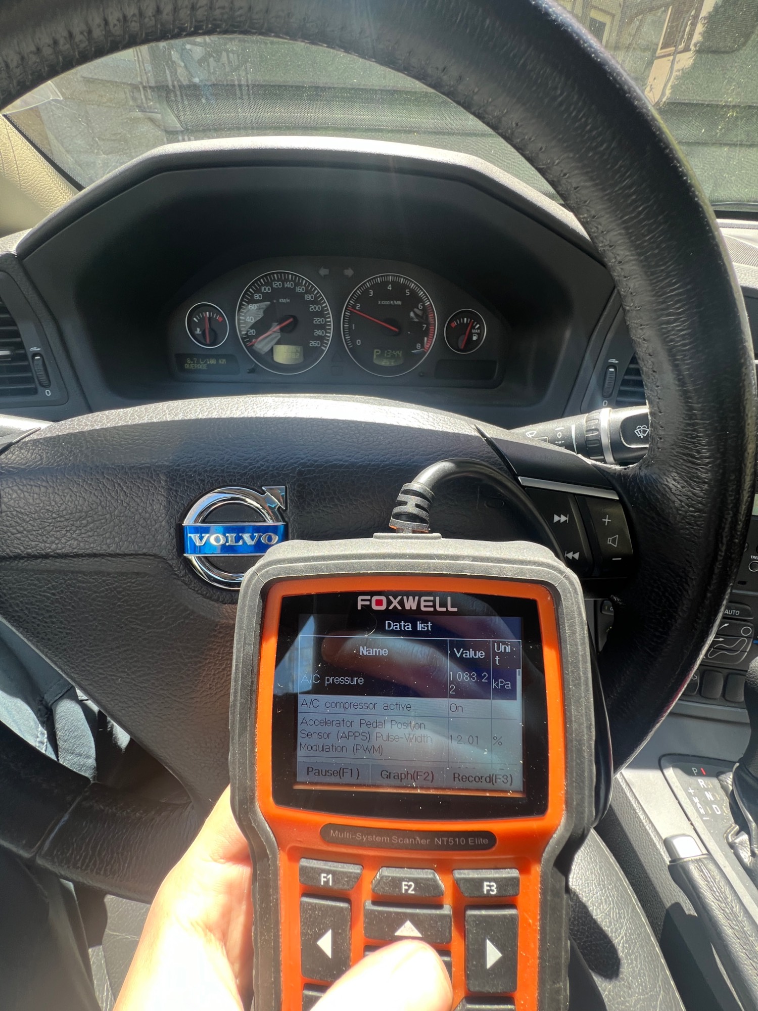

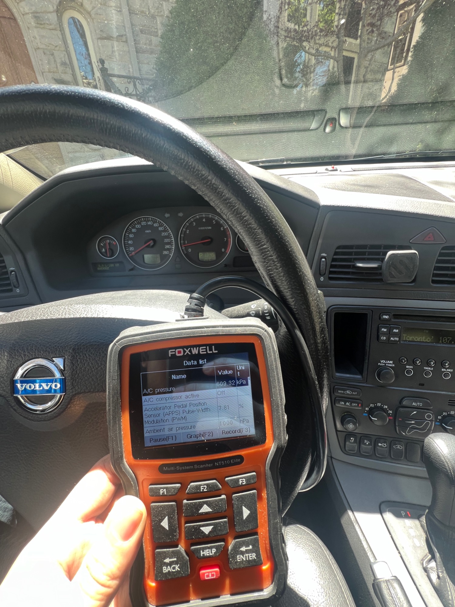

Here is my data for a 25c day.
One shows the ac off at 693kpa
One shows ac on at 1500rpm with 1033kpa
One shows evap temps sub 10c with 1500rpm and ac on. The first photo I took was when I just turned on the ac.
