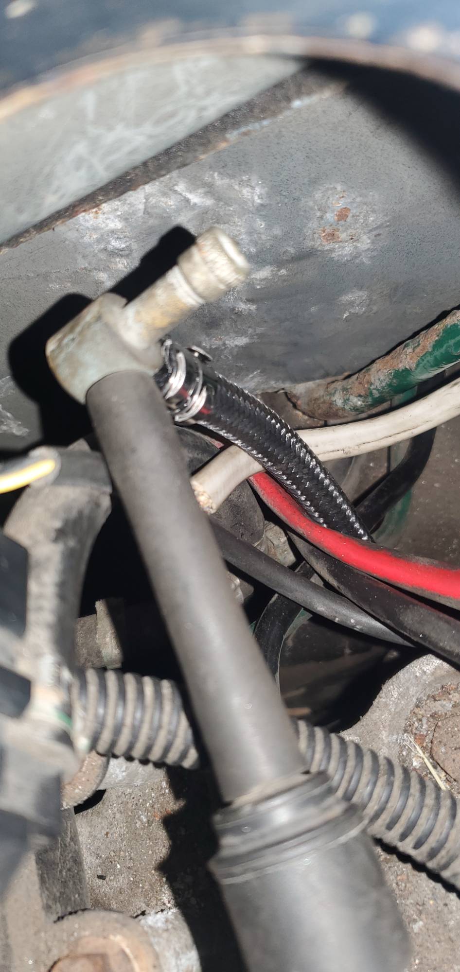

I'm definitely keeping that info for later, but I got the repair hose in by prying the tank down and pulling it up from the top using fish tape. Very short section of 150 psi nylon braided fuel injection hose, double oetiker clamped onto a 5/16 barb compression fitting on the steel tube from the fuel pump.abscate wrote: 06 Oct 2023, 20:22 I ended up,with about 36 inches of extensions to get one of them on the Kat
I was actually only test fitting it when it fell into place, I was expecting to need to cut a lot more steel pipe off to be able to get the repair back into place, and I forgot to take a picture of it before it went in. I covered the pipe in por15, and placed a piece of foam over the compression fitting and oetiker clamps so they wouldn't rub on anything. Now that the car is running, and so far no leaks, I'm on to the engine clacking..... It's almost impossible to diagnose tapping, knocking, clicking noises over the internet, they all sound the same.

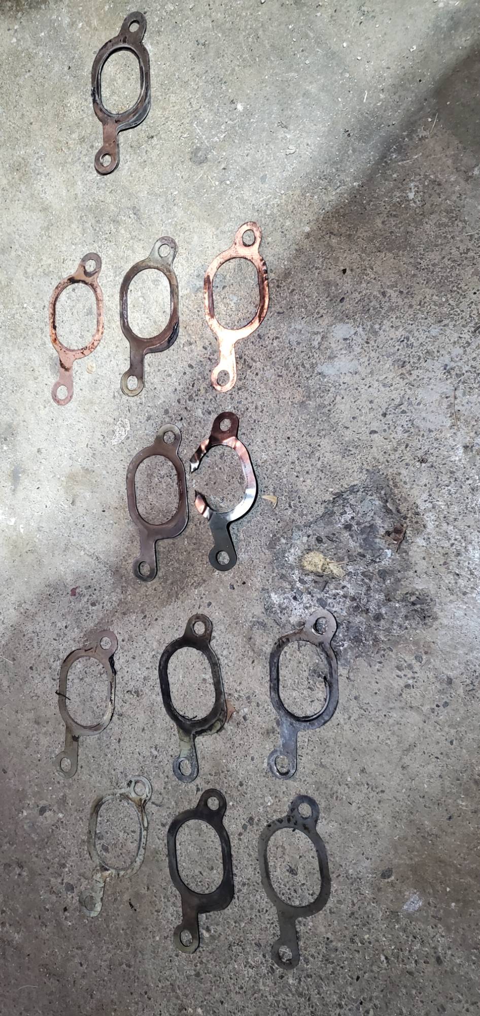

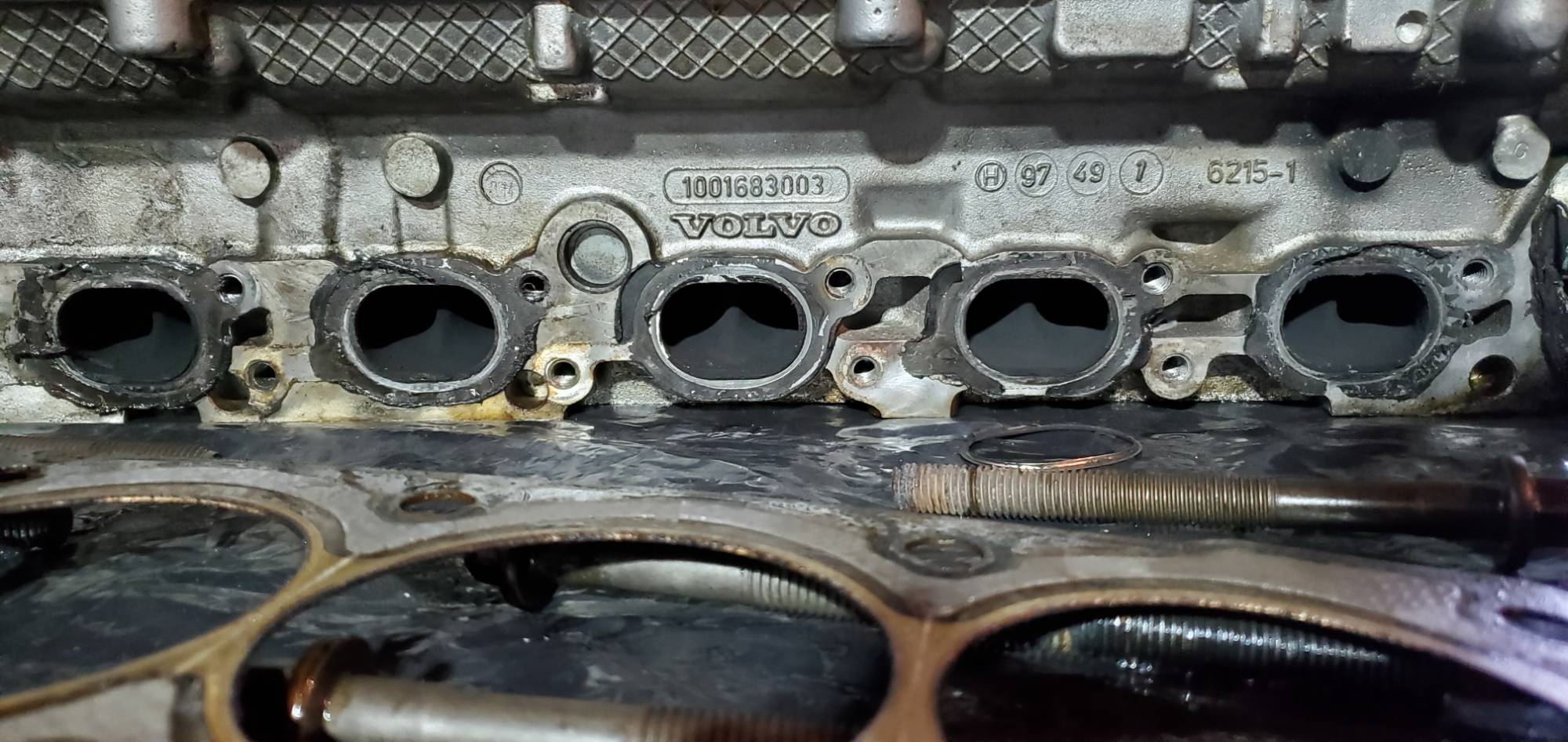

Took the exhaust manifold off and pulled the gaskets out and found one broken piece.
This could have also been from me having to really work and twist to get them out due to the RTV that was liberally applied to keep them stuck on the head during installation.
I thought it was odd but not impossible that the gaskets would be changed on a car with 155k miles, but finding these heat tabs show it was a replacement engine, or at least a replacement head.

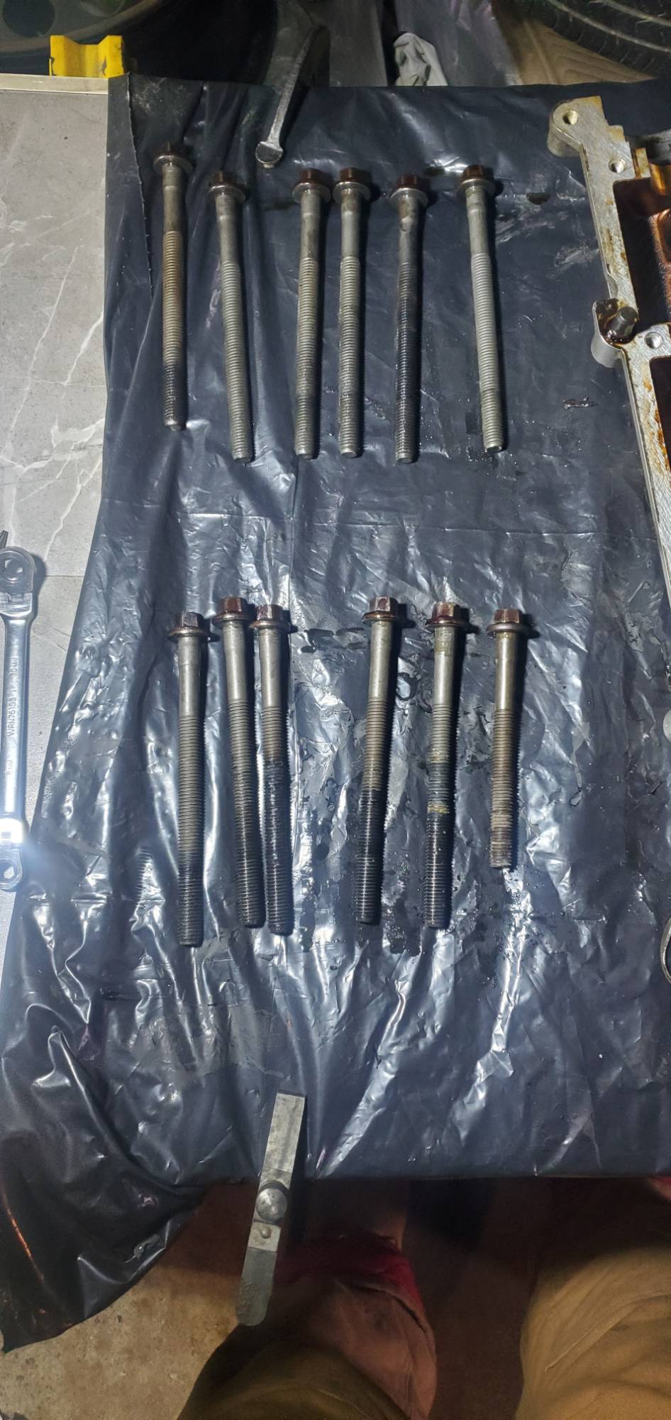

So not wanting to get into removing the manifold from the car and dealing with exhaust and turbo flange bolts I decided to take the head out and also deal with the oil burning and smoke problem that I think is the valve stem seals.

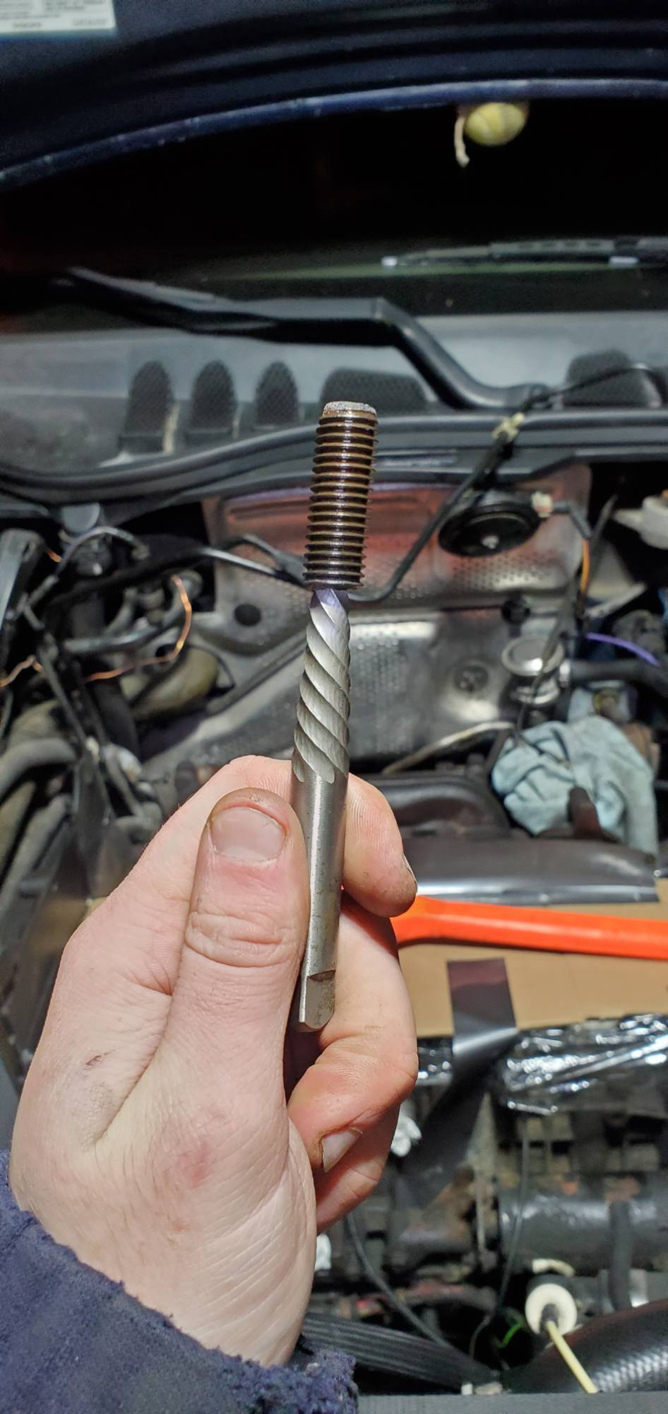

Of course nothing is straightforward on this car so I ran into an issue and snapped one of the head bolts. It broke after it cracked loose once, and then before the second crack loose it snapped right at where the threads in the block start. Reason I thought it was valve stem seals is that I stuck a bore scope into all the cylinders, and in cylinder 2 there was what looked like oil drops right under the exhaust valves, which had been sitting open in this cylinder.
So for now I have PBlaster soaking in the bolt hole and I'm planning on finding some tube that sits in the bolt hole tightly and holds a drill bit nice and straight.
