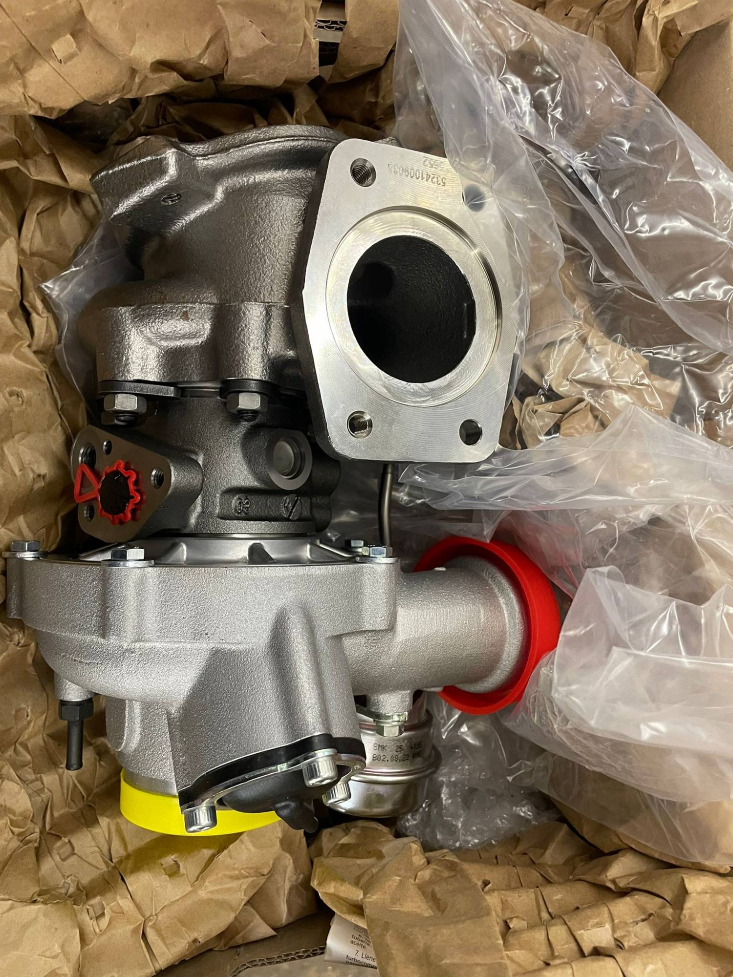

after a long chase, i hunted down a new Turbo.
After approx 250k km my red brick has earned a new one.
Since there are some uncertainties aboout the old Turbski, i'll chase this fault further once i got it installed.
i need to check when there is enough time (and beer) to disassemble half of my R to change it.
Further i am in touch with a suisse company here in Hamburg to check if the cracked housing is repairable.

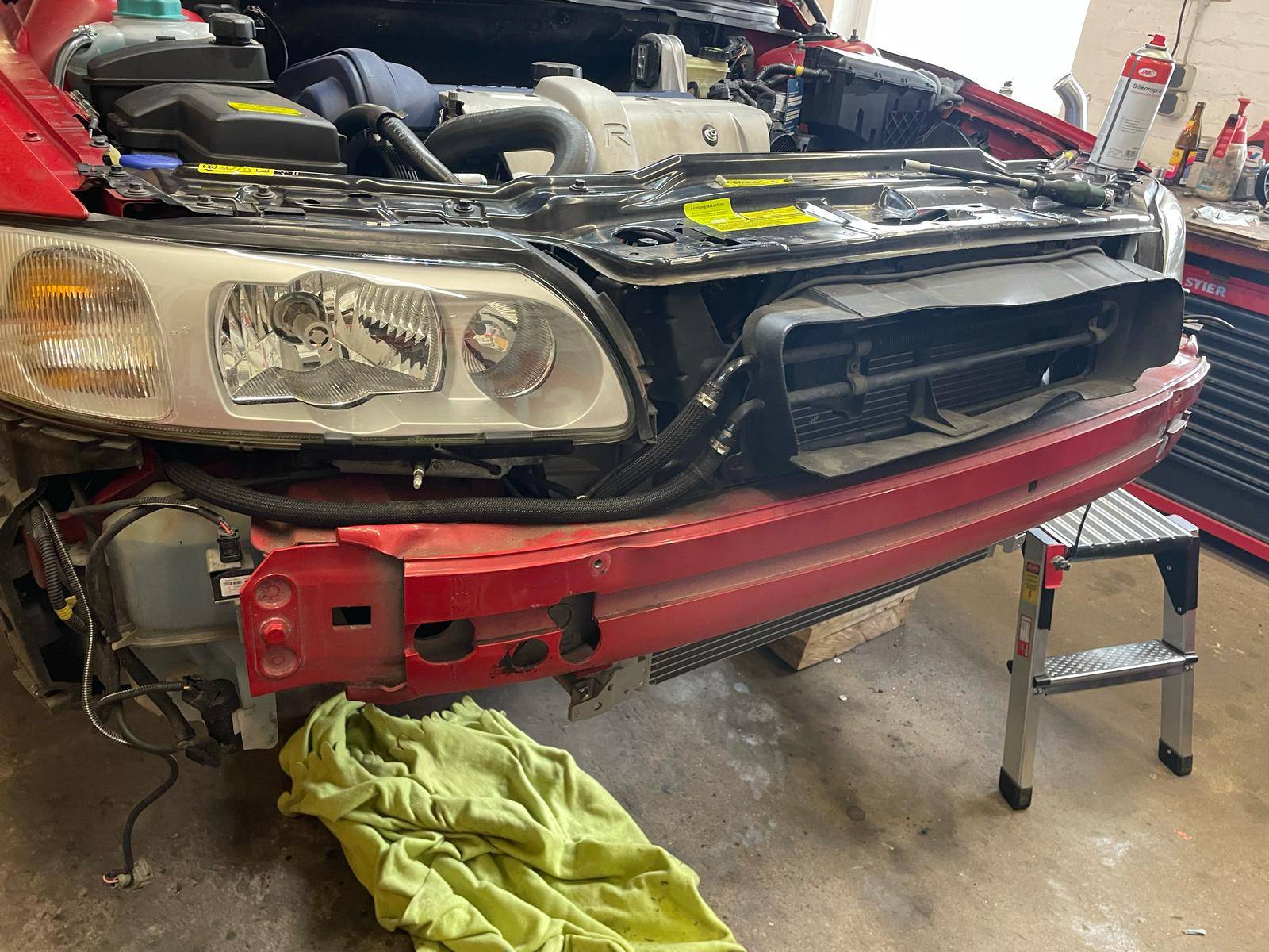

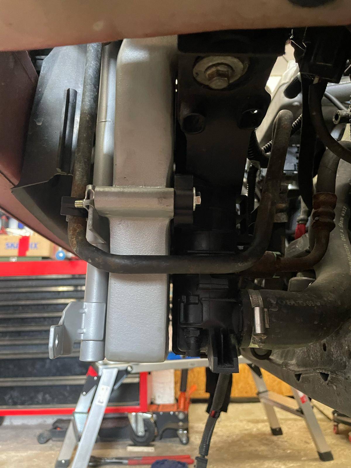

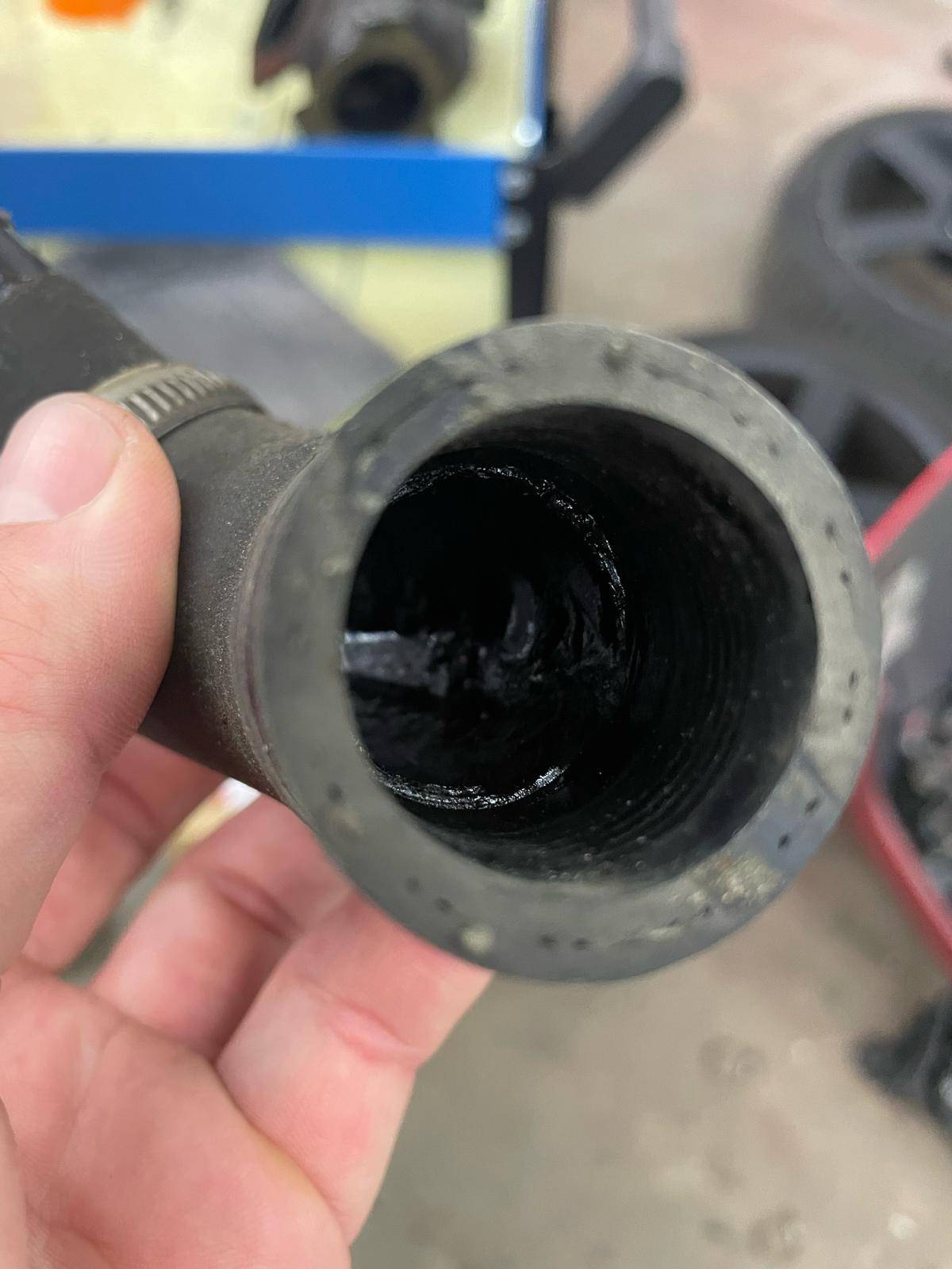

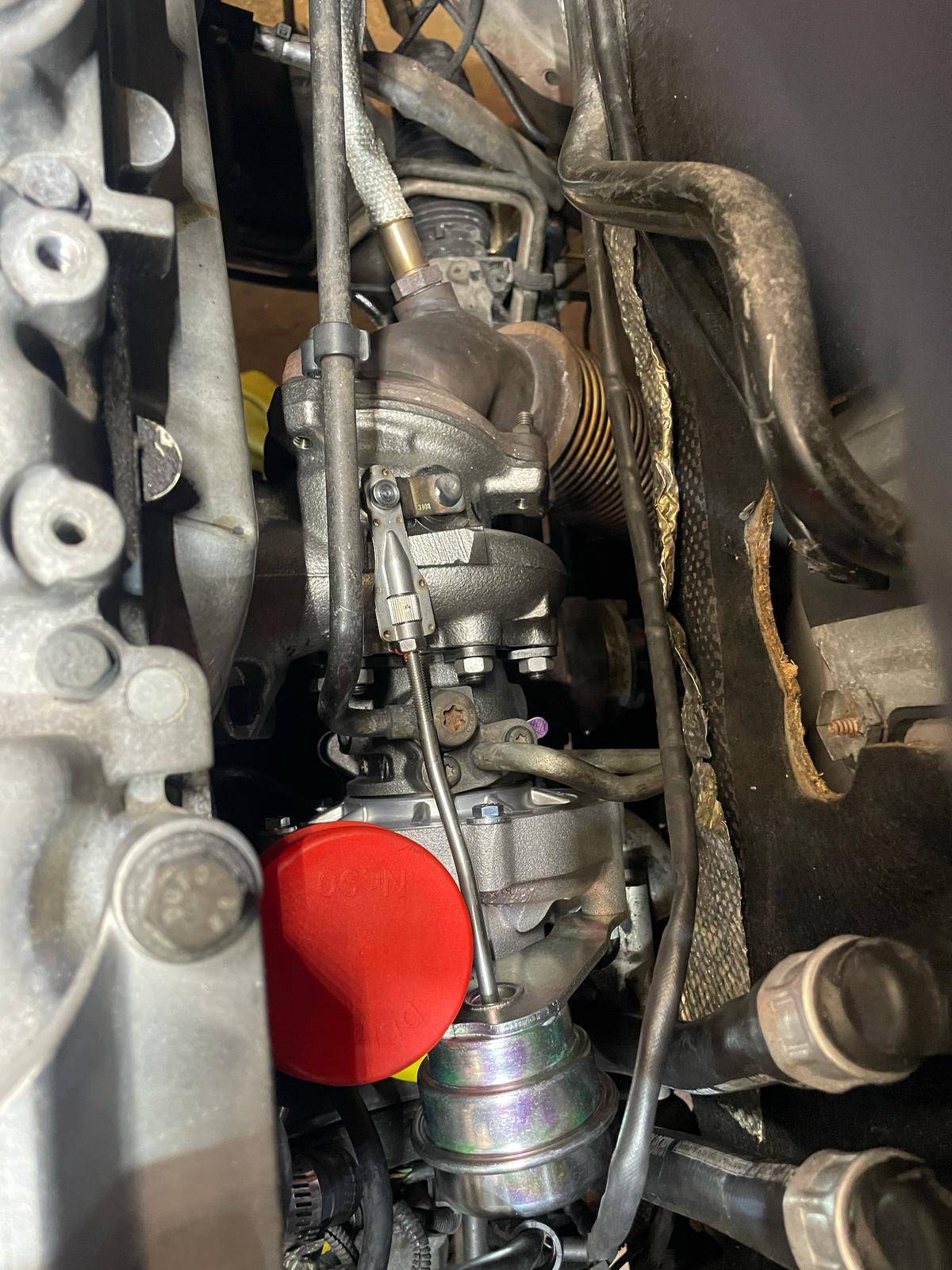

After a nice weekend of wrenching the Turbo is installed.
A new intercooler from do88 followed him in my R. You can see the hose for the aux intercooler is pretty plugged.
Since im "already here" i'll straighten some other flaws and do the haldex service.
