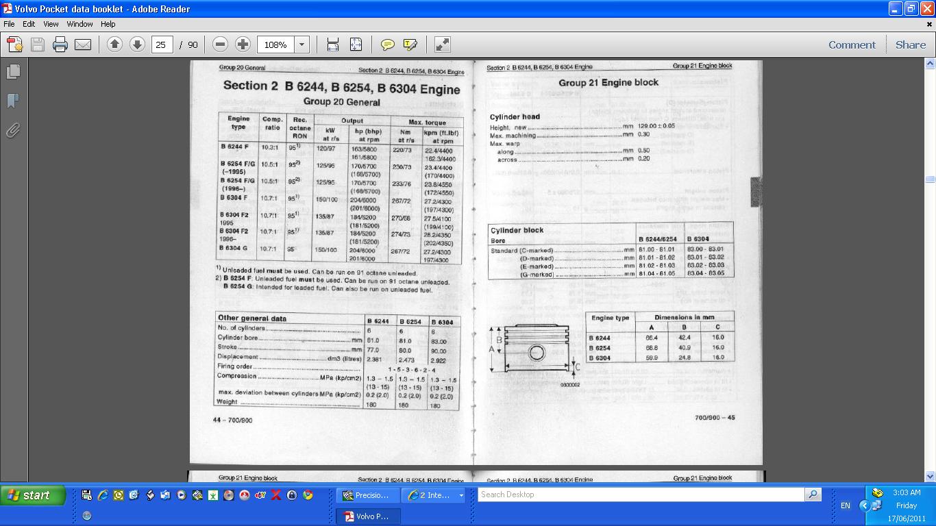

You may need to find a conversion table to psi but this is about as specific a compression specification I have found for the 960; also applies to any other Volvo whiteblock motor with 10.7:1 ratio and same bore and stroke such as the B5254.
