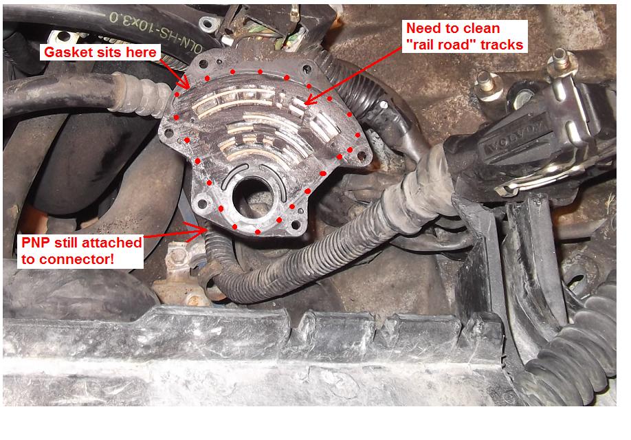

I will add some photos hoping to help someone.
1. Note during removal, the bolts for the shift cable are centered in the oval slots.
If you pay attention to this, there will be no need to adjust the shifter cable later.
(But you need to check the shifter later anyway to be sure P is P, R is R, D is D etc.).
2. Note that I left the PNP attached to its connector.
One less step to worry about.
Note the gasket, do NOT lose it!

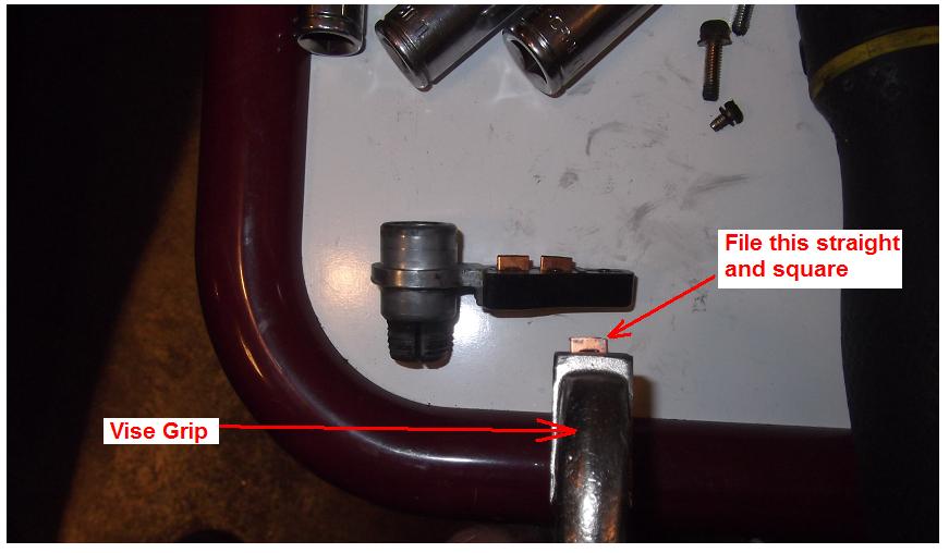

3. Note that the copper U-clip is mounted on a vise-grip to be filed straight and square.
