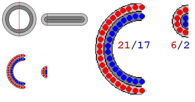

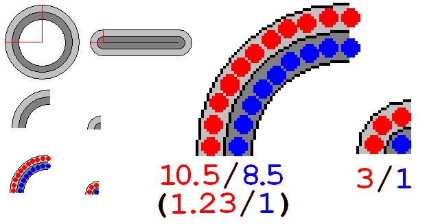

I would never clamp a brake hose that I intended to use. If it was a hose I was going to cut and toss before the vehicle ever came off the stand, sure, but I would NOT intentionally introduce sharp radius bends in to a vital piece of safety equipment (no different than not letting a caliper hang by the hose, IMHO) merely to avoid loosing some $8 brake fluid. The risk-vs.-benefit is not viable for me.
To give some idea of what happens, look at happens when a section of hose (left) is clamped (right). Both have the same circumference for the I.D. of the inner hose and thickness for the inner and outer. By clamping it the outer has to span almost two and a half times that of the inner (3/1.23) which means the inner gets compressed while the outer is stretched. This is why folding or pinching garden hoses kills the so easily and leads to leaks at the points of most concentrated flex, but they do not have to stop a 3,000 lb vehicle.
Neither I nor any brake hose will last forever, but that doesn't mean I care to hasten either's destiny!

cn90 wrote:2. Bending the garden hose is a bad idea because it introduces a 180-degree (not 90-degree) bend.
That's confusing a longitudinal bend with a radial one. Review the picture. The 90 degree is the sample but it making the hose wall go through a zero-radius 180-turn (90+90=180), and the ratio is the same.
21 / 17 = 10.5 / 8.5, and 6 / 2 = 3 / 1. Nothing's changed.

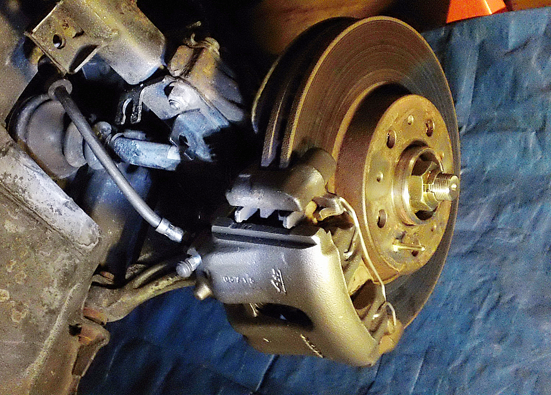

I stripped the 7mm guide pin last night, it was the last pin to come off, now rounded. It was time to close the day.
Before calling off the day, I left it with PB blaster. I will slice off and remove the rubber cushion, propane torch the bracket for a minute where pin is screwed, and then put a vise-grip to it after filing the teeth on vise-grip.
It has 22 ft-lb torque, not sure about the thread locker, visible rust.
I do have rotary cutting tool at hand, if civil method fails.
xHeart
Posts: 3321
Joined: 03 Dec 2011, 08:05
Year and Model: 2.0/3.2
Location: Great Lakes - USA
Has thanked: 116 times
Been thanked: 119 times
Post by xHeart »
The removal of caliper from the rubber hose, after it breaks loose, requires close to 6 full rotation of caliper for it to come off, and screwed back on without twisting the hose, and for the rubber hose to keep its arch like form.
The vise-grip worked on the guide pin.
stripped 7mm guide pin removal with vise-grip
xHeart
Posts: 3321
Post by xHeart »
Two photos after the caliper replacement, rubber hoses...
driver's rubber hose 1/4 turn over twisted
passenger's rubber hose arch is good
