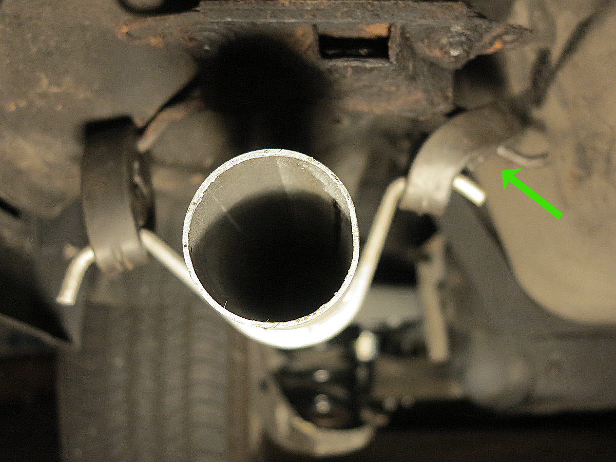

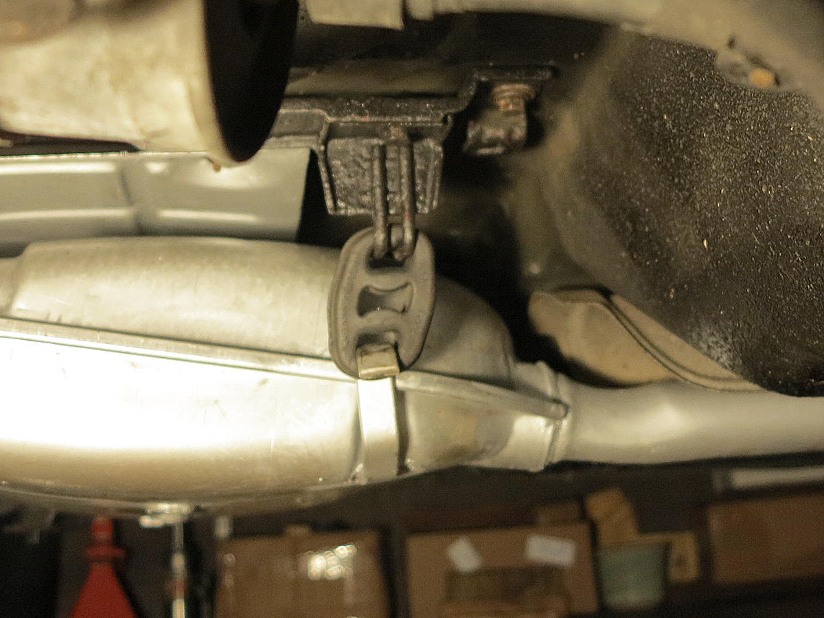

Shackles appear crooked at hangers.

I will drive it as-is this week.
Undo the connection over the weekend, and let the muffler hang free over the shackles.

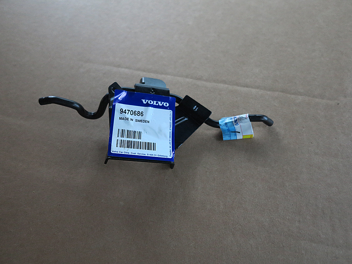

Volvo parts says, it may need new bracket.
So I have one now.
So I have one now.

Removed the two piece muffler hanger bracket and replaced with new one piece design bracket.
The exhaust tail is straight and center.
The ball-joint connector size and fitment is unchanged.
