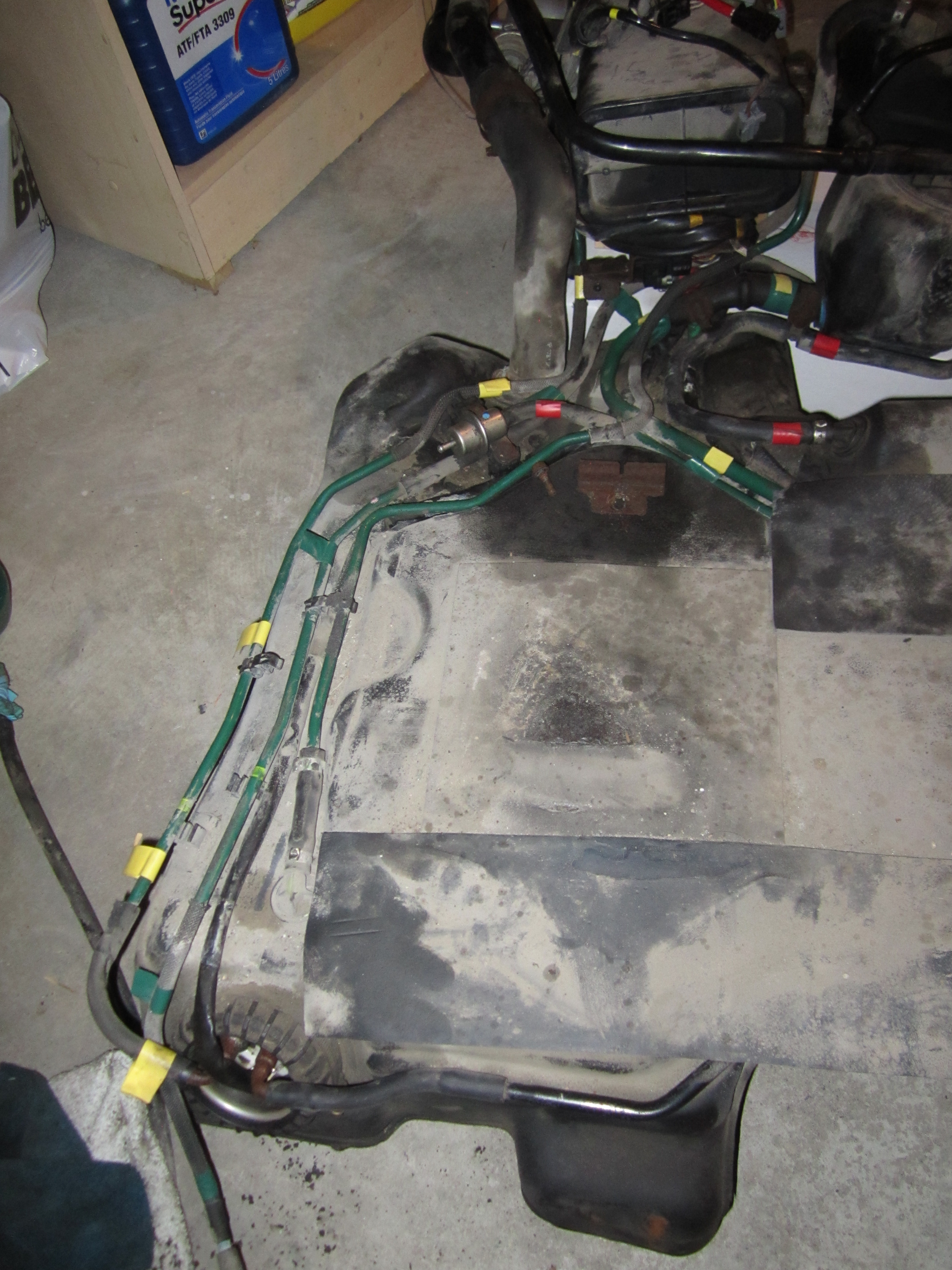

There is a fuel pressure regulator, but I'd need to see where it is on a 98. On the 2000 it is on top of the fuels tank on the RHS just in front of the right rear wheel. Small silver can with an input and output. Mounts on top of a block that the main fuel pipe runs through.
The small silver can is about half way up photo with a red tape flag to the right of it.
