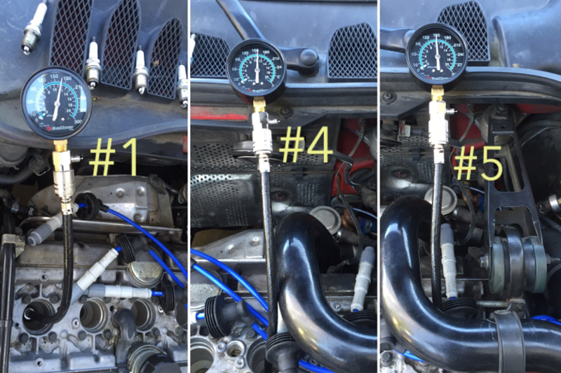

This weekend I took the next step. I performed a compression test on the car. Here's what I saw.
#1 = 170
#2 = 162
#3 = 160
#4 = 156
#5 = 150
So there is definitely a variance in the the compression with #1 being the highest, but is it enough to cause a misfire? What do you think? With #4 also a bit lower, why doesn't it ever throw a code? I expected to see more variance in #5.

#1 = 170
#2 = 162
#3 = 160
#4 = 156
#5 = 150
