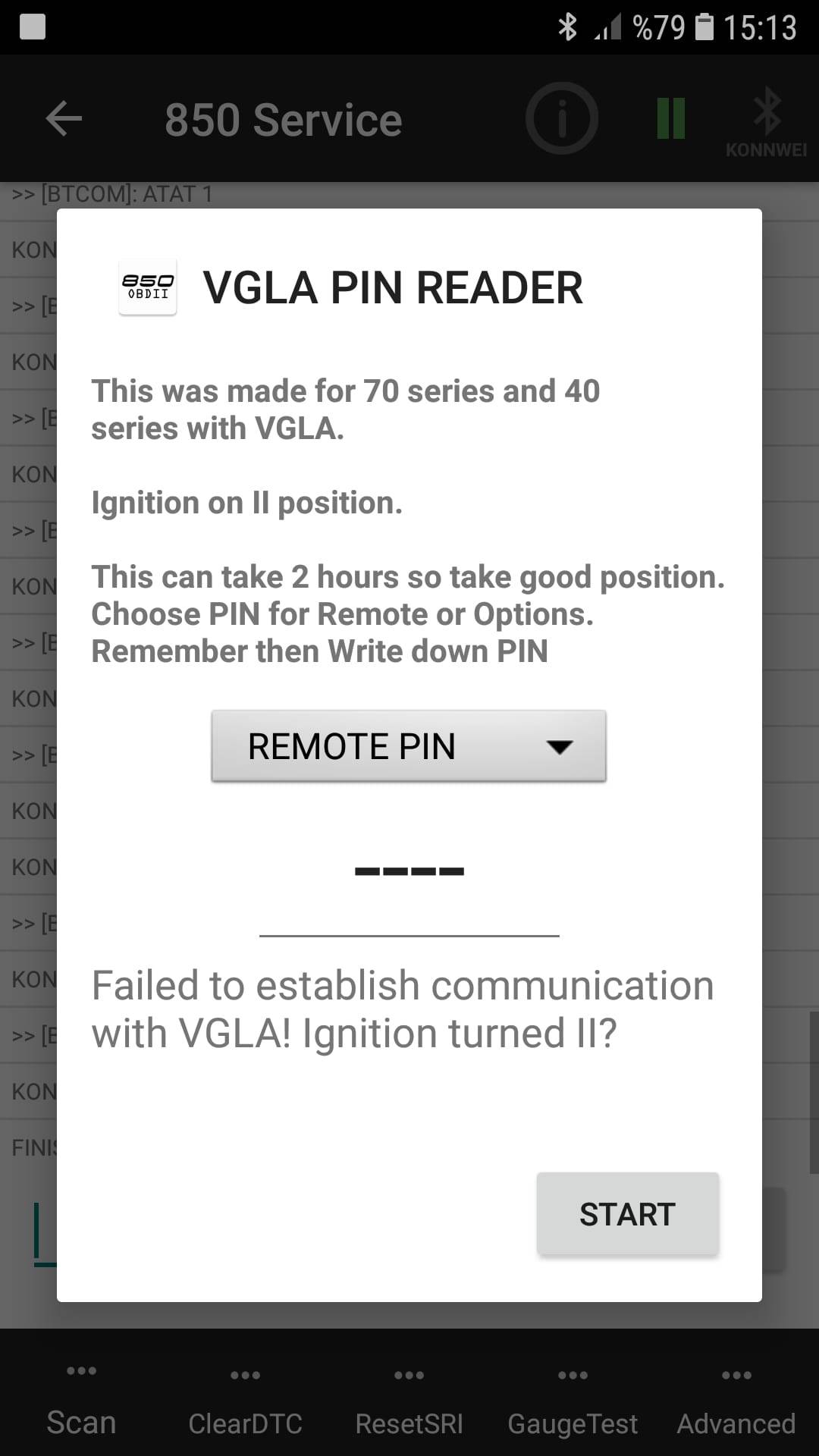

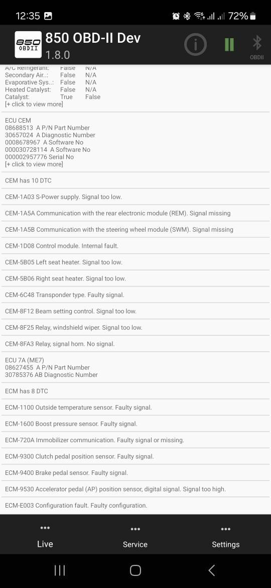

Hello;
I first installed the application for the VGLA module (adding remote control), but I could not benefit from most of its features. First, I received information that the version of my ELM 327 device was not supported. Then I bought a new ELM 327 V1.5 device and tried it. This time, I received different errors. For example, the dashboard test, fuel I could not get any results from pump test or VGLA PIN decoding. Actually, I got live data and error codes, but I couldn't understand exactly where I see the result. For example, I am testing the SRS system, but I cannot see where the error codes are.
On the VGLA PIN screen, for example, when performing operations from the bottom, the ABS lamp flashes, then it clears up, but it gives a warning even though the ignition is in position 2.
I am sharing with you the screenshots I took as an example. If anyone has information on the subject or has a document about the program, I would be very pleased.

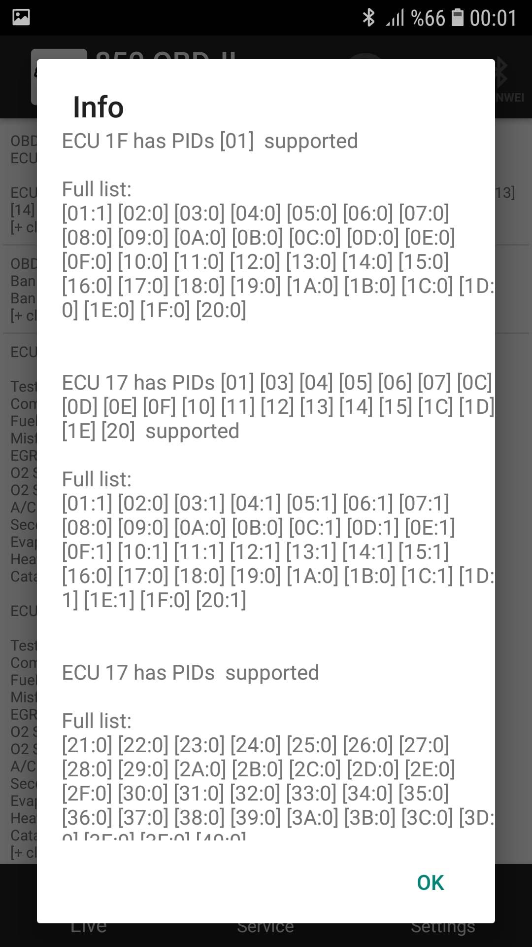

esl_97_850_T5
- Posts: 271
- Joined: 19 Jun 2012, 10:53
- Location: Knoxville, TN
- Has thanked: 18 times
- Been thanked: 27 times

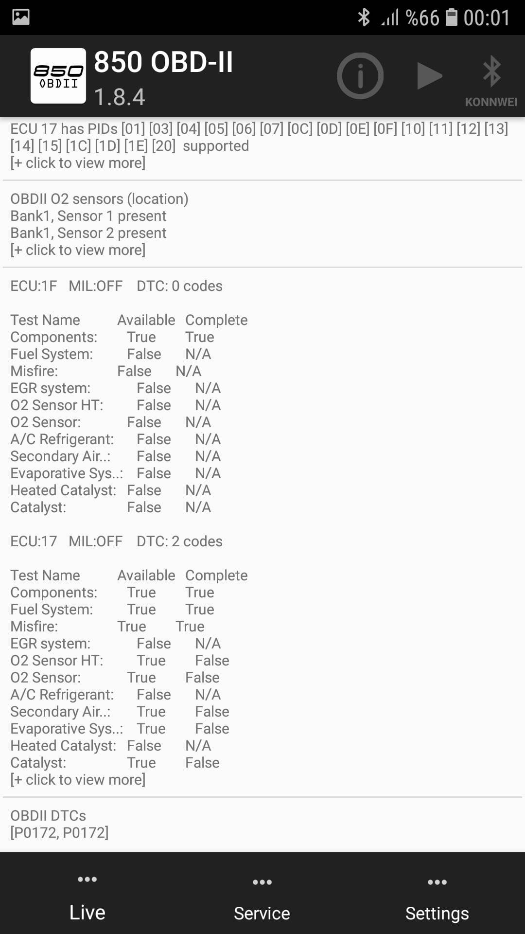

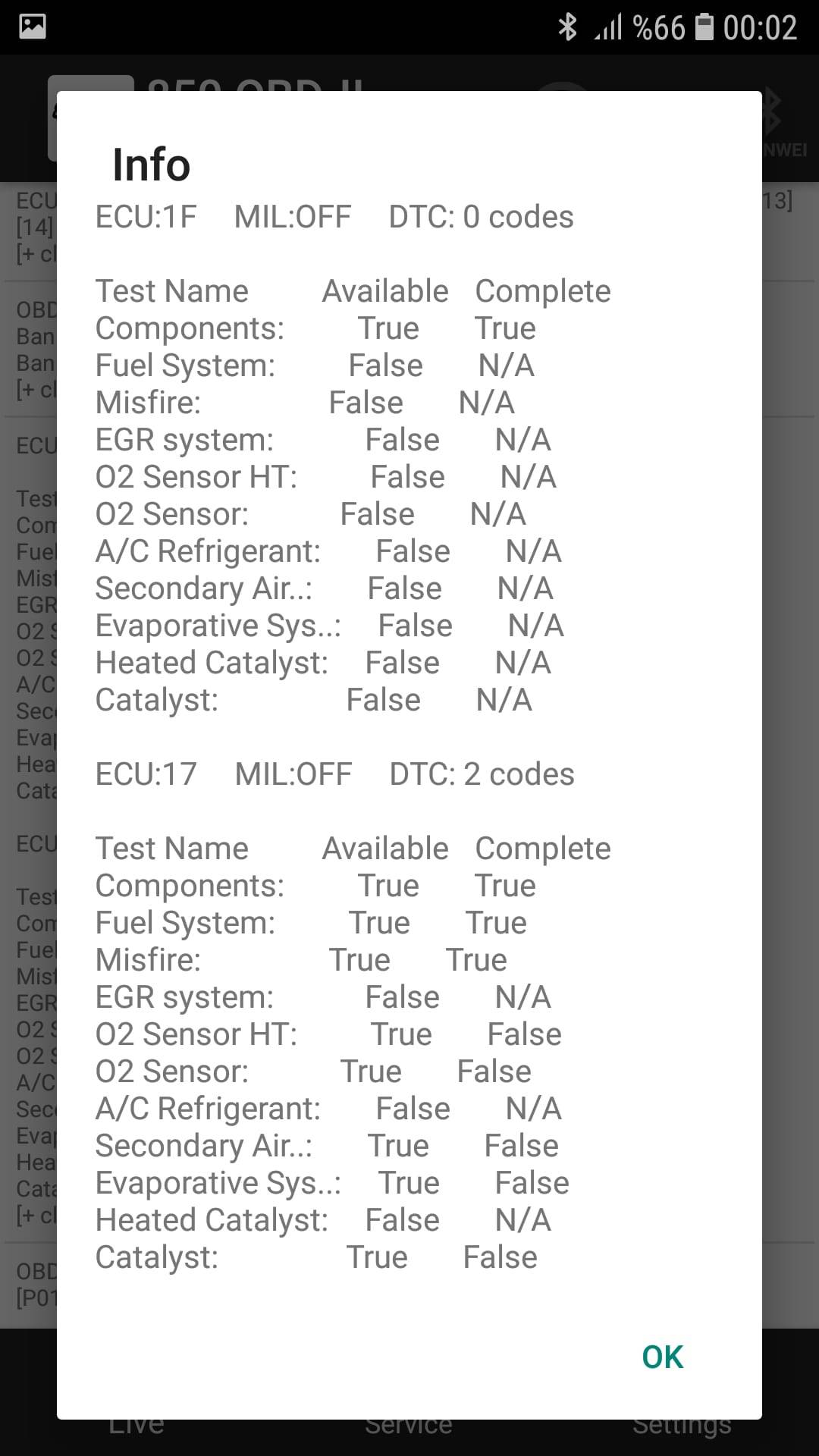

The bottom of 3rd image shows your 2 OBDII DTCs (that are causing the CEL / MIL light to come on) are both P0172.
Other forum members can help you with diagnosing possible sources of the P0172.

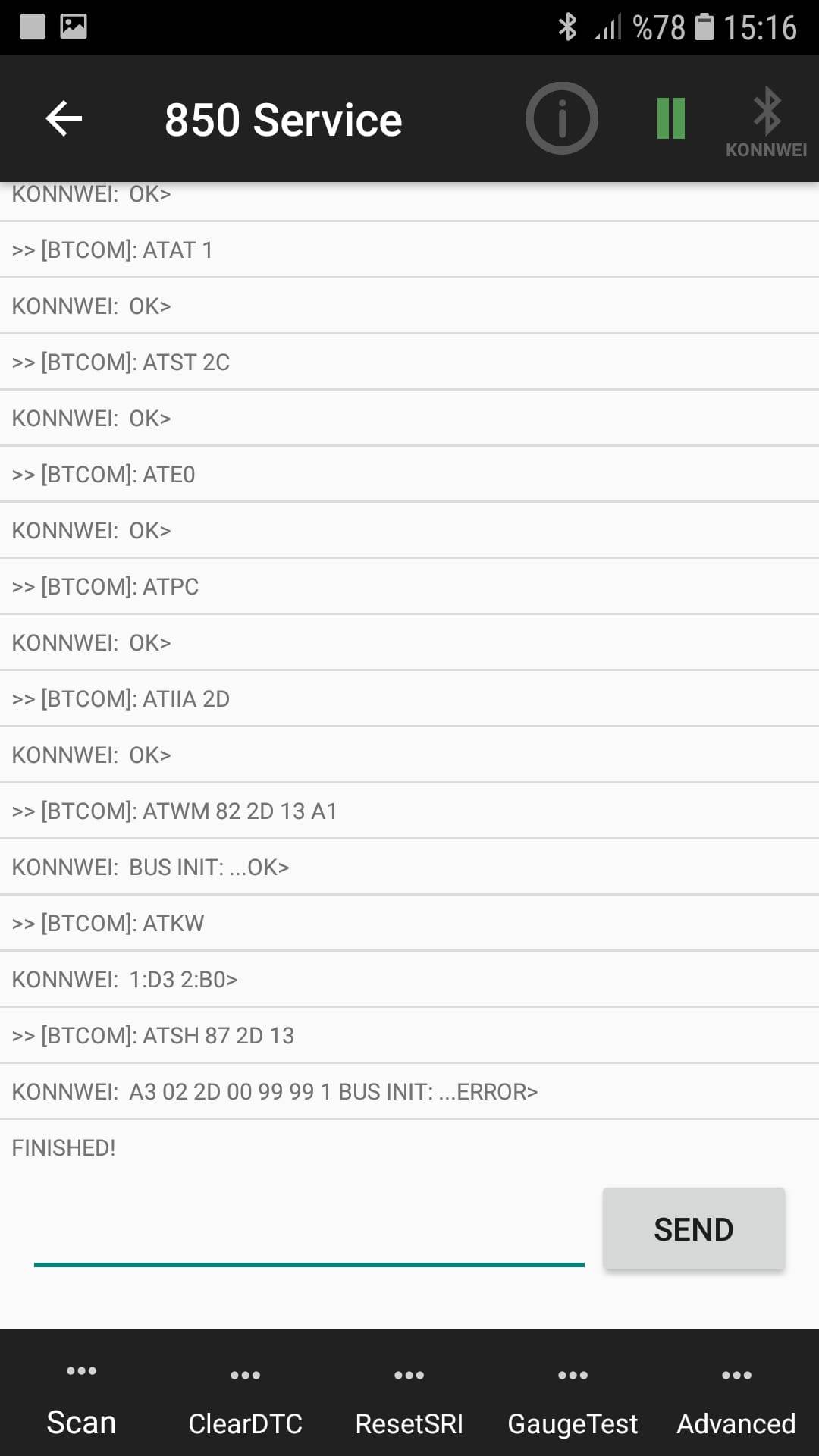

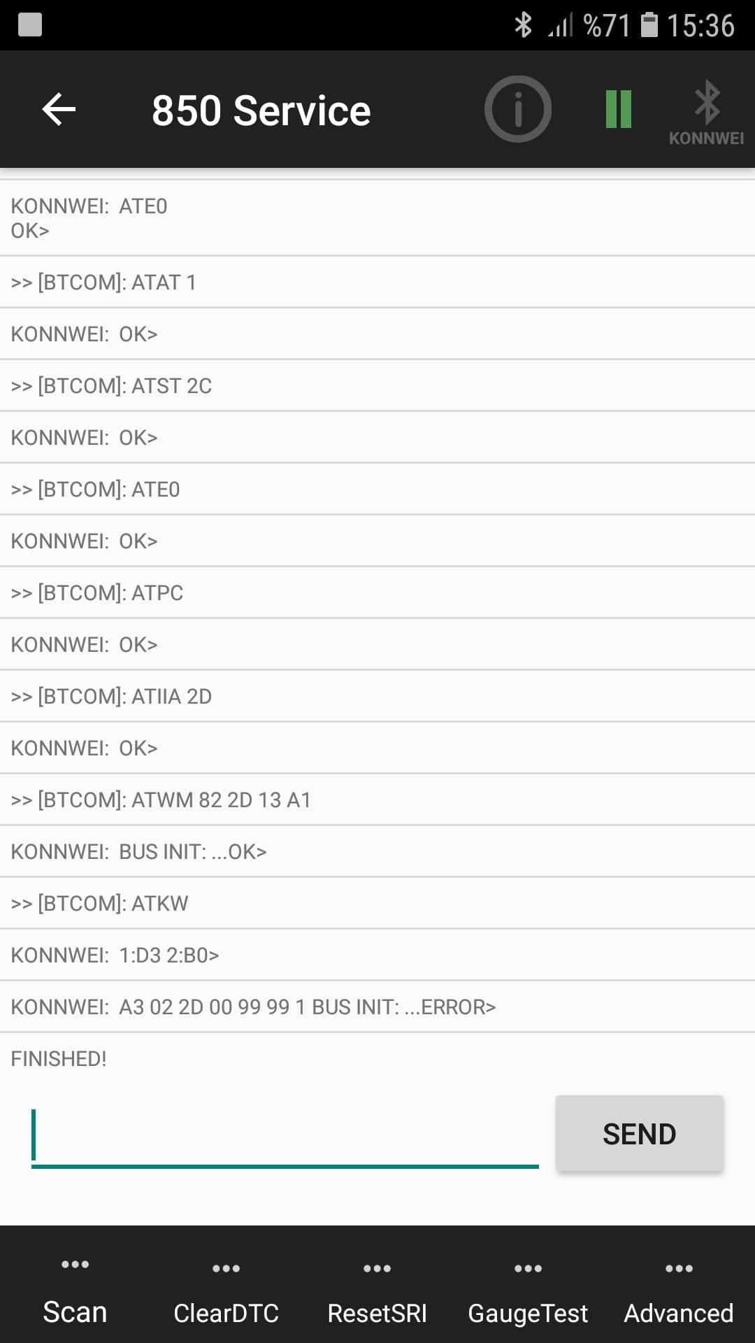

Thank you for your answer, I know the error code. Since I have LPG in my vehicle, it sometimes shows a rich mixture. I could clear it with all OBD programs before.esl_97_850_T5 wrote: 26 Jul 2024, 04:38 The bottom of 3rd image shows your 2 OBDII DTCs (that are causing the CEL / MIL light to come on) are both P0172.

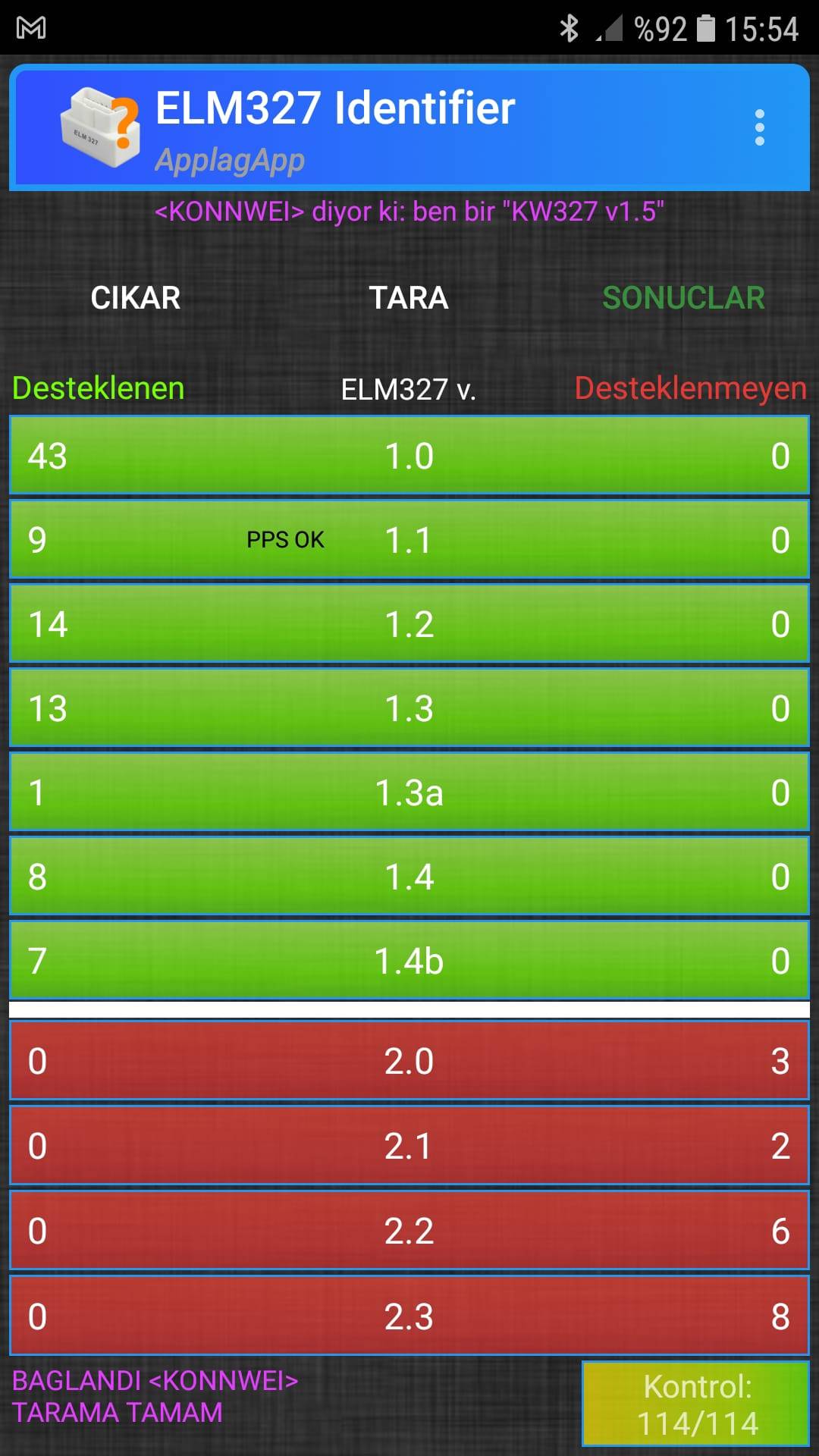

Today, I connected a KKL cable via OTG and tried it, it connects but it stays at 0% and does not progress, the same cable works properly in vol-fcr.
In short, I couldn't get any results from the program or the ELM device I bought.
