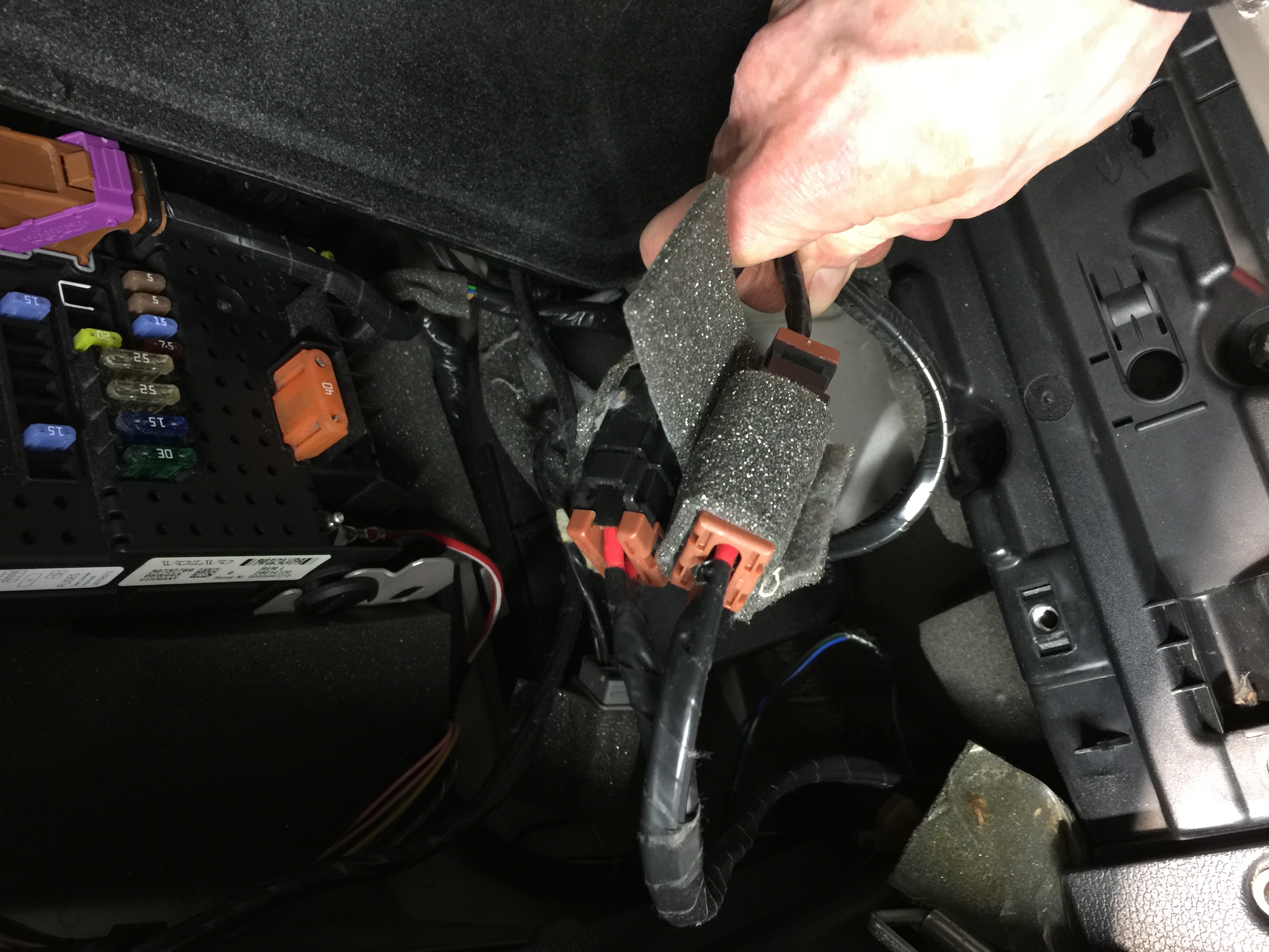

So what I saw in the 2006 were these pair of BFC's (Big Fat Connectors). Each had a pair of red 10-ish gauge wire. I think they bring power from the fuse panel beside the battery up to the the CEM, drivers door fuse panel, and under-hood fuse panels. The pic shows their location in my 2006, right under the REM.
Now, I don't know if these are in the 2001 V70, but if they are, they'd be the prime suspect. I'd want to unplug, inspect, clean and reconnect them. Seems to me that an intermittent connection here could well be the cause of what I was seeing.
All's well that ends well - the 2006 XC70 is a super nice replacement for the 2001...

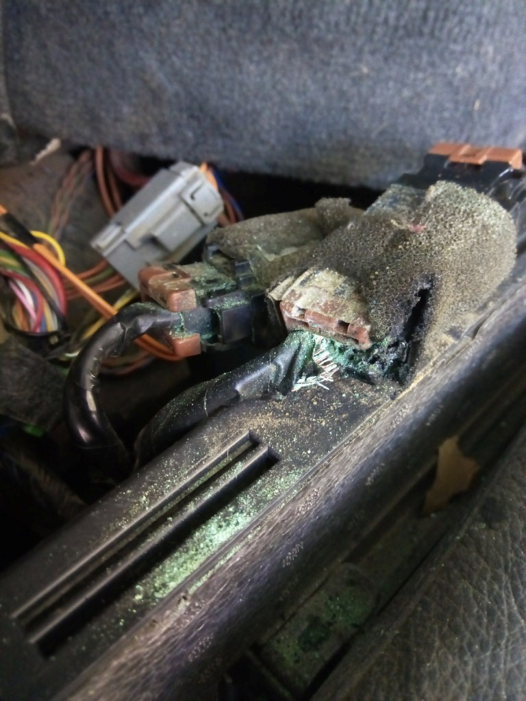

precopster wrote: 06 Nov 2017, 17:55 Usually no. Canbus is a protocol not a physical item you can touch. There are many test points to use.
This year I repaired an XC90 2007 with suspected Canbus issue. Door locks, climate control and another circuit I can't remember were down however were down permanently unlike yours.
It ended up being a corroded main power cable where it meets a connector in the left lower corner near the REM. There were just a few strands of copper still carrying voltage to the above modules. Testing with a meter showed voltage at all fuses however using a load (21W test lamp) showed otherwise.

I may have mentioned those too, but I might be thinking of another thread. Yes one of those two big plugs are the two red wires that go to and power the CEM and anything that is controlled by relays on the CEM, except either the high or low beams where +B power originates from the underhood fuse panel/main battery cable and loops through a relay on the cem then back out to the headlamps. Yes I'm fairly certain an '01 has those in a nearly identical power distribution layout to my '06. The second connector/set of wires feeds a group of fuses on the interior fuse panel for most of the interior electronics/power seats etc that don't get their main power through the CEM.

The 2007 XC90 I repaired had a history of a small rear fender bender where the rear left tail light was replaced. As is usual with panel shops they strip them down for quote and inspection, then leave them sitting in the yard until the parts/insurance approval arrive or perhaps they had already done the bodywork and were waiting for the rear light to arrive; which left a gaping hole in the rear left side.
It obviously rained or was carelessly washed while it was waiting. The corrosion would have been very slight at the beginning and it took about 2 years to eat through the copper one strand at at a time. There were 3 or 4 corroded strands still carrying voltage but could not carry enough current to power up the modules. I stripped them back and joined the wires together with heavy red cable then soldered them all together. Then sealed them with tape.
