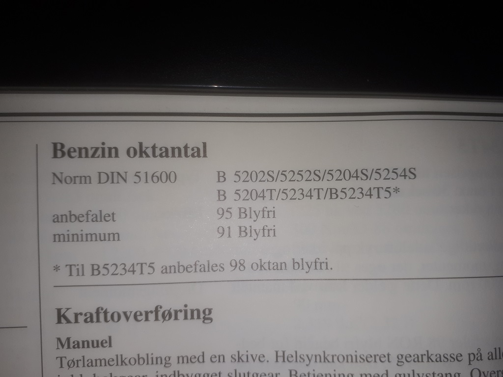

Minimum yes.abscate wrote: 26 Feb 2018, 05:06 Volvo says minimum 87 octane for my 1999 ( or 91 in EU)
We can't afford expensive gas Teddy, it's up to almost 0.5 Euro per liter
Though it's in Danish and I know it's for the 850, it says unleaded octane 95 (EU spec premium) is recommended.
It was the same for the '99 S70 I had.
Even worse is the T5, recommended 98

The octane ratings aren't the same though. So 98 in Europe is closer to 93-94 in the US IIRC.
95 is euro spec regular btw, not premium. I've never seen lower that I can recall. 98 is premium.
