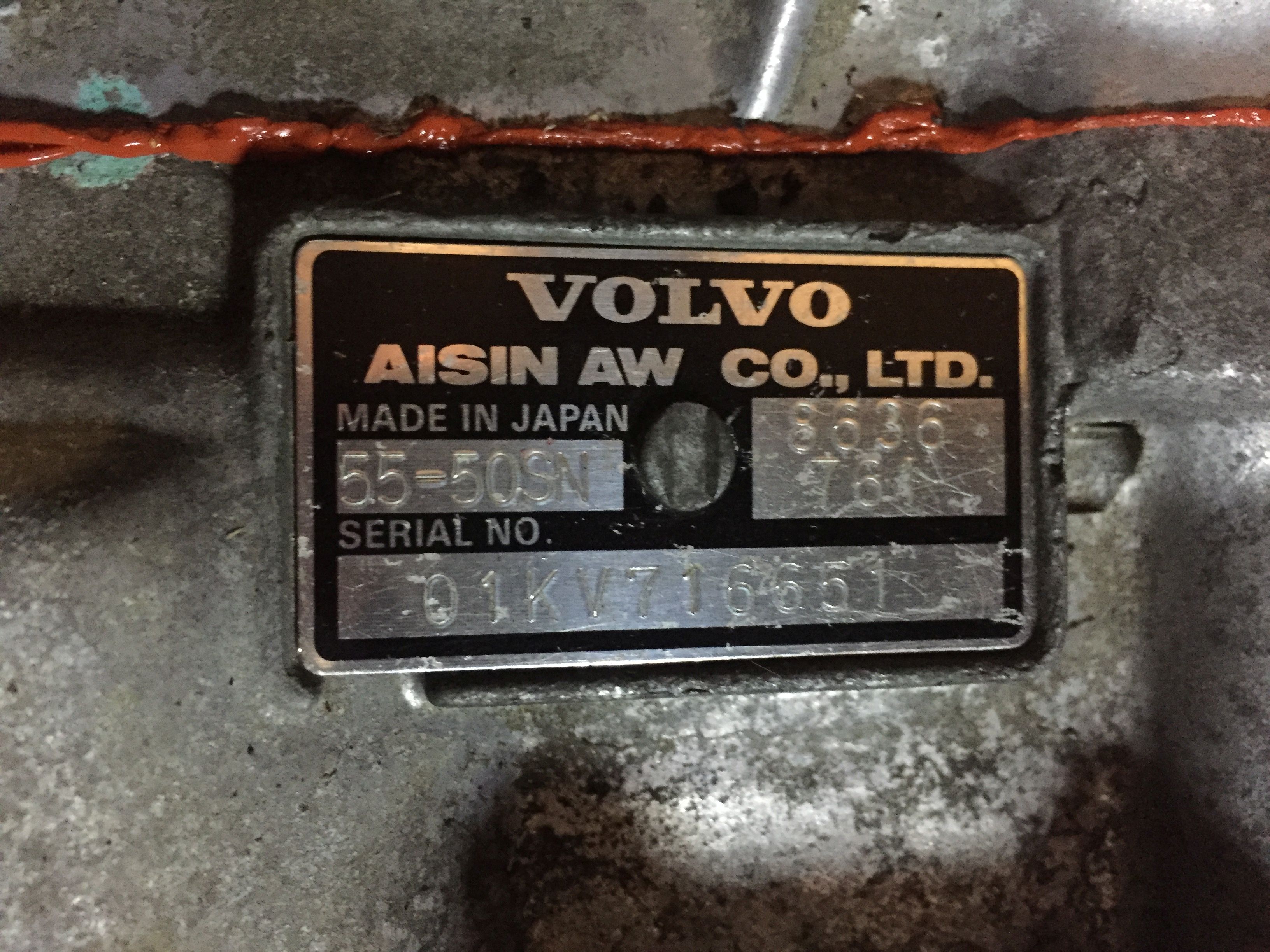

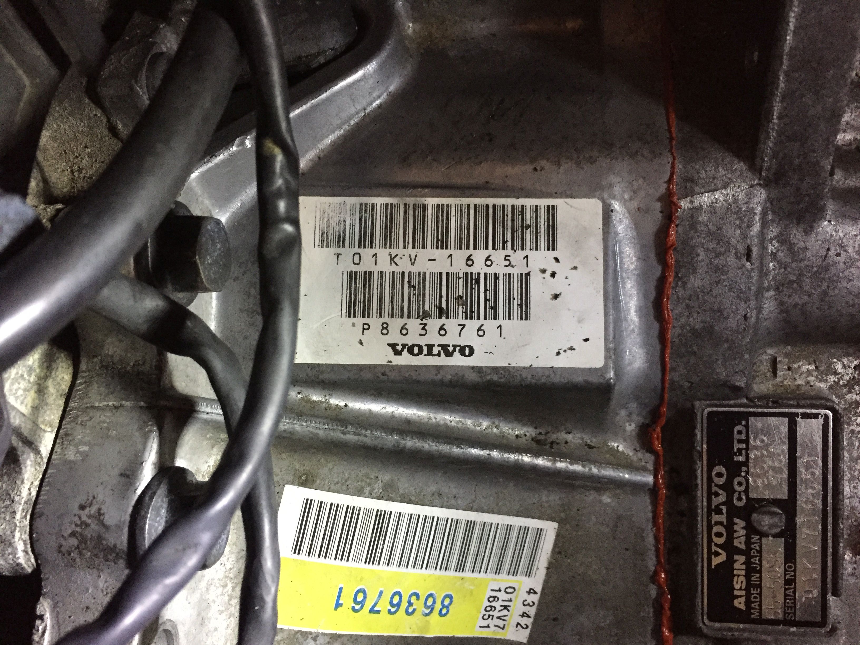

The transmission doesn't need to necessarily come from a T5, or even a V70 or even a GearTronic. anything with this Volvo P/N 8636761 (ask them for a picture of this plate) will be a direct fit. These are from my 2001 V70 T5 with GearTronic. The transmission is from a 2002 S60 non-turbo.VolvoLvr wrote: 06 May 2018, 11:35 I think the person that posted just above (PDXSVT) asked a very important question if a swap is done. I get that another AW55-50SN transmission with Geartonic from a 2001 or 2002 V70 T5 would fit and I spent hours this week checking for who might have one. The couple I found were quite expensive (>$1,000) and was told by ErieVovo that they're rare. For clarity, I’m wanting to follow PDXSVT's question up with can an AW55-50SN without Geartonic from a Volvo OR one that doesn’t come from a turbo work as well?

I have a 2001 Volvo V70 T5 with Geartronic. I do not know whether the donor 2002 S60 non-Turbo had Geartronic or not.VolvoLvr wrote: 20 May 2018, 21:30 01_Nautic_V70 - Thanks for your reply. But I'm confused, and hope you can help clear something up . . . Your 2001 V70 T5 had Geartronic and was/is a turbo. I get that. But I'm not clear whether the 2002 S60 transmission you put in it has Geartonic or if your car is now functioning without it . . . Also, the tag on my 2001 V70 Tv says "AW55-50 SN with the numbers 8636763 rather than 8636761. Are the photos you posted of the transmission from the 2002 S60?
I do know that I have it on mine and it functions just fine, though I rarely mess with it. It is my understanding the transmission itself is the same. The Geartronic mode keeps the transmission in Drive and the +/- commands are just fed to the Transmission Control Module (TCM) to command gear changes electronically through the solenoids on the valve body. If you look at a AW55-50SN transmission, there are only P, R, N and D positions on the mechanical linkage. Any other commands to it are electronic.
I'm now extra confused because I've gone back and looked at my old transmission and it has a 9480902 part number. Hmmm, the plot thickens.
Here's what I know for sure, the 8636761 works in my car and the GearTronic works fine. No codes thrown by the computer. I suspect the 8636763 would work as well. I have no idea why they had multiple part numbers.

Nautic - interesting findings. I would guess the only differences in those part numbers is that they have different valve bodies from the factory hence a different part number. As been discussed the different valve bodies work in various transmissions and that is why yours is working. The transmission computer are the brains of the system telling the solenoids what and when to act and these solenoids are in the valve body (which can take flavors no letter, A, B, C and D).
