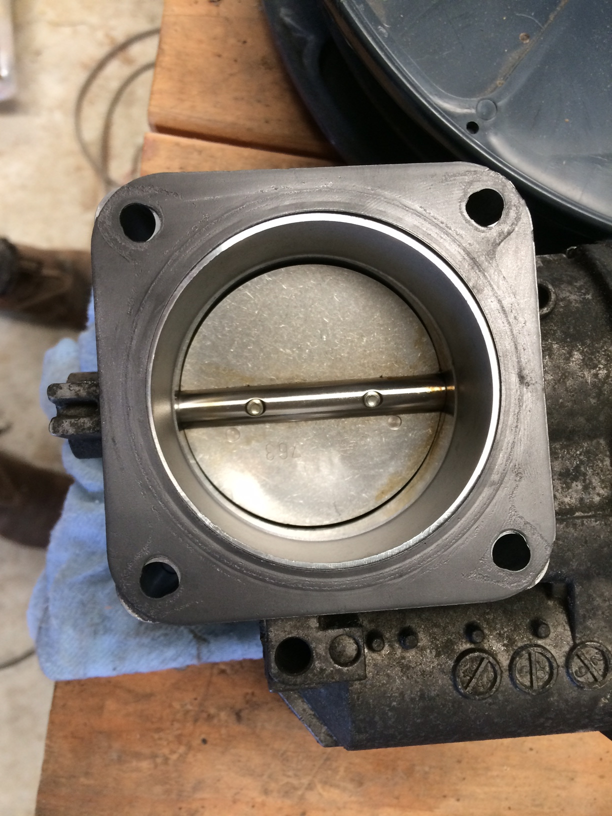

Ok, so I was hoping the throttle body would be filthy, thereby easily explaining my erratic throttle behaviour. Nope.
Also cleaned the MAF, put it all back together and we’ll see where we go from here.
