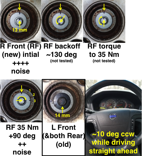

While "practicing" I discovered that the axle bolt is incorrectly torqued (see below). As expected, torquing to 35 Nm didn't tighten the bolt further. Unexpectedly, backing off ~130 degrees followed by torquing to 35 Nm returned the bolt to the initial position - exactly. Torquing further to spec (35 Nm plus 90 degrees) decreased but did not eliminate the noise.
In October 2018 one axle was replaced (non-Volvo indie) due to a faulty abs ring. The invoice specifies left axle (no part number) and I didn't remember differently. However, I the right front axle bolt is "new and shiny" and 13 mm The other three are "old and weathered" and 14 mm. It seems clear that the right axle was replaced (the invoice is wrong) and torqued only to 35 Nm but not to plus 90 degrees as specified. I can't document the torque data because I didn't video myself but .... A noise similar to the current noise began a few months after this axle replacement. I remember thinking it odd that a noise from the right front suspension occurred soon after work on the left front axle. I chalked it up to bad luck. The noise disappeared and I didn't pursue it then because it wasn't there. I suspect that was a mistake.
Is it possible that the under-torqued axle bolt led (eventually) to everything else - loose axle/bearing > stress on other suspension components > broken coli spring and noise from worsening axle/bearing? It seems the spline fittings on both the axle and the bearing may be worn requiring replacement of both. How can I evaluate this, or should I? Disassemble and inspect?
And just for fun I realized the steering wheel turns ~ 10 degrees counterclockwise when the car drives straight ahead. I know it needs alignment after all it's been through but is this related in a causal way to the other issues? Or a consequence?
Any chance the shop that incorrectly torqued the axle bolt over a year ago will (or even should) repair anything or everything? (I already replaced the broken spring.) Now that you've stopped laughing please make any suggestions that come to mind. Never ignore a noise, even one that's not there, is one thing, of course, but sometimes difficult to follow.

- Under-torqued right front axle bolt
- 2019-12-14_xc70RfAxleBolt_crop.png (348.64 KiB) Viewed 947 times

- Bearing noise: jack up the suspect wheel and spin it. If bad bearing, it will be obvious.
- As mentioned previously: Quick Struts and move on, easy job.
- Alignment: look for the alignment DIY I posted in forum.
- Axle bolt: I re-used it all the time, 35 Nm + 90 degrees. I usually clean the axle threads really well bc it has grease on them (the hole is hollow and connects to the CV Joint area. Then a bit of Loctite on the axle bolt to prevent it from coming loose.
