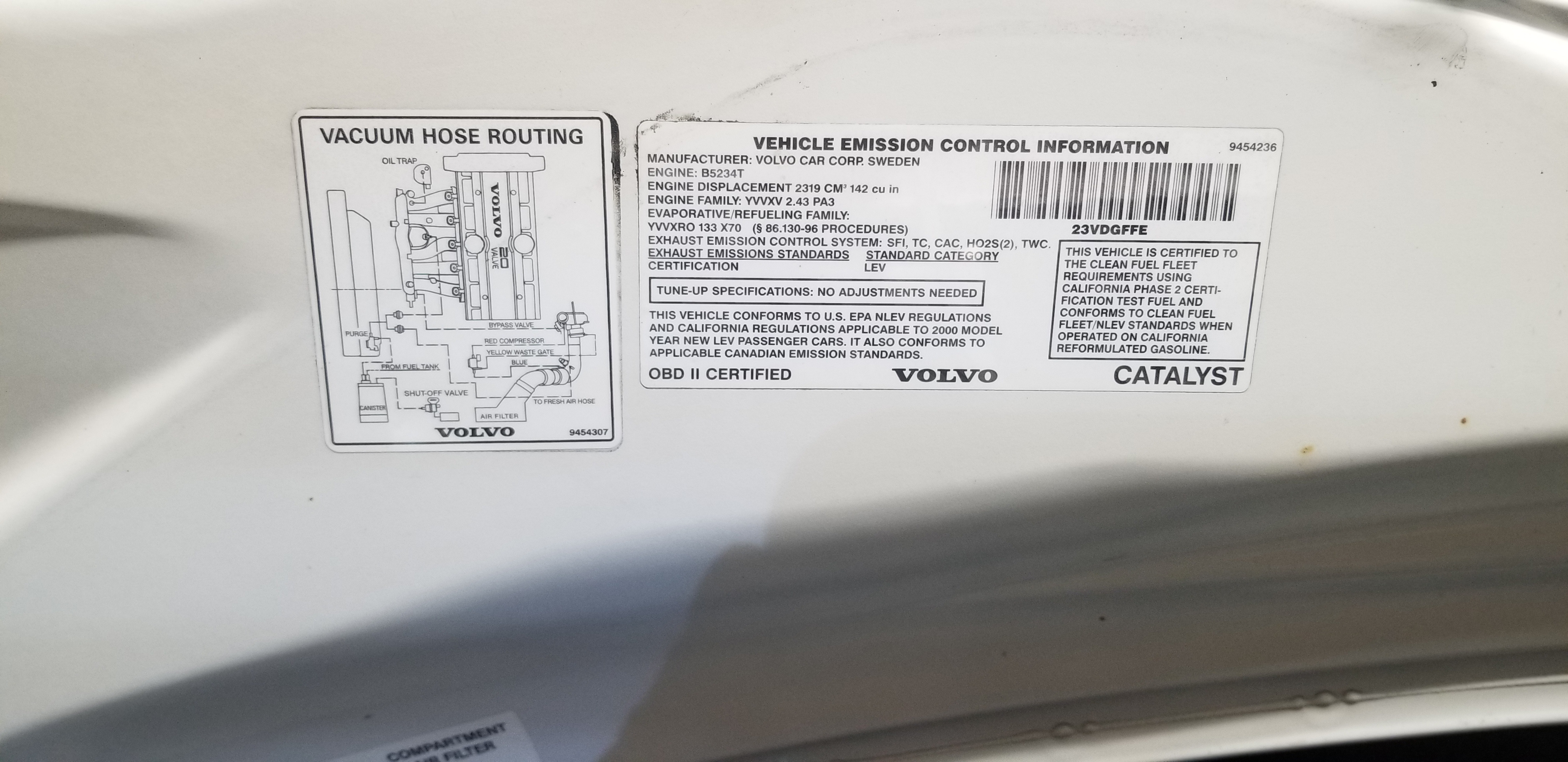

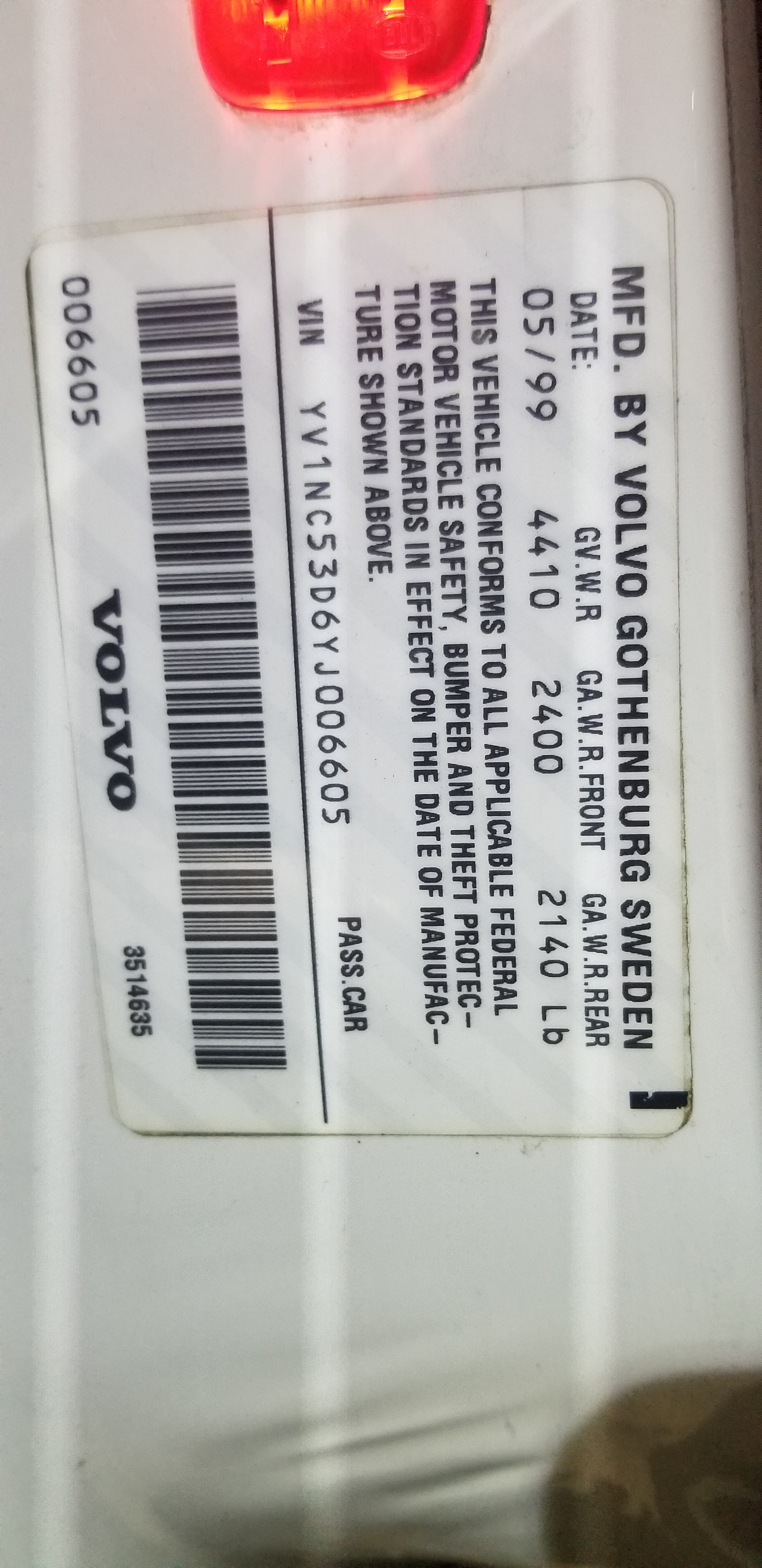

A may 1999 build would be a 1999 model year. The new model starts in September
Can you post up your door jamb sticker and emissions sticker? Be interested to see for what year emissions it is certified

abscate wrote: 23 Dec 2021, 20:36 A may 1999 build would be a 1999 model year. The new model starts in September
Yeah sure , no problem.

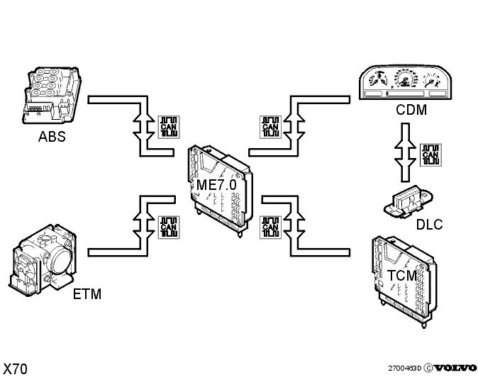

abscate wrote: 24 Dec 2021, 01:55 I’ll look for info on CDM 000D
CDM (Can and Driver Information Module) AKA DIM. CDM-000D = DIM-000D.
If you look at his screenshot there are no control modules labeled CDM. It is probably a clerical error in the VIDA database.
The CDM/DIM on the 2000 C70 also serves as the CEM.
Its is a communication problem with the ECM. Pull the ECM and clean the connectors before you throw big money at it. Do the same for the connectors to the DIM also. Inspect for defects on the PCBs as you go. Check CAN buses for shorts.
Could be a module interfering with the CAN communication. Pulling the fuse resets it. What is on Fuse #15?
ME7 Network Communications.
DIM-000D Communication engine control module (ECM). Faulty signal. Permanent fault

I’m thinking you need a CANBUS sniffer or get someone with that tool to look at the traffic on the signals between DIM and ECU
