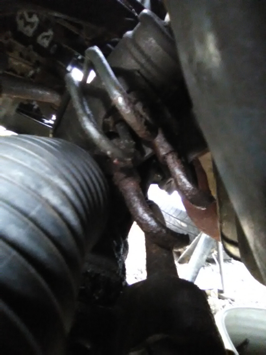

I don't remember the power steering lines being so difficult to remove, but I was able to cut them between the rack and front part of the subframe before the lines turn up to the pump/reservoir. I used a pair of bolt cutters, vice grips, and a hack saw. The vice grips were helpful in moving each line back and forth until the cut parts became separated. Closer to the rack I had to use a hack saw! Now it's the connections at each end of a line to loosen.
The stuck 13mm open end wrench finally came looose after I applied some heat to the bolt head and put an enormous amount of pressure to the stuck part of the wrench with a pry bar! Stuck the end of the pry bar underneath the stuck part and just kept pushing up until the wrench popped off!! Was then able to remove the bolt to the "beaver tail", but now the tail won't come out so I can get to the bottom part of the mount still bolted to the rack. I have tried raising and lowering the subframe and/or motor, all to no avail. There is almost enough room to slide it out behind the rack, but the O2 sensor is in the way. The arm attachment to the mount from the motor gets in the way when I try to slide it out in front of the rack! I think I might have to either remove the control arm bolts/nuts or undo the bolt(s) at the column holding up the steering rack. Just not sure which to try first! I need another half inch to an inch for the tail to clear the part of the rack where the mount is attached.

A pic of the power steering lines at the rack, almost ready to be removed (waiting for pb blaster to work!).

That is nasty!
