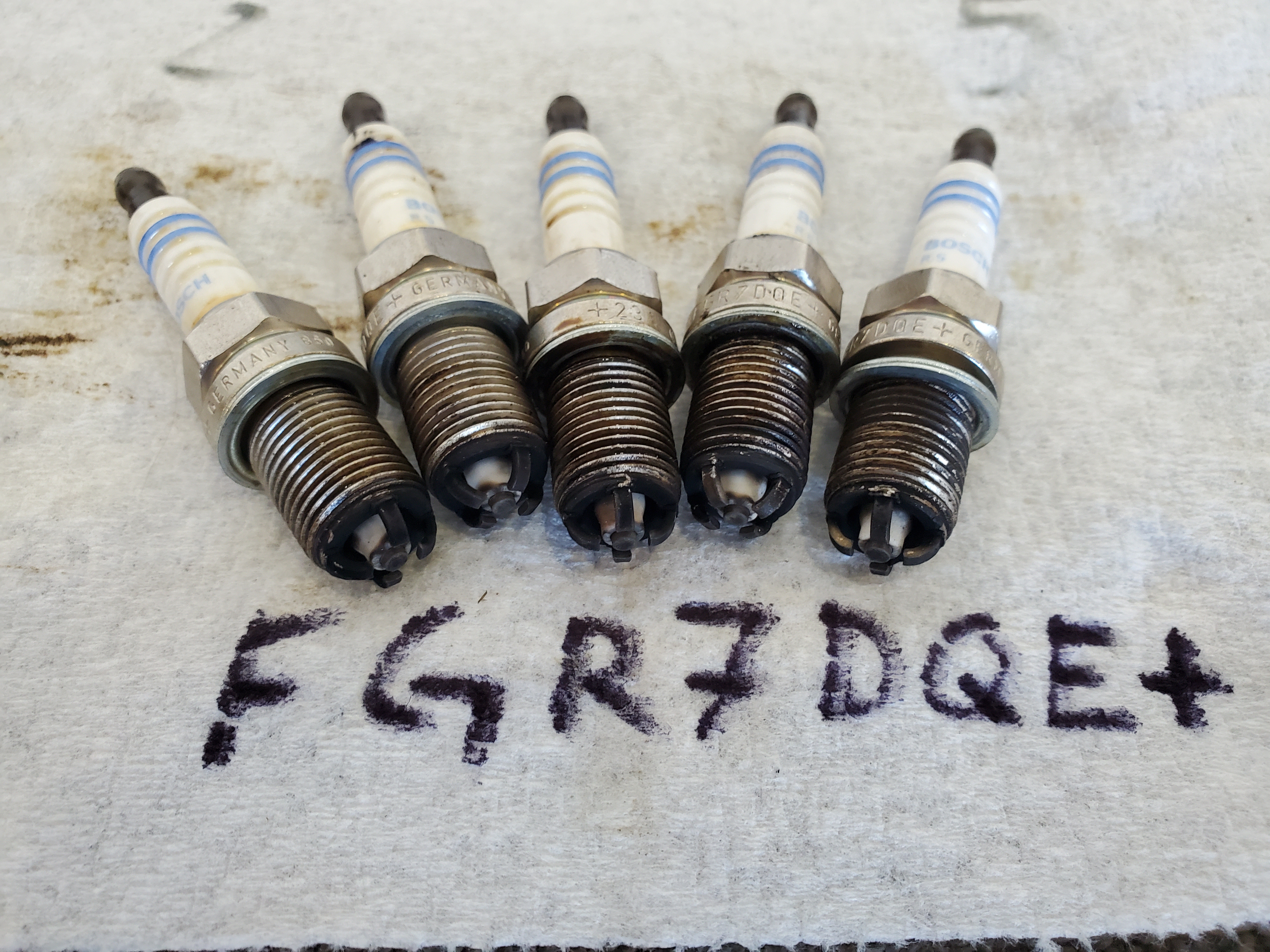

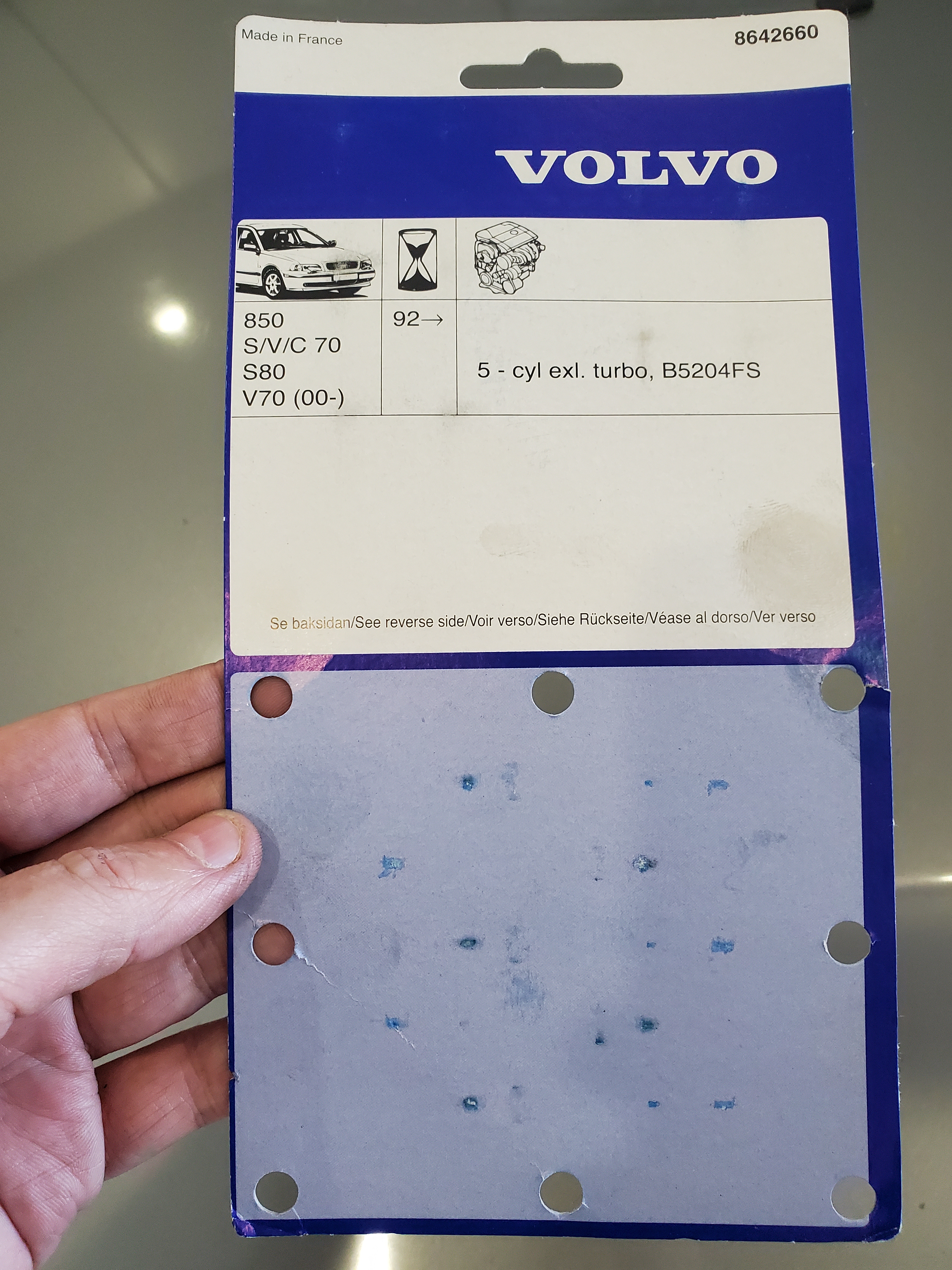

The new Bosch plugs I put in lasted 5K miles☹ Recently I noticed that rpms would drop at idle randomly, but always when warm. It was also missing on hard acceleration. No codes at all. I thought it might be a valve body problem, line pressure etc. But nope, just new CORRECT OEM plugs was enough to get her back running smooth again. 300K coming up soon

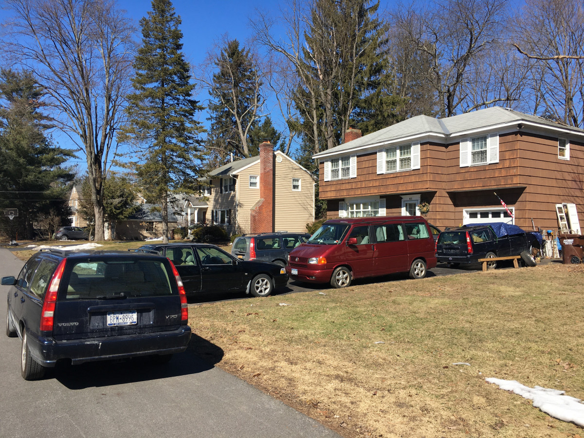

Went for a walk because I couldn’t decide which Volvo to drive

I like the red one.
