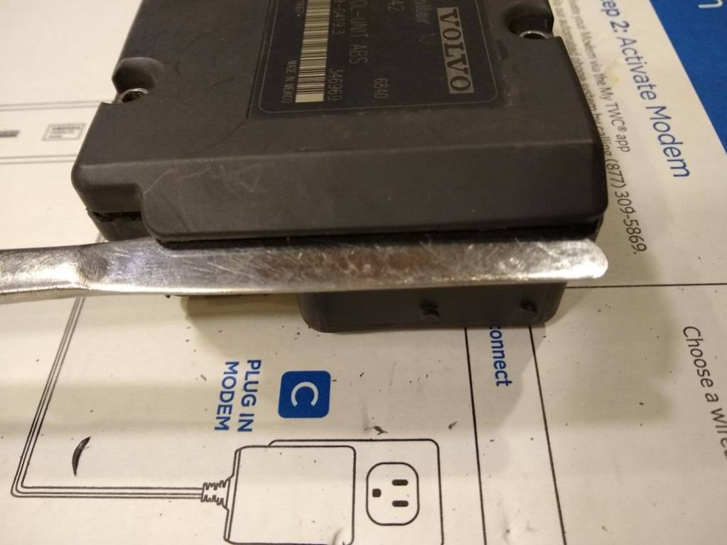

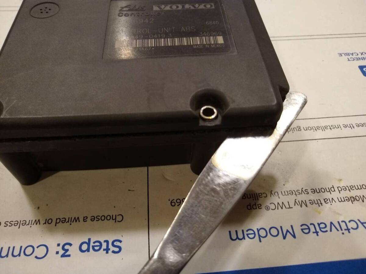

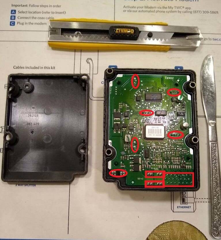

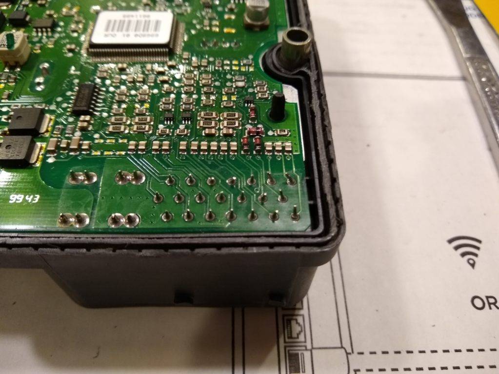

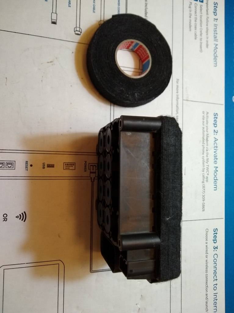

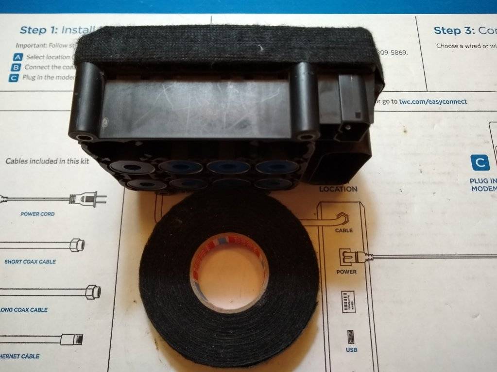

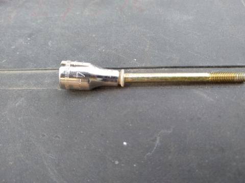

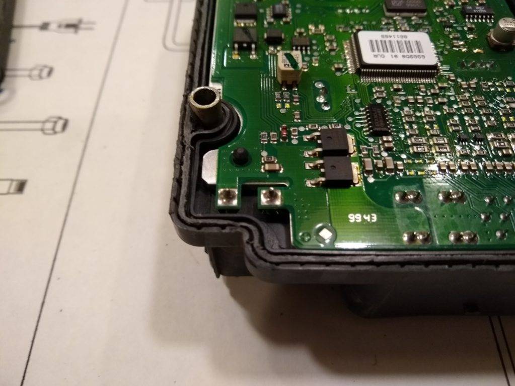

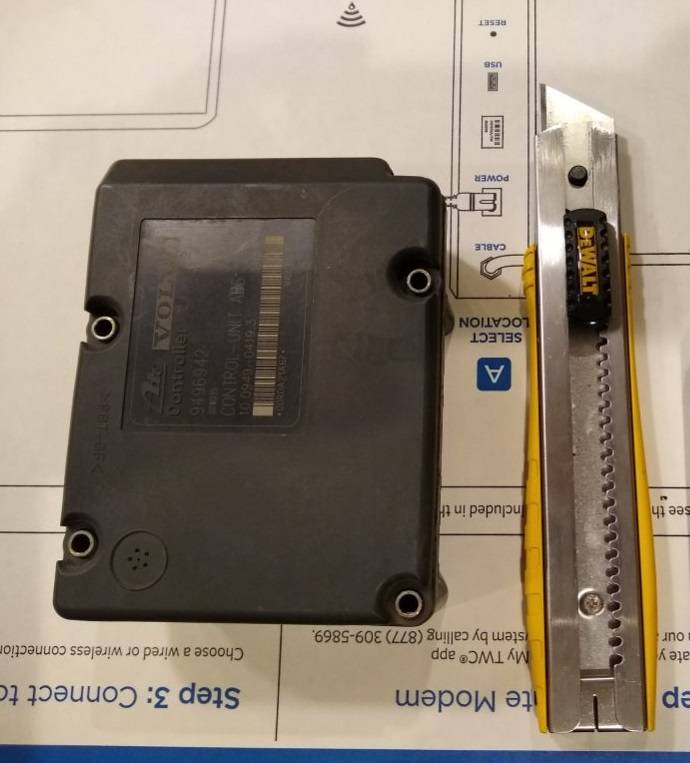

4mm socket is a snug fit but need to keep it straight on top.
Reworked the solder on every pin (counted 57) that came through the board. About 1/5 or 1/4 looked like a potential cold joint or broken solder.

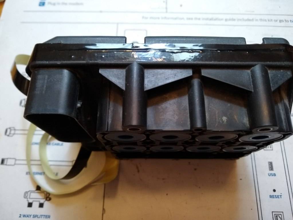

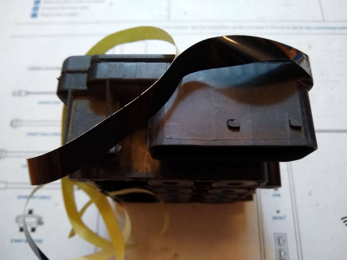

Temp sealed it and initial testing shows the codes clearing by itself. Will seal with high temp silicone after some miles.
Didn't take long to slice the cover off. Keep the blade short and hands steady and slowly cut the seam over and over. Recommend wearing some thick leather gloves, standing the seam vertical and cutting downward.
