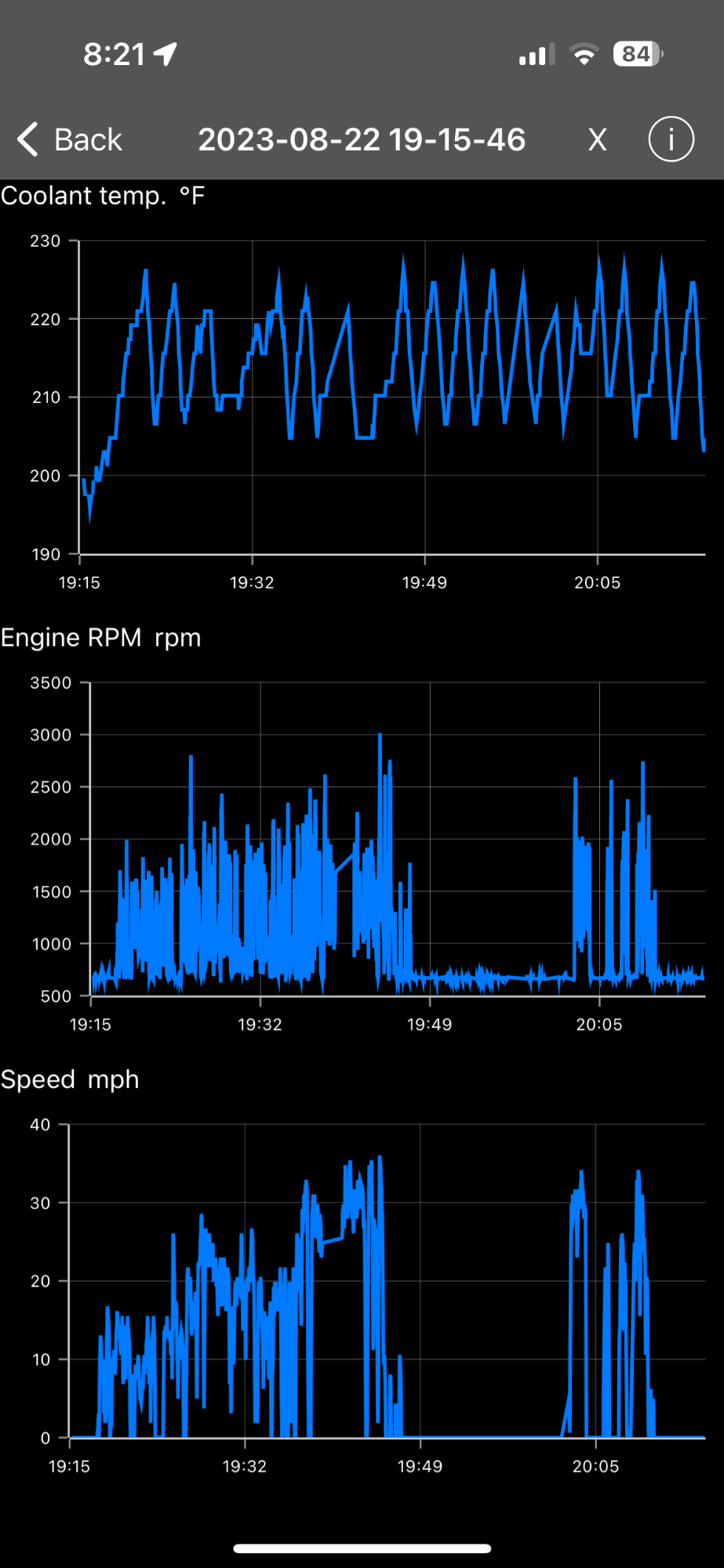

First, here's a graph of speed, rpm, and ECT from my first trip out. The ECT seems to be more stable than I had experienced before repairing the signal wire.

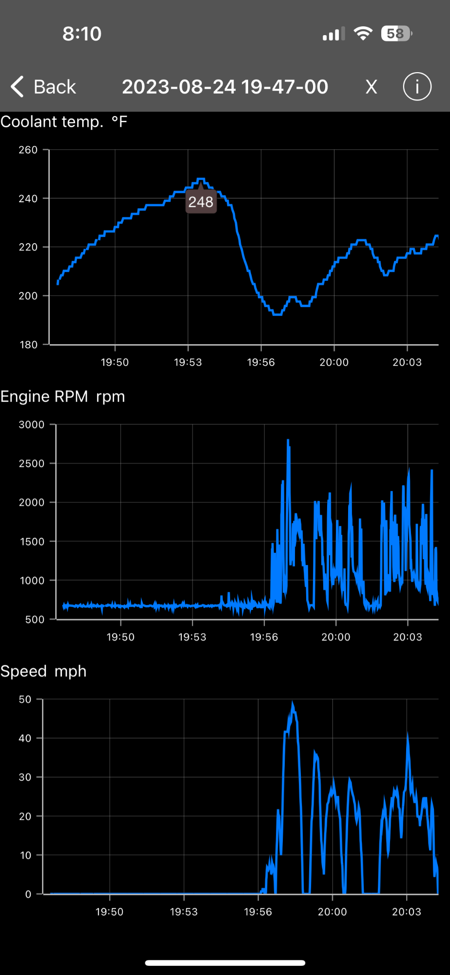

However, on a later trip out, I got this result:
The ECT kept climbing while I was idling and it didn't come on when I would have expected around 225-230F. It actually got up as high as 248F, at which point I turned on the heater and vented the heat inside. You can see it came down pretty well after that. I shut the heater off when the temp got down under 200F. But the ECT it didn't settle into a more regular cycle, and then started climbing back up.
So I'm still not sure that the fan is coming on every time when it should, despite having rewired the fan signal connector. Is it possible that the fan, fan controller, or fan relay is failing? What would be the diagnostic approach for figuring that out?

The fan definitely *does* come on most of the time at expected temperature of 225-229F, and shuts itself off at 210F - I have witnessed it. But it also occasionally seems to *not* come on when the temps are in the higher range (230-240F), typically in situations where I can't get out of the car to look at it. This is my assumption anyway, based on the fact that the temperature does not start cooling down when I expect it to, having not been able to observe the fan directly in these cases.
For reading at the signal wire connector, would I just disconnect it and check for the voltage on the end coming from the wire harness? And then wait for the ECT to reach a temp where the fan should kick in and verify the voltage?
When you mention testing at the distribution box are you talking about the ECU or the fuse box?
Regarding the relay, I'm a bit confused at what I'm seeing online - some people mention the relay being built into the fan control module (and thus can only be replaced as part of a replacement of the fan control module), other people say it's on the underside of the fuse box, not sure if those are two different things.

your experiences with no fan at high temps are not verified. The high temp reading might be wrong, I'd verify with infra red gun on the thermostat housing. Sometimes its just worry. Especially suspect numbers if you get a reading near 250 but the temp gauge on the dash is still in the normal range. Something doesn't add up.
I'll check for voltage on my signal wire, its 3 am right now.

Not my personal observation, but I have been told that the temp gauge is strongly vertical up to at least 128c his 250f is only 121c. This is intentional by Volvo.jonesg wrote: 28 Aug 2023, 00:59 distribution box, located behind airbox, contains fuses and relays, the signal wire passes through on its journey to the fan.

when my fan was dead I watched the gauge climb at idle into the hot zone, as soon as I started moving it dropped down again.
i presume if the needle is still vertical its still ok to run.

When the temperature got up to 248F, the temperature gauge actually moved one full tick mark past vertical, which is the most I have ever seen it move past vertical.dikidera wrote: 28 Aug 2023, 04:19Not my personal observation, but I have been told that the temp gauge is strongly vertical up to at least 128c his 250f is only 121c. This is intentional by Volvo.jonesg wrote: 28 Aug 2023, 00:59 distribution box, located behind airbox, contains fuses and relays, the signal wire passes through on its journey to the fan.
