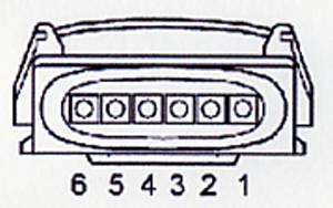

Sometimes the Mass Airflow Meter (MAF) can do with a clean. It is, in theory, self cleaning but occasionally it benefits from a squirt of MAF cleaner which you should be able to buy at any good parts shop for a modest sum of money.
To test the MAF you need to get out your multimeter.
1. Ignition 'Off' and disconnect the connector from the MAF. You will see this: 2. Set multimeter (MM) to ohms and connect between socket 1 and earth (ground). It should read 0 ohms.
3. Ignition 'On'. Set MM to volts and connect between 5 and earth. It should read battery voltage.
4. Ignition 'Off'. Connect the connector to the MAF. Ignition 'On'. Back probe into 3 and earth. Voltage should read 1.4 volts.
If any of the readings are incorrect check for bad wiring and oxidation.
The oxygen sensor resistance is measured by connecting the ohmmeter between the sensor harness terminal #2 (black wire) and earth. This is located next to the bulkhead (firewall). A cold oxygen sensor should read 2 - 3 ohms. A sensor that is warmer than 660F (350C) should read 7 - 14 ohms.
I would spray the MAF first as it has 'repaired' many cars in the past. If you still have the problems do the checks.

Thanks Bill.
I'll now have to find a way to the parts place, because last night, she died totally. She'll turn over, but refuse to keep going.
I've been searching for replacement Air flow meters, but the cheapest I can find is in the UK at 60 pounds including shipping.
If I can get her going with doing this, it will solve so much stress it's not funny!

Okay, now I know I'm a moron... I just took my multimeter to try to do tests. Couldn't get a single reading because I had no idea where the earth is. What should I be using for earth? I was presuming number 6, since the others were used for other things, but no luck in getting any readings.
My multimeter has volts, amps and ohms. I tried the ohms section first (obviously, since that's where you asked me to start!) however, there are multiple settings to put it on in each section. The ohms section goes up in steps from 200, 2k, 20k, 20k, 2M - I'm presuming that I'd need to set it on 200, since that's the lowest (and presumable most sensitive) setting? Secondly, I have certain things I never remember, no matter how many times I'm told them... and one of those is which 'wire' I should be using for the pin listed, and which for the ground. I have a red cable, and a black one. I'm presuming red goes into pin 1, and the black goes into the ground??
Any suggestions would be appreciated, since I'm really feeling... well... ultra female right now LOL
Well... that, and I don't really like having to be towed home last night
Poor kids stuck waiting for the towie for quite a while before I managed to secure a ride to get them home to bed!

Earth or ground is any part of the metal frame of the car, preferably with no paint on it. Testing the MAF you are very close to the battery so use the negative post of that. For total safety with a multimeter it is best to start with the higher settings and work down if necessary, especially when testing AC voltage. You will get the same readings on the higher scale but lower down will make it more accurate by dropping it to decimal.
Which wire goes where? Red is positive, black negative. However, using it as an ohmmeter it doesn't matter which you put on what. Using a digital multimeter as a voltmeter if you put the probes to the wrong side you won't hurt the meter, it will simply put a '-' sign in front of the reading. An analogue meter simply moves the needle backwards and gives no reading.
Believe me this isn't 'an ultra female' thing. My son always gets a negative reading first time.

Thanks
The MAF is on the opposite side of the engine bay of the battery, so can't really reach the battery. Having said which, there are multiple metal parts of the car to ground on, so I can do that easily enough
I caught a cab and grabbed some MAF Cleaner from the local auto parts place. Currently it's in the drying out time frame, so I have to wait to see if it works. If not, I'll probably order a new one from eBay in the UK - 60 pounds including shipping compared to the enxt cheapest of 200 USD plus shipping is too big a difference to toss up right now.
