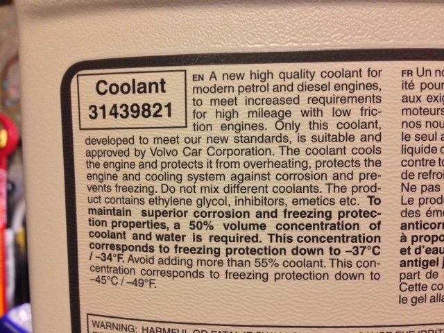

Just bought a gallon of the Volvo coolant -- the new type with part number 31439821.
I thought it might be helpful if I posted up images of the labels so folks can see for themselves the differences between the old and the new.
The only specific ingredient mentioned in the new coolant is 1,2-ethanediol which is a synonym for ethylene glycol (https://en.wikipedia.org/wiki/Ethylene_glycol) .
Front label, new on left and old on right
Back label, new on left and old on right
Top of new label
Top of new label
Bottom of new label
Bottom of new label
Old coolant label (backside)
IMG_4448 coolant.JPG (161.99 KiB) Viewed 2722 times
