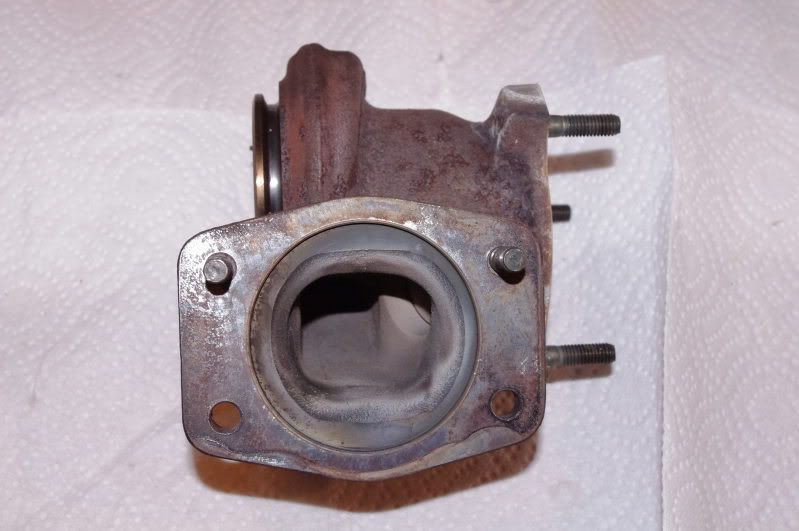

Replaced the turbo oil supply line and associated banjo bolt/washers today. Then as I was putting the new manifold nuts on the wastegate, I realized that I had been turning that one bolt the wrong way, so I was finally able to get the wastegate out. You know what I did next. :mrgreen:
Before
After

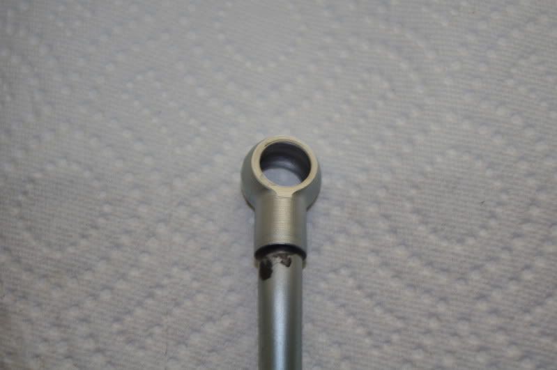

Below are the turbo water feed and drain lines. You want to get all the coolant corrosion out of those banjo fittings. I blasted these last week.
Now I just need a smaller wire brush to get the rust off the coolant rail where the rubber hoses go on. Then I can put the coolant lines back on and start putting the turbo back in.
