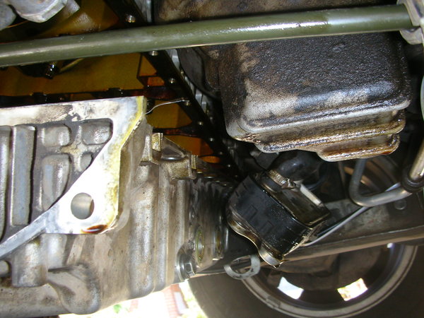

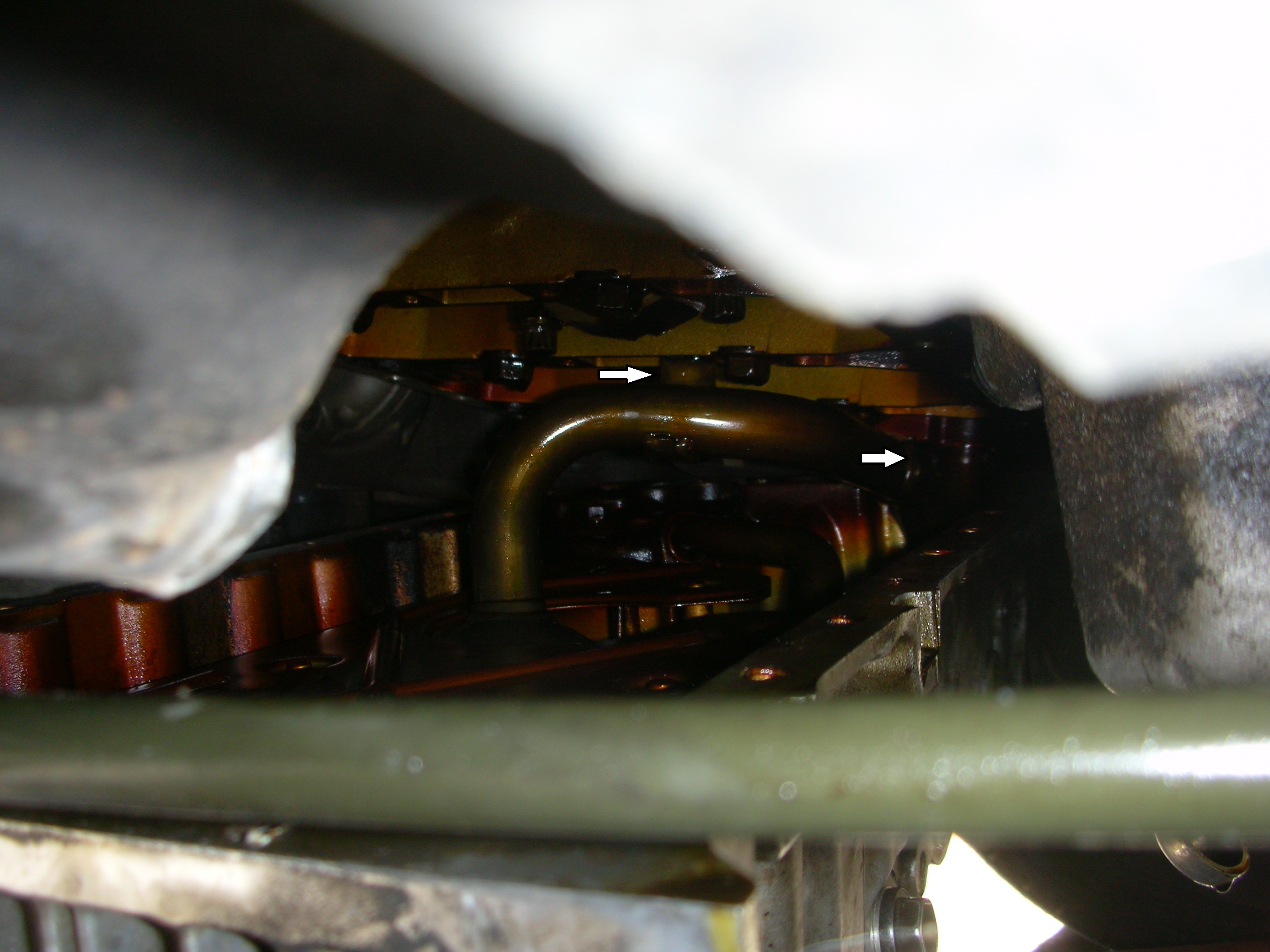

Here are some pics...
It's so close to being free, but "no cigar" just yet. I'm glad I have a lot of time to do this!
I'm not too familiar with where the engine mounts are. I see there is one big one in the center of the front part of the sub-frame. I've tried both with and without jacking the trans, but like I said, it seems to me that it just lift the whole car as opposed to just the engine/trans.

Awesome !!!
Thanks for the pics.
You need to disconnect the mount on the oil pump side and jack up from under the pan. ( put 4 bolts back in - jack it up with wood under pan and put a spacer (wood if possible under the engine mount ) This will give you the last inch and you are out.
You are sooo close
You are sooo close
